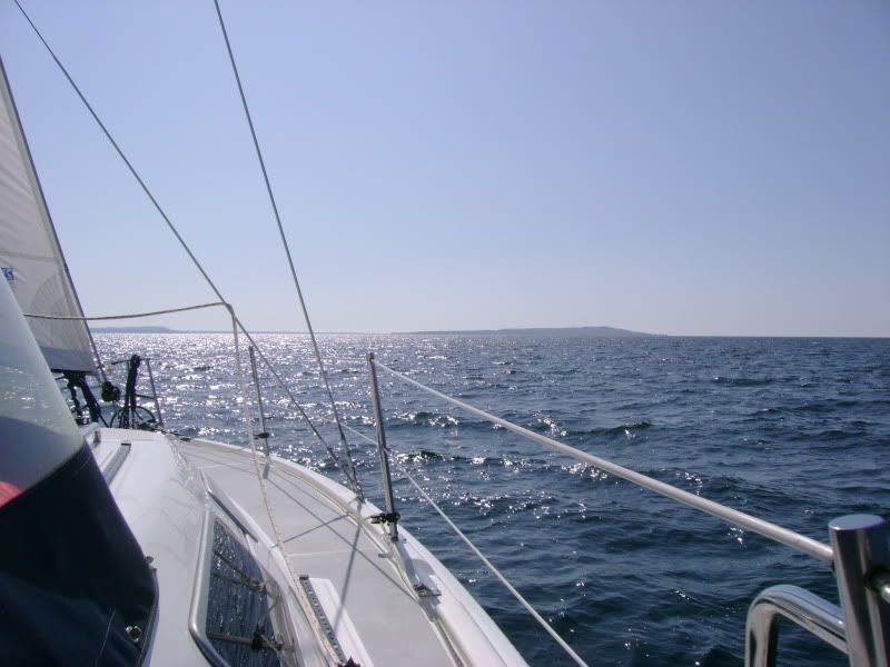

Alan, standard installation on these boats is the tracks on top of the coach roof and winches beside the companionway. Upgrade package includes tracks on the deck and winches back beside the helm. Makes it much easier to tack.
I'm assuming they would put backing plates in as standard, but may want to check with Hunter first or drill test hole as Alan says.
You can see the std. installation on the coach roof and the upgrade on deck
