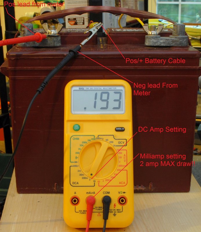

To test for this you simply insert the meter between the positive post of the battery and the positive battery cable. Please only do this with everything turned OFF!!! I can't stress this enough. ALL loads must be turned off including the battery switch before inserting your multimeter.
The fuses in multimeters, for reading milliamp DC current, are usually a 2 amp fuse MAX. Do not blow this fuse or the meter will no longer work. Fixing it will most likely require you to disassemble the meter to change the circuit board mounted fuse.
Once you've connected the positive lead from the multi-meter to the positive battery post, and the negative wire from the meter to the battery cable, set your meter to read milliamps and plug your cables into the appropriate sockets on the meter.
Once you flip on the meter it will either read .000, meaning you have no parasitic load, or a current flow such as the one pictured below.
Please note that I set this up in my garage and used a Sensibulb as my current draw hence the teeny tiny wire I labeled "battery cable". Your battery cable would be considerably larger..
