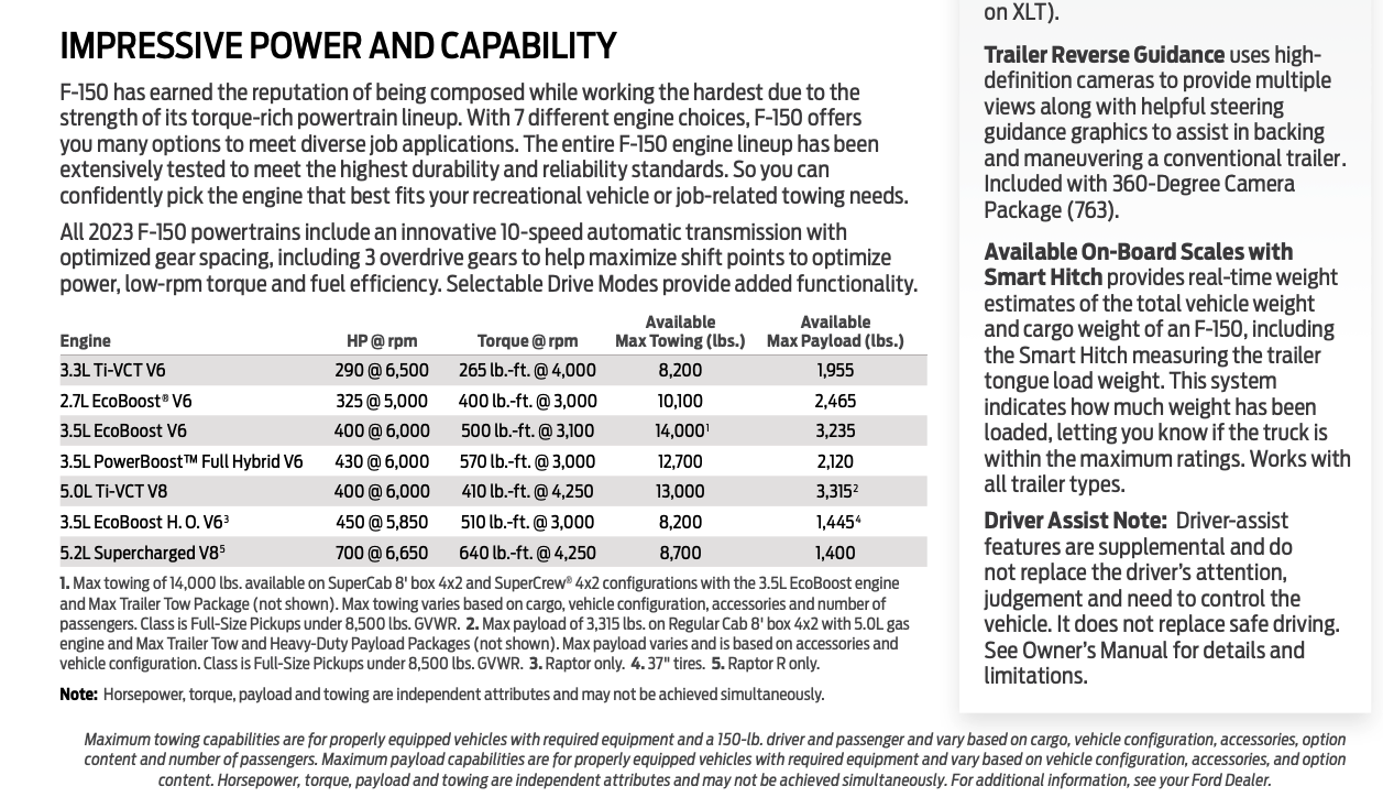

This is not always true. A semi tractor rarely outweighs the load on the trailer. Even my F150 which has a curb weight of around 5000lbs can safely tow upwards of 14,000 lbs according to ford in the right configuration.

Semi-tractor use fifth-wheel hitches, much different. This is basically true, especially for small vehicles like a Rav4. 14,000 lbs will throw your F-150 around like a rag doll if it gets sideways. I've seen it happen and the results are not good.
I agree and I would not try it either. We tow our rig 5000 plus miles every year and have seen some sketchy things on the road. However I was just going by what the official documentation says. Our boat weighs 3500lbs rigged for racing and closer to 4300 loaded for cruising for a week. Even at that weight over the rockies or other mountain passes you feel it. On the flat planes it's not such a big deal. Ford may be a bit generous in their estimates but the tow vehicle does not always need to outweigh the trailer.
