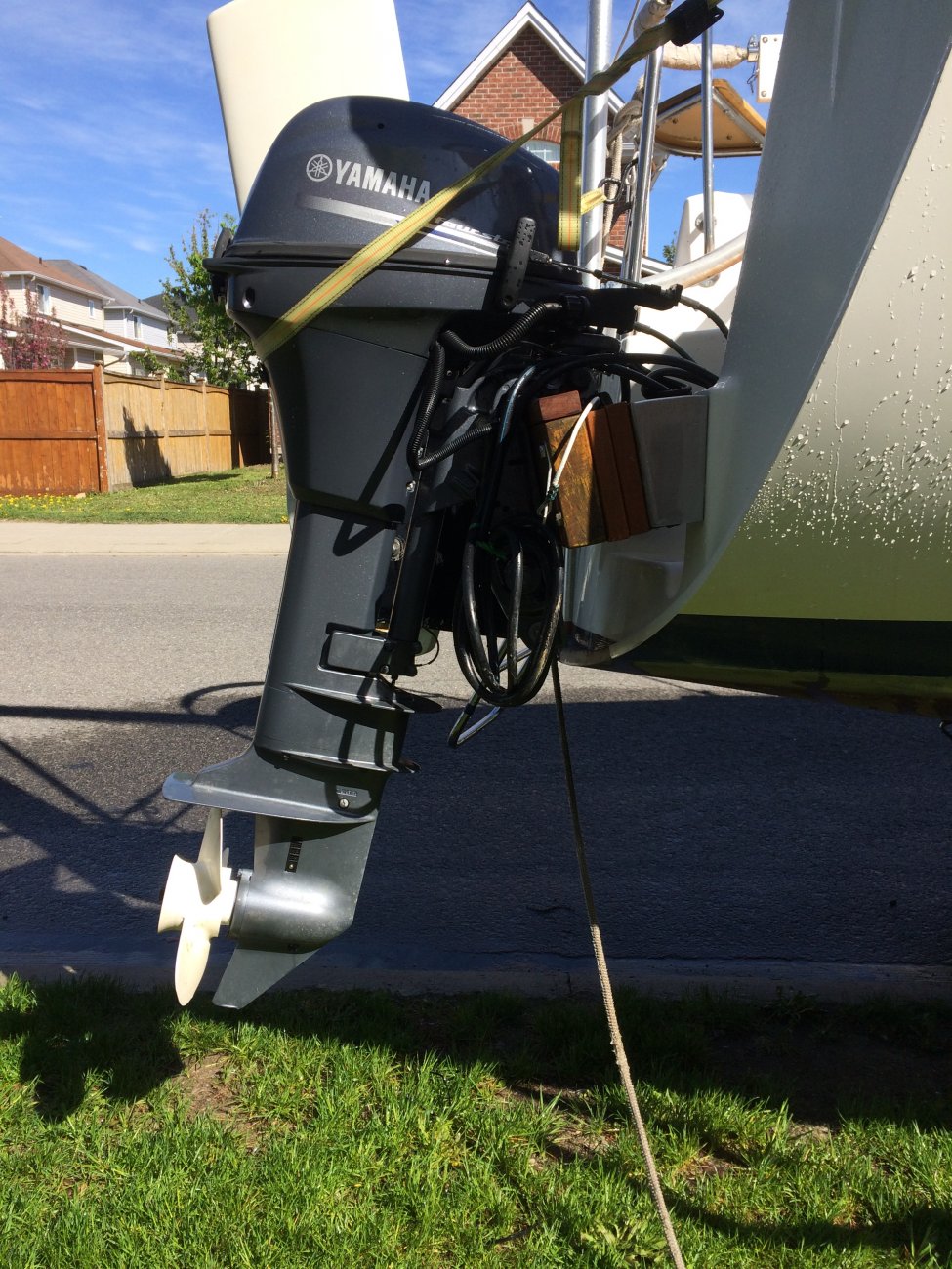

See pic for how I tow.... I raise the motor a bit, cinch up the strap and then let the motor down a bit so that the strap is taking some of the weight. I have driven many miles like this.
