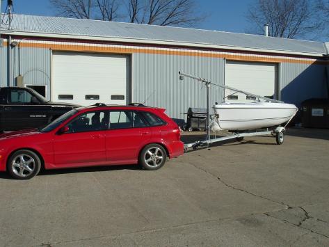

Probably be fine
It will probably be fine. I towed my H170 with a Mazda P5. Never had any issues at a ramp. It was an automatic & front wheel drive.
