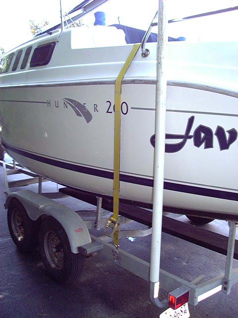

Red - it depends on the trip
Red, for any lengthy trip where you can be reaching speeds above 55mph, I would tie down. From the picture you can see the yellow strap that went over the boat and tied to the frame of the trailer. I also sewed carpet to those parts that touched the hull. I towed 60 miles each way for two years before using the strap. The roads were under construction and were boucning the boat around. Not much though just about 6 inches. Jim S/V Java
