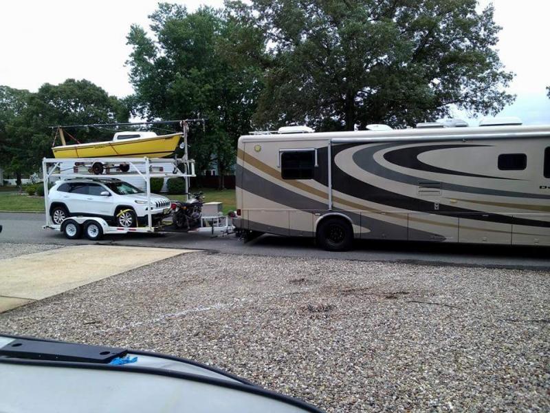

I'm looking for personal experience using an all wheel drive vehicle to tow and retrieve a small sailboat. Before you go too far take a look at the attached photo as it will answer lots of questions.
What you see there is a Diesel motorhome pulling a double deck trailer carrying a car, small sailboat (Sunbird 16 to be precise) and a motorcycle. The complete retirement package. Who says you can't take it all with you?
The Jeep Cherokee in the picture is no longer around so Im looking for an alternative. Something in the size and price range of a Rav 4, Honda CRV, A lower roof line would be better, allowing more room for the sailboat above.
I'd like specifics if possible. Car and type of all wheel, how it performed, boat, trailer, weights types of ramps encountered, problems and good stuff.

Unfortunately I won't have that luxury with the retirement setup. Aside from a size limitation I want to keep the weight in check. The rig as in the picture runs about 9300 pounds. (The pickup itself is about 7500 pounds.) The Jeep is about 4200 of it. Less weight in the car would be better. I've done hills in NC in second gear at about 13 MPH. Not loads of fun. I was thinking Subaru Impreza because it's the smallest, lowest all wheel I've seen. Subaru says they don't even rate it for towing because it has a low capacity CVT trans. And I dislike Subarus. If Suzuki were still a factor here in The US there were a few models that would have worked, but I have no interest in buying an orphan. I've created enough headaches for myself.
