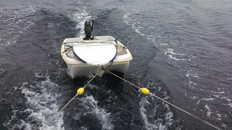

I have towed my dinghies all over SoCal for 40 years. I occasionally would deflate and carry them. Usually for races or very long stays. The inflatables I towed with a line to each cleat from each side D ring and a safety line from the bow. I have had a light and small (Watertender 9.4) rigid for twenty years and dragged it all over. Last weekend, I did 7-7.5 knots under sail in 14-18 knots to Avalon towing it. I used to stow the OB but now I mount it and tow with it. It actually tows better with it on the dink. It also makes it much quicker to head to shore with the dog when I get squared away and a lot less dicey mounting it. If you watch boats come into Catalina, I think you'll see that, excluding power boats, boats with davits, and racers, about 80% tow. However, it's all about your appetite for risk, so I certainly would not say your are too cautious! I have only once let out a long line because of large quartering seas on the back side of Catalina that resulted in the dink trying to beat me in...

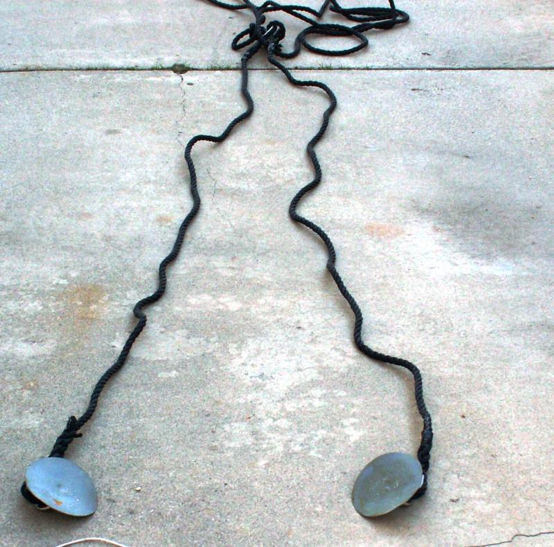

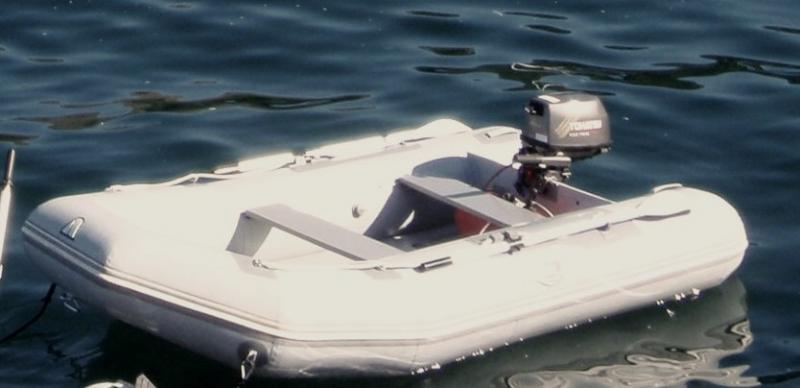

Me too (except only 30 years and all over Northern California):D My bridle attaches with SS carabiners to each d-ring. It is a fixed length with eye splices at each end for the carabiners. In the center I looped it through a strap on a snatch block. The yacht side is a long length with stopper knots at each end that passes through the block and is cleated to each side of the stern. The knots keep it from getting away if one side comes free. This double Vee arrangement always allows the dinghy to have equal pull from the tow boat (but not on the dinghy). At that point in a sharp turn its not really pulling that hard, but rather rotating. By adjusting the lines on the cleats, I control how far out it is from the boat. I have always found the sweet spot on the stern wake where it is coming down hill, reducing stress. The painter off the center attachment is the safety line (just a little slack of the bridle). When my swimming pool sweep died I took the four floats and put them on the dinghy side of the dual bridle. When I am going real slow or backing up I cinch up on one cleat and the lines to the dinghy float and really can't reach the prop. When I get home and back into my slip, I transfer the bridle to the bow and drag it in from there.
And I leave the 5hp Nissan 2 cycle on all the time after shutting off the fuel, closing the vent (internal tank) tilting up and rotating prop up.
