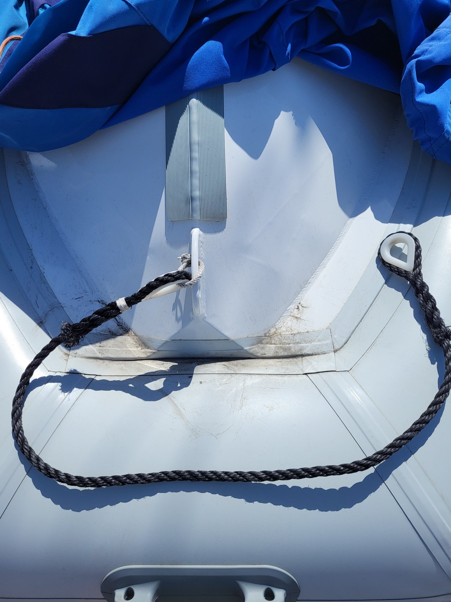

Question about towing an inflatable dinghy behind 25’ sailboat.. I assume my wake will be about 25’ back. I’ve understood that’s ideally the length of the tow with dingy riding on top of the wave and not surfing it. Does that length include the bridle or should I allow 25’ from the bridle to the stern? The bridle is about 6 feet (attached photo). I plan to run a floating line through the ring and attach to each of the stern cleats. Thank you !

1. Your assumption is focused on the distance of a displacement wave (25ft back). This is not always the case. Your speed and the sea state will dictate the distance of the waves behind the boat. You will find that there is a varying distance that you will need to adjust the dinghy to based upon conditions. Being on the back side of the wave will create some drag and tend to keep the dinghy in place. Being on top of the wave will place the dinghy in an unstable location as your boat surges or slows based on sea state. Being on the forward side of the wave will have the dinghy skittering forward and perhaps flipping.
Your described arrangement with a looped line to the cleats and a bridle to the dingy means that the dinghy may slide along the looped line. This could in time create chafe on your looped line. You are more likely to find that a single point on the looped line to be safer. I would be inclined to have a single line from the stern to your dinghy bridle. This simplifies your bringing the dinghy in or letting it out to tow. It will go where ever you pull it. Still be attentive to chafe as most floating lines are victims of chafe.

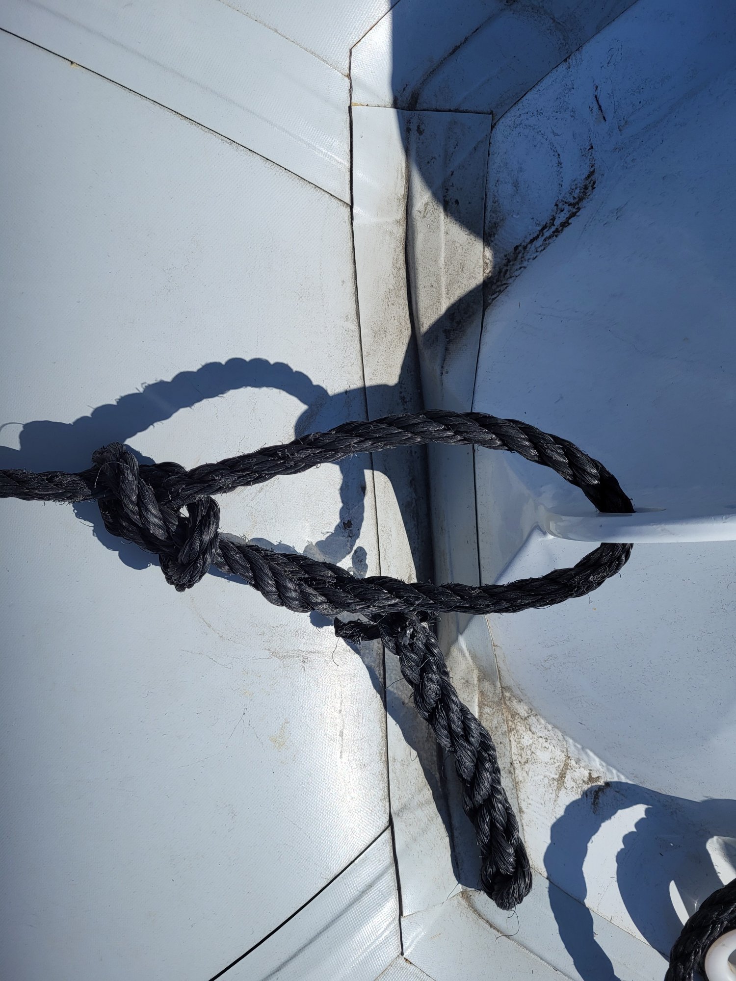

I have a up question about the tow line.. I purchased polypropylene tow line from West Marine to make a bowline to the towing ring. However the line is thick and slippery and it seems it can easily back out. I would appreciate suggestions how better to secure the towline.
I had considered a larks head knot to the ring but I understand we want the bridle ring to be able to move around wI think the ring.
thank you

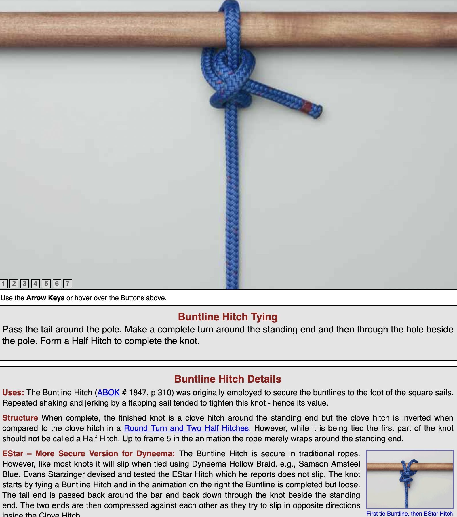

I suggest using a Buntline Hitch. This Knot is basically FIXED.
Here is a picture of it on a post but should be through your ring.
You can download that APP.
"Animated Knots by GROG"

Here's one way. Another is make a Crown knot w/back splice at one end. Try your bowline, make it long, then pass the backsplice through the standing part a couple of times. It won't slip or come undone. Easy to get untied.

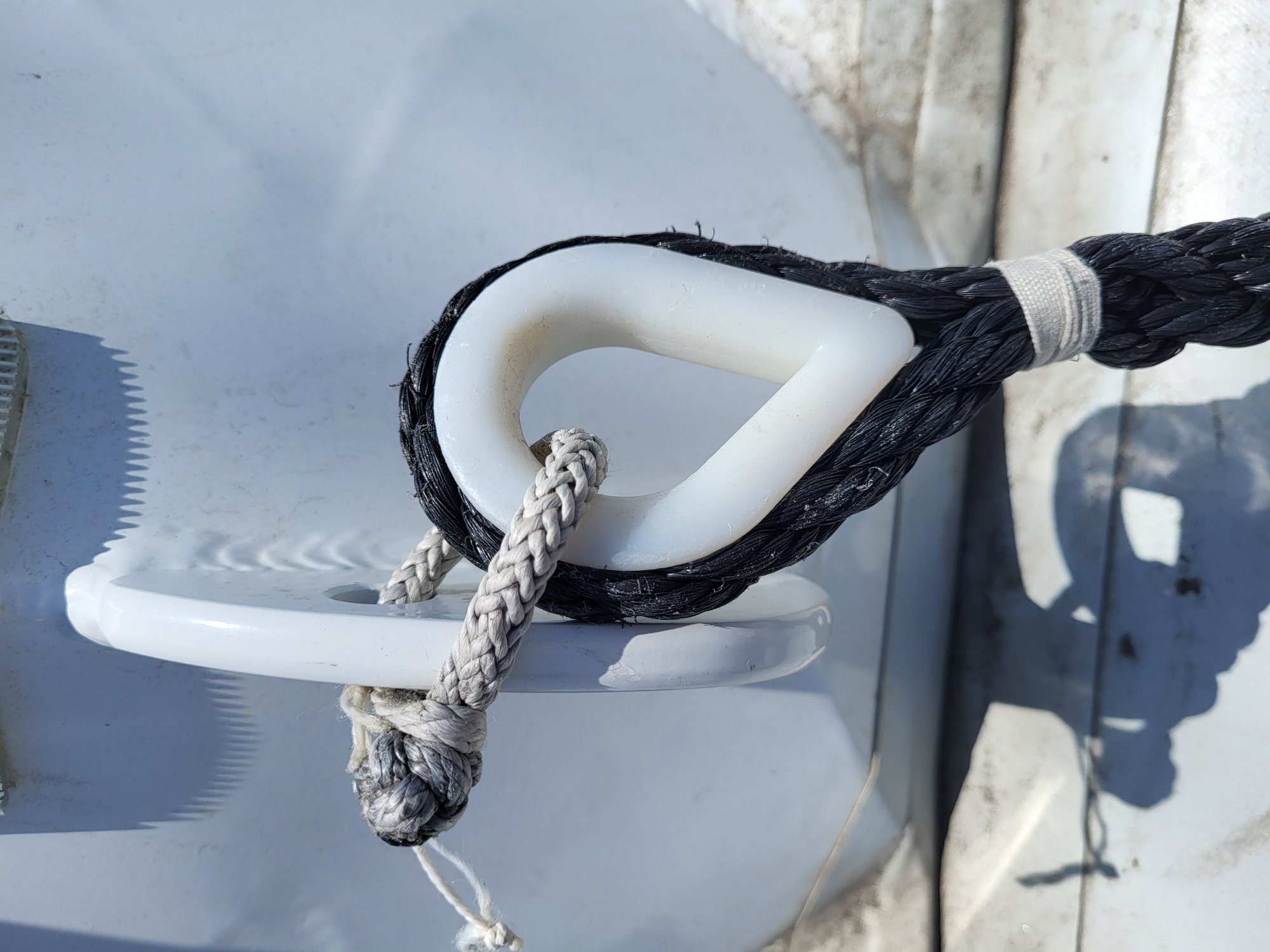

Here's the other; 7/16" poly. Note the backsplice. Here the backsplice end is in the loop, but could pull back and pass through standing part.
