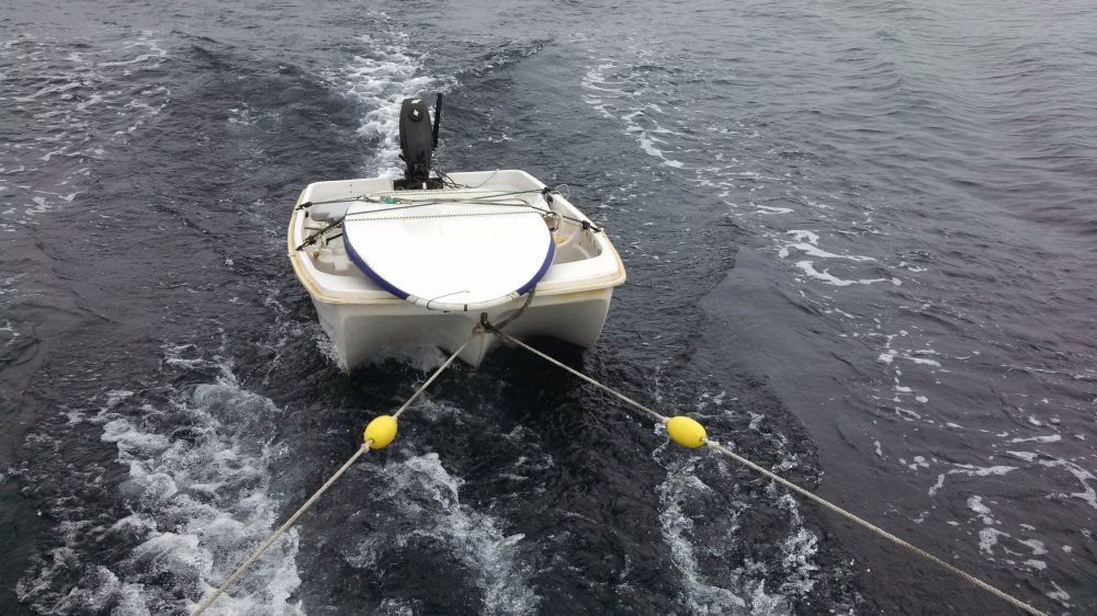

Mine is not an inflatable, but it tows better with the 22 pound OB on it and raised. Gives it a bit more bow up. No appreciable difference in towing drag.

Where do you attach the towing bridle? My RIB has towing eyes low enough that the bridle gives it some lift.

From the eye using two lines (separately attached to it). It does give some lift, but that's a pretty plumb shovel-shaped bow, so a bit of weight aft helps. Of course 22 pounds isn't much. This may not apply to an inflatable.

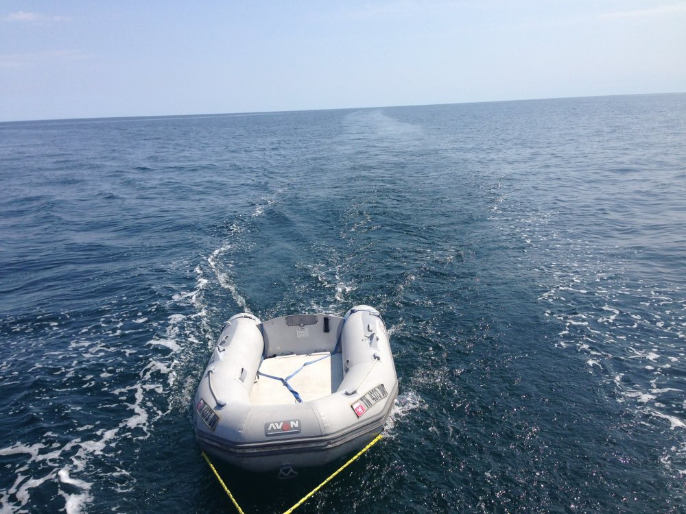

I tow my Avon 260 air floor without the motor on the crest of the stern wave and I have not noticed more than a .1 to .2 knot difference. I’ve towed in the GOM, Rivers and GICW. I normally keep it on the foredeck when not cruising but it restricts my visibility there so I generally tow when cruising.
If it were really rough, i’d Bring back up on deck.

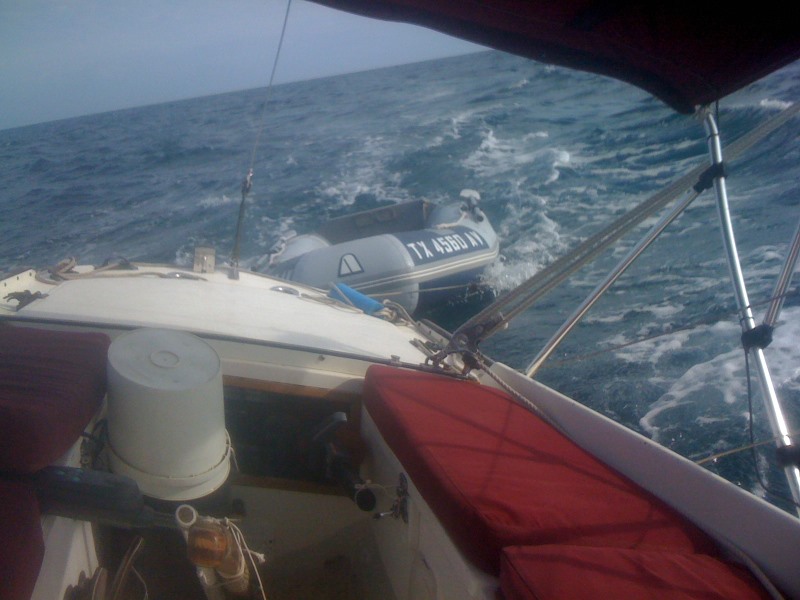

My boats foredeck is not large enough to stow a dinghy- hard or inflatable. So I always tow- Twice across the Gulf of Mexico, twice across the Gulf Stream, all through the Bahamas, and the entire coast from Texas to Annapolis. Have had ONE problem in all that time, an that was when I didn't noticed the dink was not fully inflated. Off shore I tow very close to the transom. Photo shot way offshore in GOM

Agree- I've always rigged my inflatables with tow lines around the sterns of the sides,, then forward

I like the way you attached your auto-tiller to the tiller. Wish I had though of that before I spend the money on the mounting bracket. :clap:

lol The reason for the lashing was that the bolt was loose in rudder head, an the seas kept knocking the autopilot loose. So I tied it in places. There's a regular pin mounting in cockpit seat for it..
