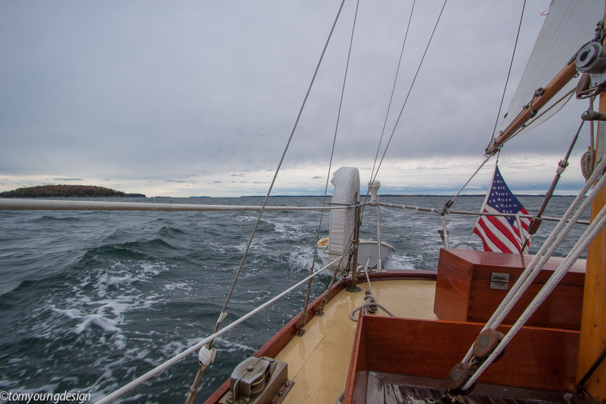

My Nutshell Pram secures the tow line to a laminated frame in the bow (bowline), via a hole in the bow transom, located about mid-height(photo).
It doesn't 'hunt' like a Vee bowed tender so I've never considered a bridle.
The reason I use a dock line with a loop is that I usually just throw the loop over a winch at anchor or moor. Plus, the loop is usually put over a winch or cleat after the proper towing length is set on the aft tow cleat (you'll always be setting that at a different length if you want the least drag), as insurance.

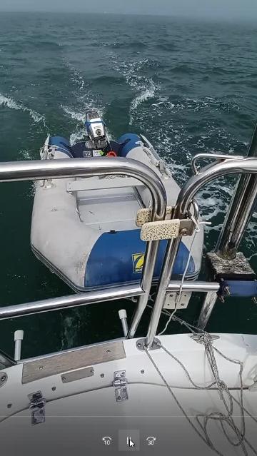

I do not know how it would affect a hard-shell dink, but I always tow my inflatable tight to the stern. I elevate the front of the tubes so that they ride about 6" - 9" above the water and just the last foot of each tube is touching. It greatly reduces the amount of drag and wake created and eliminates the possibility of running over the painter. I have a regular bridle and painter rigged but there is a knot in the two-part line strategically located so that when that knot is dropped over a small cleat on the transom the nose of the boat will be just above the water while underway.
