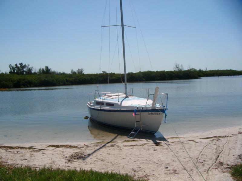

I LIKE that side ladder..Patrick do you know where that came from?
and where do you store it?

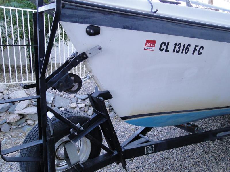

FYI, in the attached picture is a mod I did to my trailer just over a year ago that is simple - no moving parts and I’ve now used it about five times and it really has eliminated the need for the mac bump. It is simply a combination of a forward roller on the trailer (actually Ive had this roller for about five years now) and also a lower stop. The upper original stop is still there but it mostly just used as a guide and backup if something real bad were to happen. Everytime I’ve used this, I just winch one time to the stop and pull the boat out and the boat is sitting either at the stop of close to it.
Getting the boat forward on the trailer is important with this boat as that has a big influence on tongue weight.
It is a stainless steel ladder from West Marine. Instead of permanently mounting it on the stern I have clips on the cockpit and the bow. I obtained it second hand from another sailor.
When sailing I keep it on the clips at the cockpit. When trailering I keep it in the Suburban.
I have a line tied to it when sailing so a wave does not try to take it away. I feel like I need to always have a ladder available in case I fall overboard.
West Marine still sells the ladder(I have seen it in the store) but the number on my ladder is obsolete.
Great picture, looks like you are having fun :dance:.
I think that your ladder....
.....is the same ladder as what we got for the Endeavour except...
We bought the 5 step gunnel mount....
http://www.westmarine.com/webapp/wc...&subdeptNum=50353&classNum=50354#.UNx1vqxoryc
...and I think this is the side mount like what you have....
http://www.westmarine.com/webapp/wc...&subdeptNum=50353&classNum=50354#.UNx23qxoryc
WM has their name on them, but I think they are Dive N Dog ladders, who I believe are in Naples. We tried to order direct from them, but they didn't have ladders in stock, so we had to bite the bullet and buy one from WM. Other people do sell them and now that WM price matches that might work,
Sum
