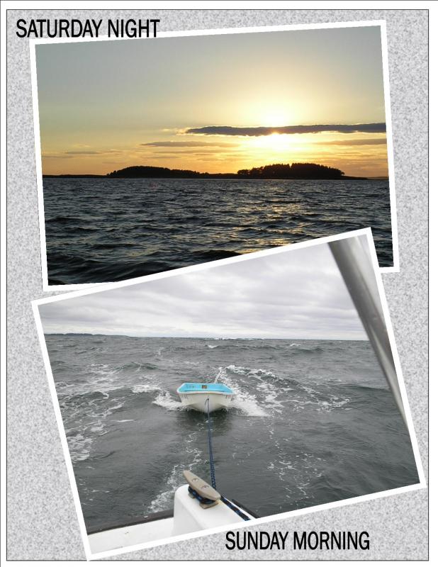

We tow our 8' dinghy behind our Lancer 25 all the time. AND in 8 foot seas. The photo attached was one such day. Seas were about 7'. We were motor-sailing with following seas. Half the time the dinghy was abaft the beam. Each wave would drive it forward, almost to the end of the painter, then it would fall back with a jolt. After a while, I looked about 1/4 mile to starboard and there she was . . . my dinghy. We had to race her towards the rocks and reattach the painter while hanging over the rail. The painter was fine. The stainless ring has snapped.

hey MrBill
there are only two wave crests in the bottom picture.

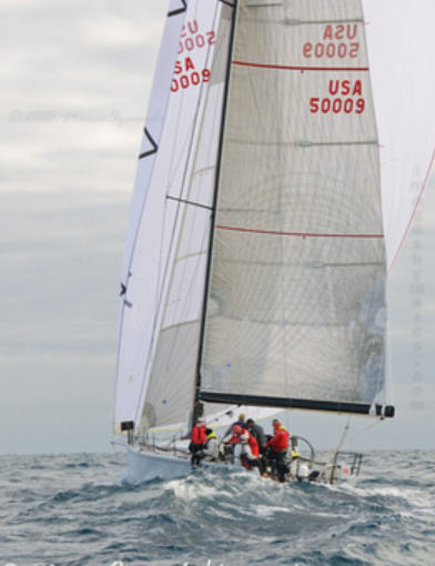

Your definition of 7' and mine appear to be quite a bit different.
in my mind, that looks like 2-4' and the sunset shot is 1-2 or a 'light chop'.
fwiw, this was 3-5'
I know . . . it doesn't look like anything in the photos but trust me. In the trough, waves were over my head, standing. The shoreline would completely disappear. When we were running, the boat pitched forward at about 15 degrees. (roofing gives you a calibrated eye). The dink would race ahead and snap against the line enough to fatigue and snap a SS ring. It sucked to be out there.
