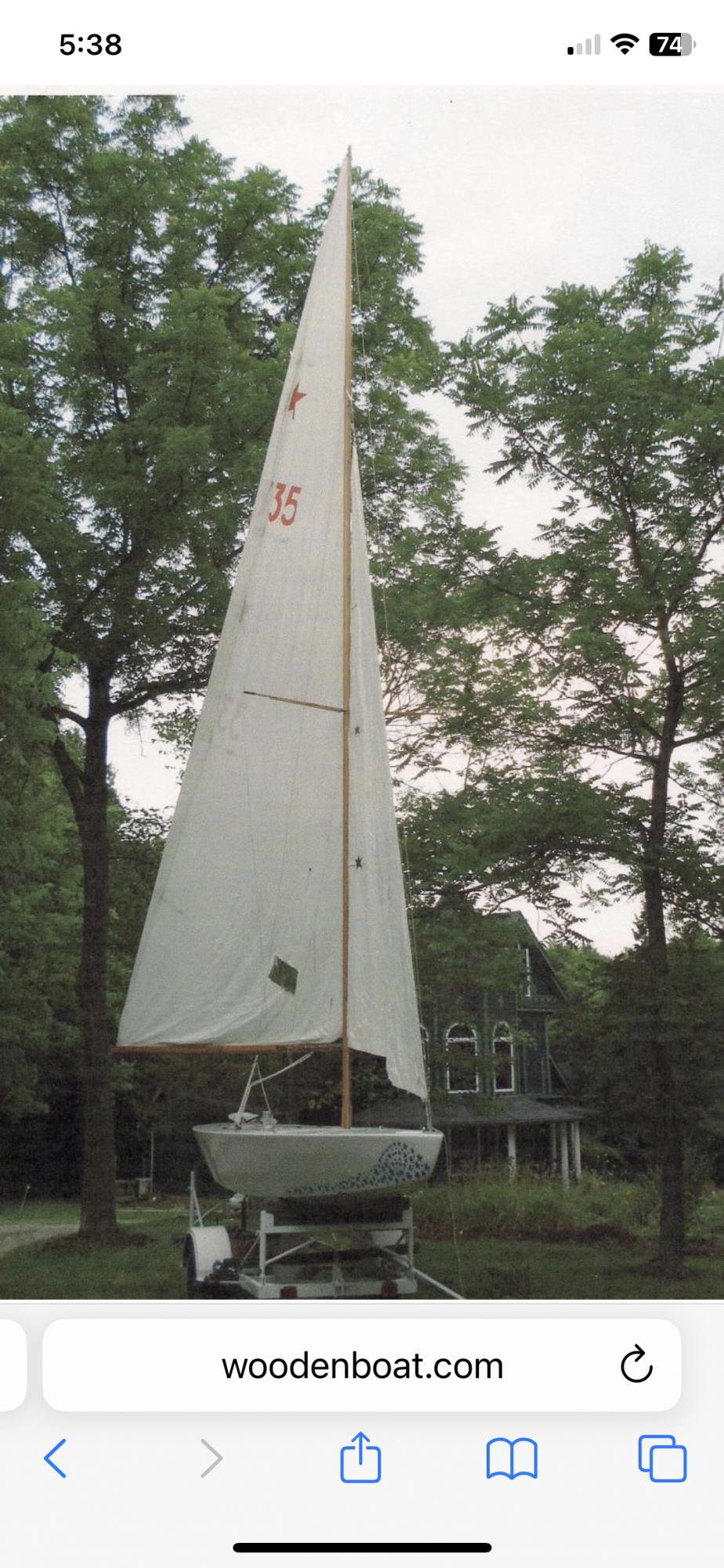

The previous owner said the aft stay tensioner is not for warping the mast.
I own a 1954 wooden Star (International) “Wishing Star” or it owns me that is made to warp the mast. The mast is a toothpick.

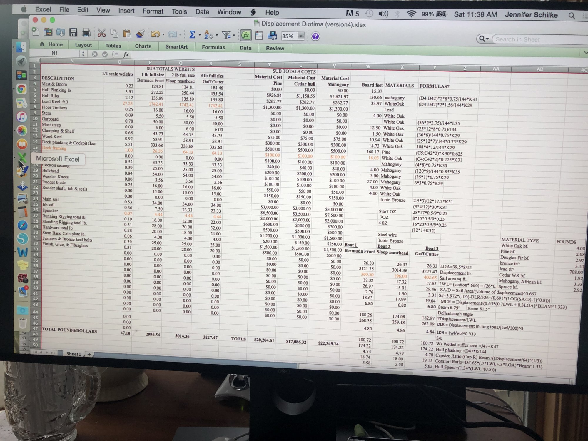

Hayden,

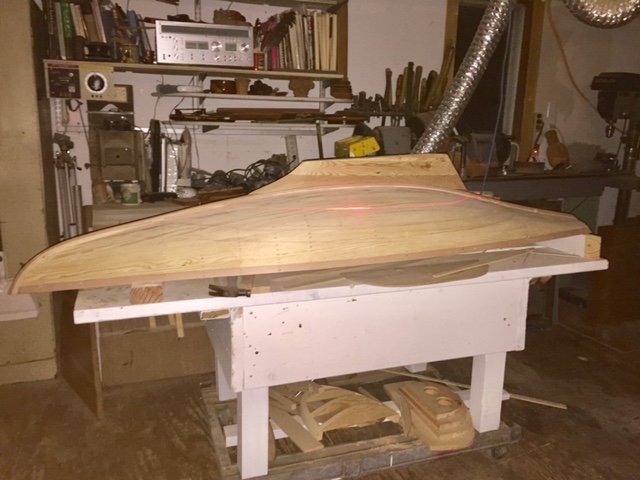

I have done some design work. Even with everything you can think of you just can’t think of anything. I did a spreadsheet and 1/4 scale model of my Diotima.
I made the hull frames, planking and decking, the percentage larger in the model as related to the wood differences species and weight it to estimated weight as well as a lot of other things like center of buoyancy, waterlines at different angles according to the Dellenbaugh Angle, but I never felt confident in my Dellenbaugh Angle.
The Dellenbaugh Angle is an approximate measure of a sailboat's sail-carrying ability and stiffness, which predicts the angle it would heel under a specific wind pressure.
But with the model I could calculate the center of buoyancy at different waterlines angles anyway.
I don’t know how Naval architects calculate this without spreadsheets back in the day.
I didn’t use a 3-D computer program, because it seemed like you would take the sport out of it and I would miss out on a learning opportunity.

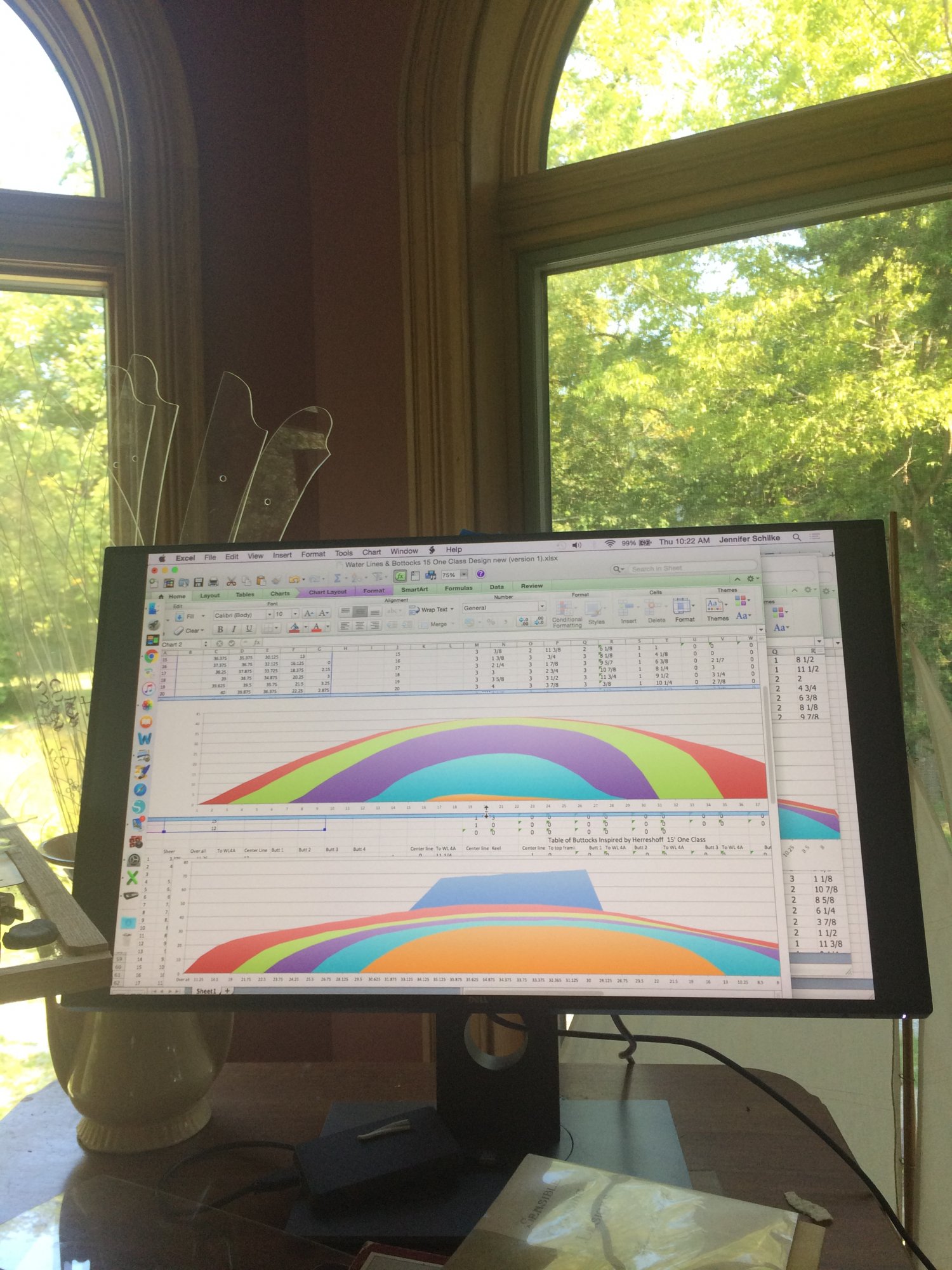

Most everything is dependent upon how accurate the Table of Offsets are.
I did a lot of pre-faring in different charts in SS, you can see a 1/16” off clearly.
I also did a Curves of Displacement.

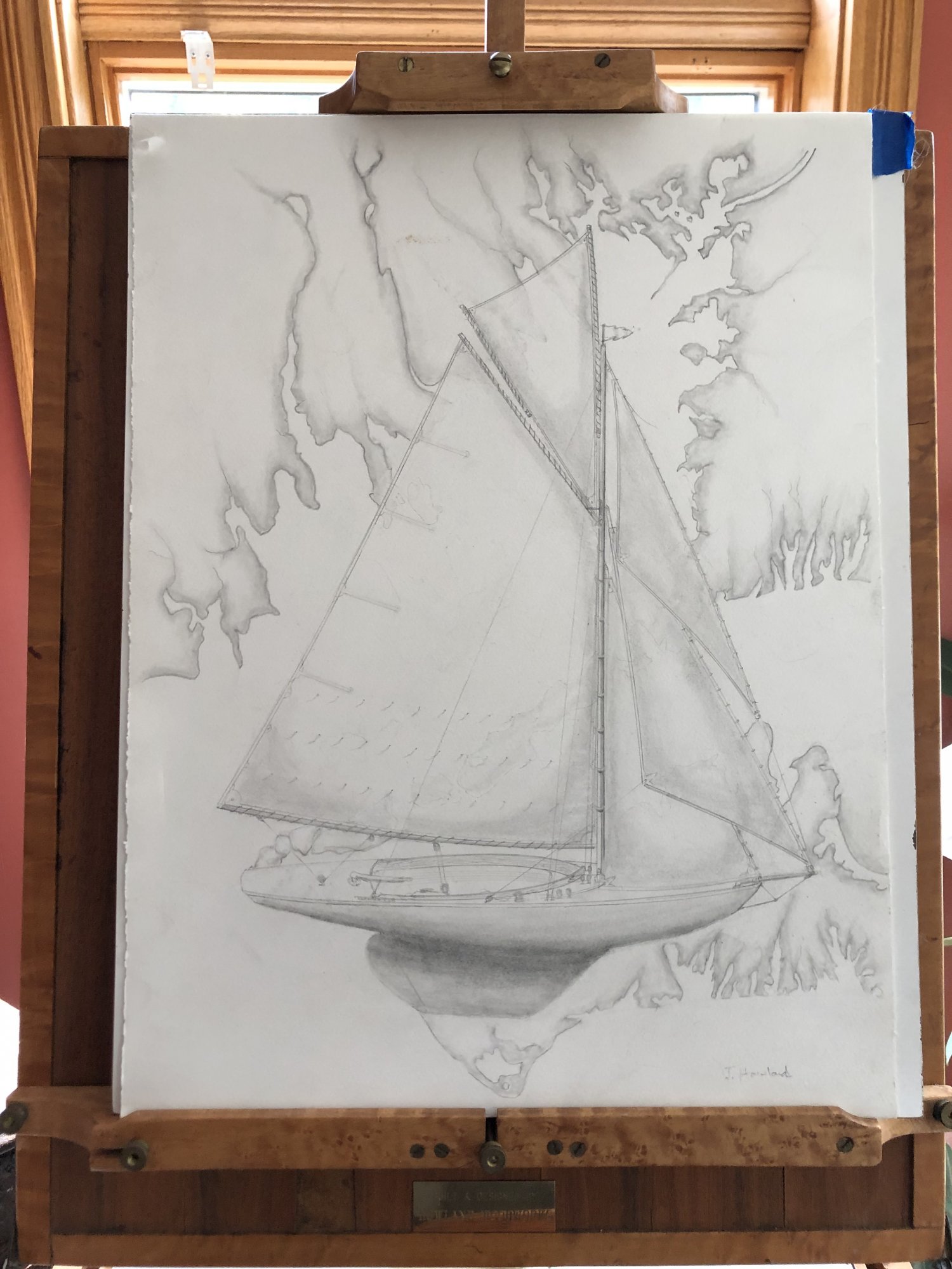

Here is one of my inspiration for my Diotima a Herreshoff’s H15 or Buzzards Bay 15. Which I drew on the map of Buzzards Bay Mass.
