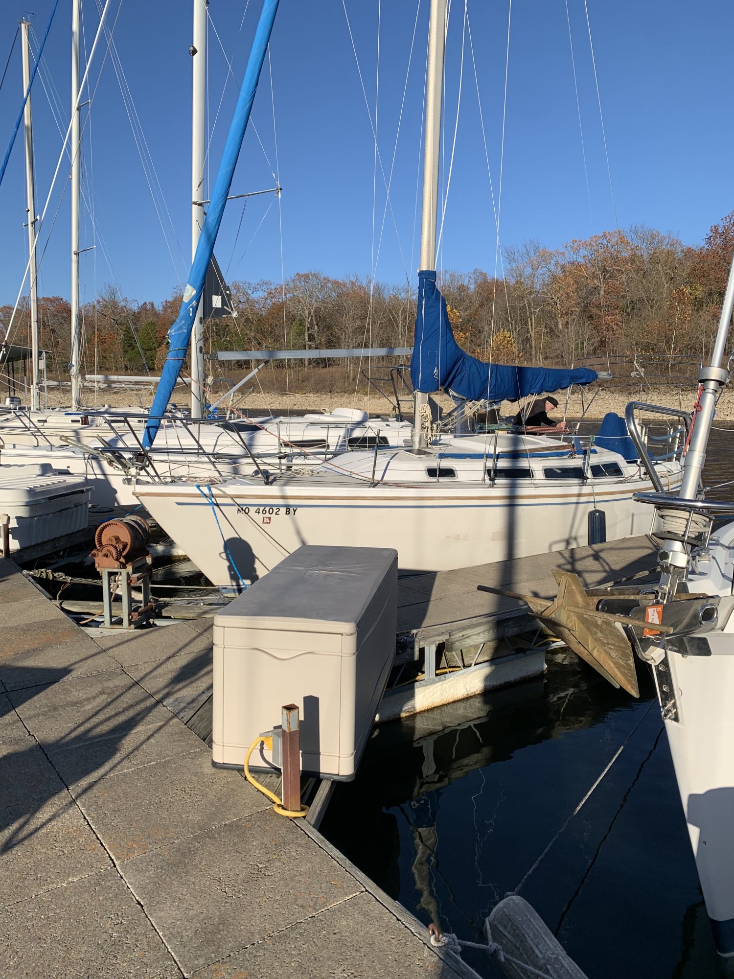

Catalina C 30 MK1 1983 Stockton Lake Missouri
I have a Toyota Tundra 5.7 v8, 4 wheel with 12,000 pound towing package. Trailer is Tri-axle haven’t weighed it yet but it looks heavy and will hold a 34”
Can I tow it down a 4 lane Interstate highway?
