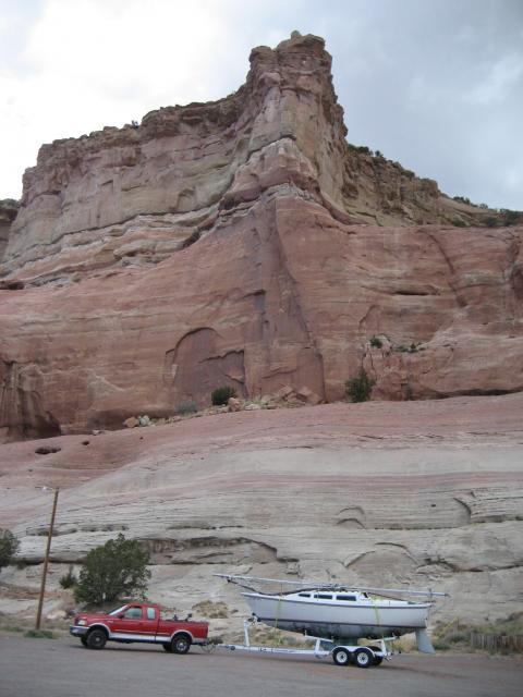

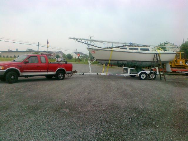

Having just towed my Catalina 27 2300 miles through lightning, hail, wind, and lightning, without pardon the pun, a hitch. I think you should be fine. I have an F250 and the boat has tandem axles with brakes on one axle only.
I was able to travel between 60-70 mph and dropped to 45 on the long steep grades. I hit 75 on some down hills anticipating the next hill. I learned to take cues from the truck drivers especially under less than perfect driving conditions.
I recall driving I40 in Missouri through corn fields as far as the eye can see. The wind started to pick up and in a distance I could see the wave coming across the corn field from about 5 miles out. All of the truck slowed down and so did I before the blast of wind hit. I was almost like being on the water watching that wave coming.
When the weather got really bad most of the drivers pull into rest areas and wait it out. I had to do that a couple of times.
The thing that made me most nervous was watching the lightning strike the ground less than a half mile away, and me riding around with 33' of aluminum pole strapped to the boat.
One of the things I learned was a respect for higher octane gas. Most of trip I ran on 86 octane but switched to 91 when I hit New Mexico and Arizona. It really made a difference and allowed me to keep the truck in overdrive much more of the time.
Another thing I learned that cruise control does not work well when towing a load. It will drop out of overdrive to accelerate but then does not drop back into overdrive readily. I found that simply by getting the speed up in third gear I could just take my foot off the gas for a second and drop into over drive without sacrificing speed. The cruise control would not do that.
I also learned not to pump the brakes in a panic stop. The trailer becomes really herky jerky. First panic stop landed me in the middle of an intersection.
Watch the cars and trucks in front of you to help you anticipate dips and bums in the road. I have known this for some time but used it on this trip religiously.
Always make sure that you have an exit strategy in parking lots unless you are really good at backing up.
Don't forget to watch and make sure you clear your trailer's wheels when turning.
Check your trailer's tires for cracks especially on the side walls and between the tread. Even if the tread looks new the cracks will expand and blow out when they heat up.
Check your valve stems the also rot out with the sun.
Strapping the boat down is important. In the back I used the winches and cleats to attach a tow web strap. On my Mack I have a cable that runs trough the bow eye and is connected to the trailer winch post. This one came with a chain. Check your trailer winch strap for sun rot. I cut off about 18'' every six months to get rid of the exposed section.
Another trick was to use the GPS Nuvi to find cheap gas. I managed to more often than not find Costcos en-route.
Given the weight of your boat and the flat land conditions you shouldn't have any problems. The most important part is having the ability to stop suddenly. I towed my Mac 25 home with my Vanagon.

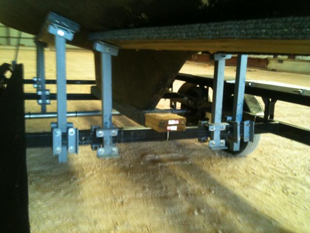

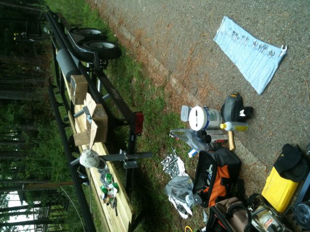

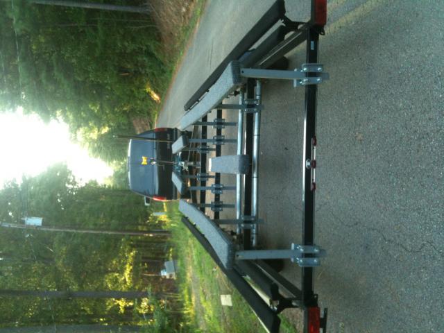

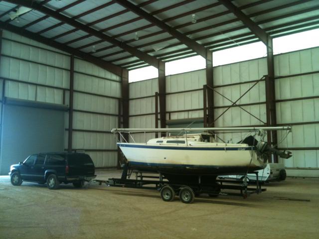

Thanks for this. I just bought an Oday 23 and trailered it for the first time. After a failed attempt we finally got it on the trailer correctly. I adapted a pontoon boat trailer. The trailer is double axle with brakes and I'm pulling it with a 1/2 ton Suburban. Does that seem ok to ya'll? I don't know about my trailer mod. Some day I want to be able to go to the gulf (7 hours) or to the great lakes (9 or 10 hours).
