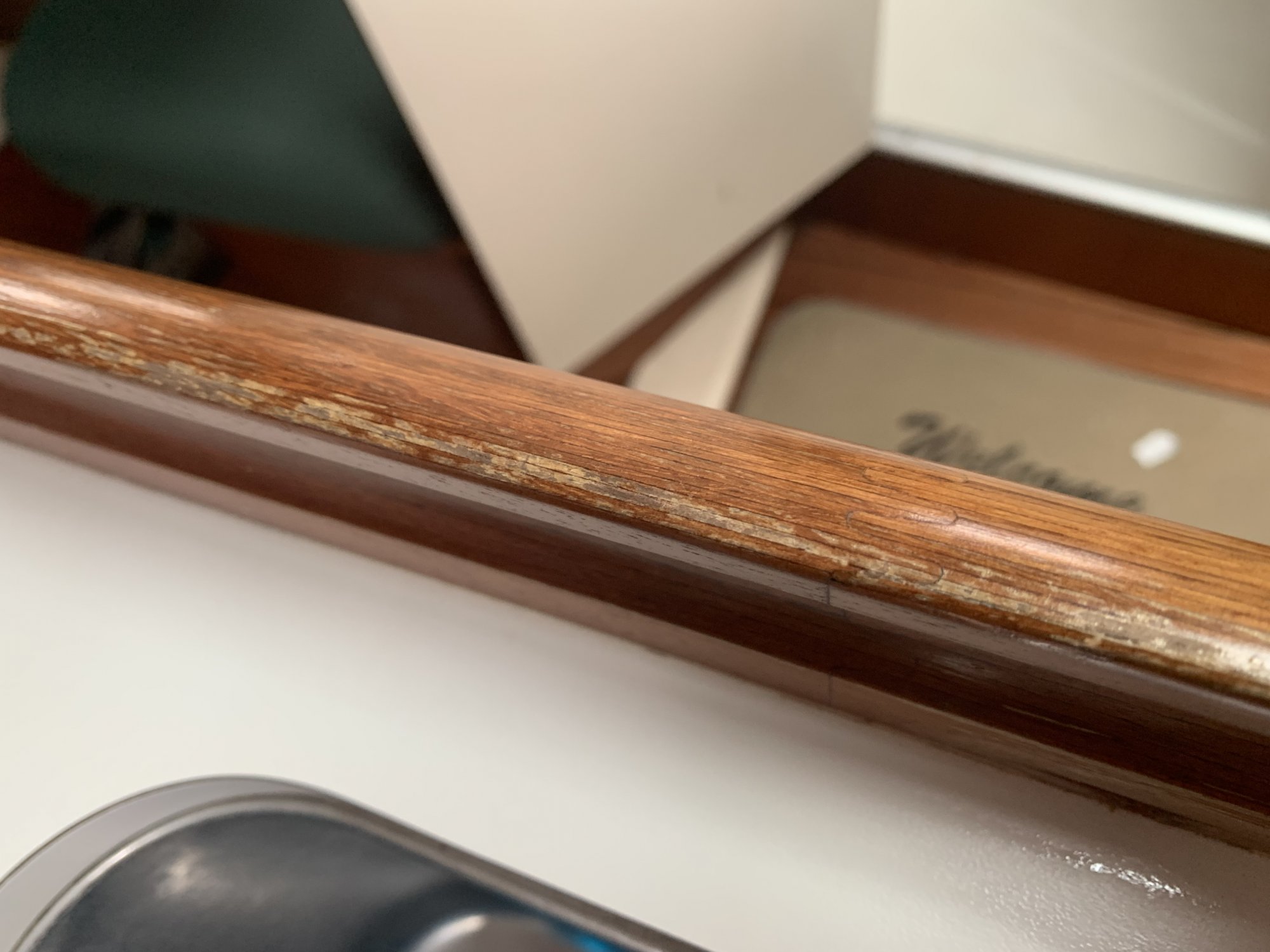

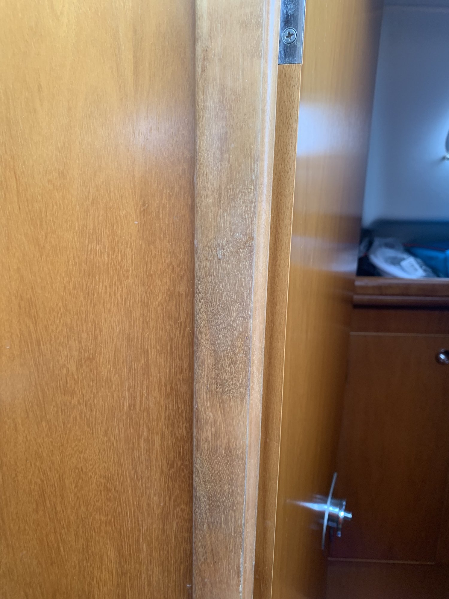

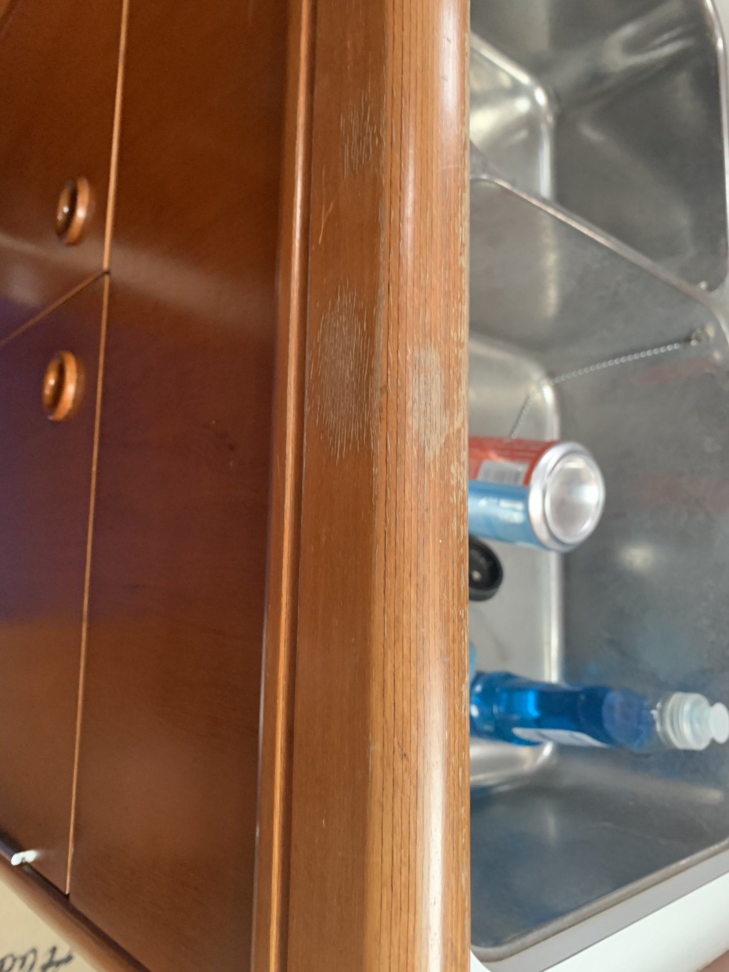

I have a 2002 331. the interior wood is pretty good but needs a little touch up in a few places. I know “the correct way” woud be to sand it down, re-stain the wood then put varnish on it. But my wood is not that bad and it’s only in a few places (mostly around the sinks where it got a lot of wear and water).
so my question is;
1. First of all does it have varnish on it or some other coating/oil/sealer?
2. What’s the easiest way to touch this up?
3. What’s the easiest way to keep the interior wood looking good to prevent future issues?
Has anyone used a good product on this? I used the Star Brite Teak Sealer on my exterior wood and it worked and looks fantastic! Any products like this that work on the interior?

That area will likely need to be refinished. Beneteau used a lacquer finish that also incorporated stain. They recommend Mohawk pre-catalized lacquer spray for refinishing; personally, I have not had any luck using it. So, you’re going to have to sand & restain. Try minwax old English chestnut with a small amount of Sedona red stains. I would use min wax helmsman spray polyurethane to seal…2-3 coats. Use extra fine steel / bronze wool or aqua buff compound to blend sheen to surrounding untouched finish.Have to experiment to get a close shade match. For small scratches, try mohawk stain pens. I believe there is a Beneteau wood finishing guide in the archives here. Good luck.
