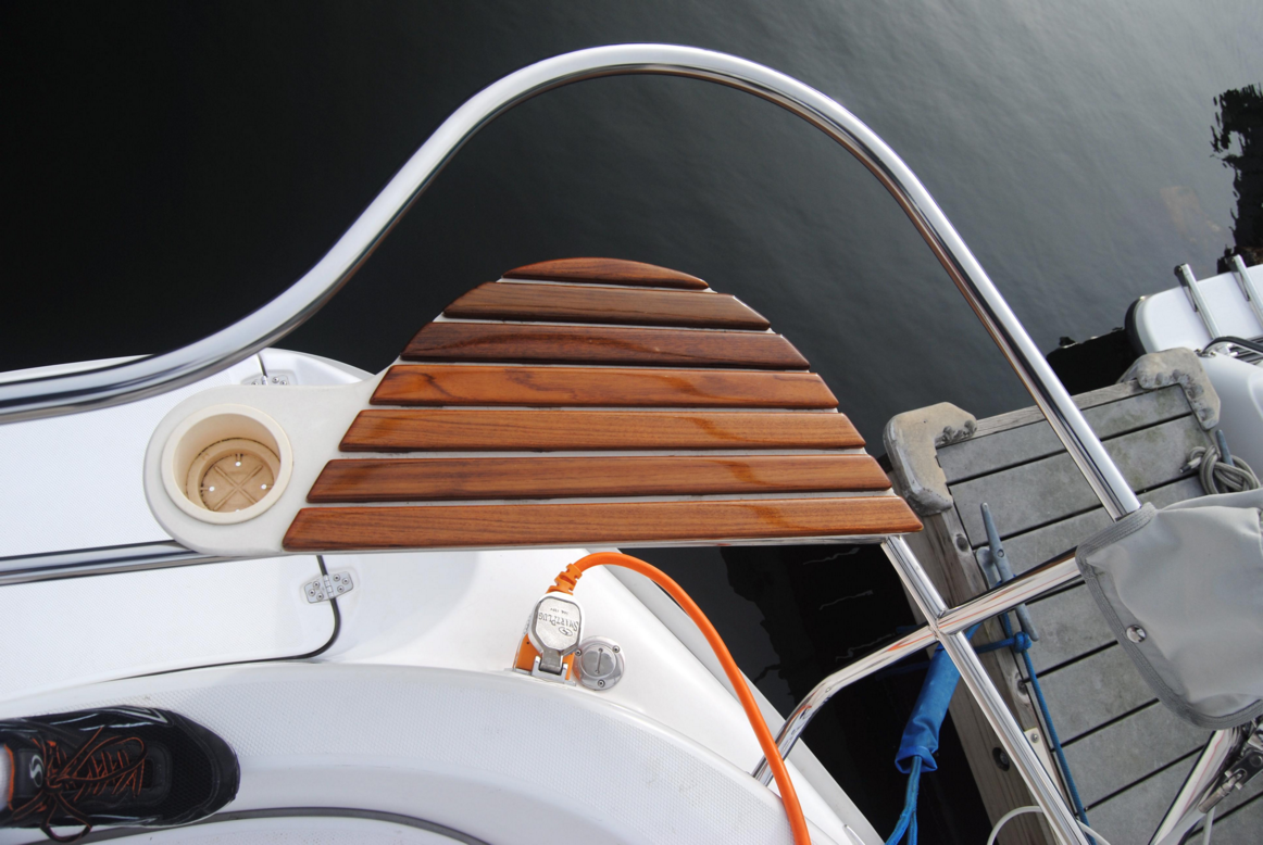

I applied Lust to my stern seats. They’ve only been on for 1.5 years now, but they still look great. My dock neighbor’s boat is loaded with brightwork and he asked what i used. I mean, only 1.5 years but hey, it’s a data point.
Nice. How many coats?

My memory is somewhat fuzzy here. I had brought the seats home and it ended up being my covid project. Either 5 or 6 coats. Application is dead simple with the short recoat time. I only sanded the layer prior to the final layer. I was going to post a picture, but there's no way I'm following Ralph's artwork.
