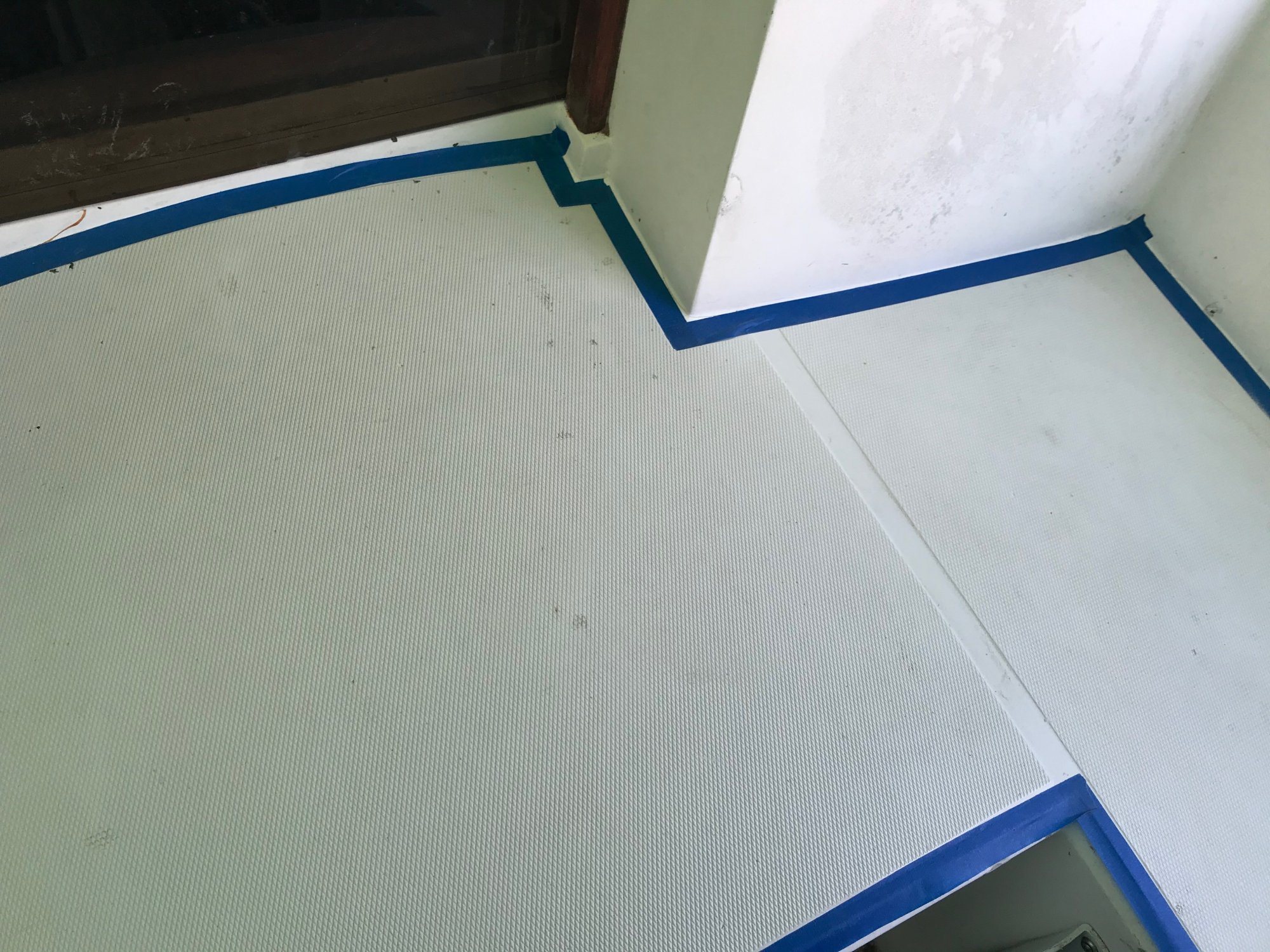

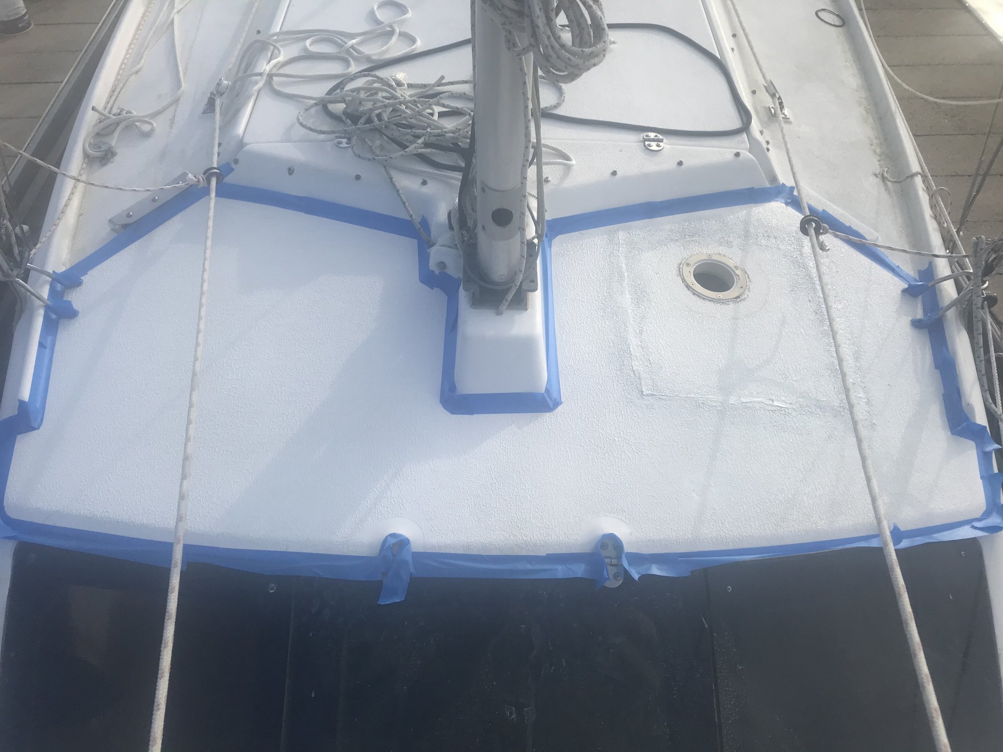

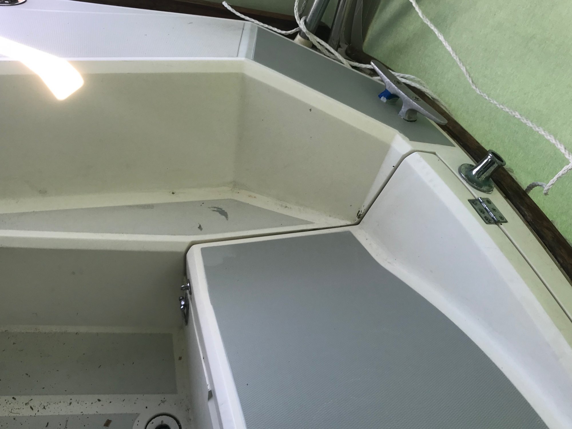

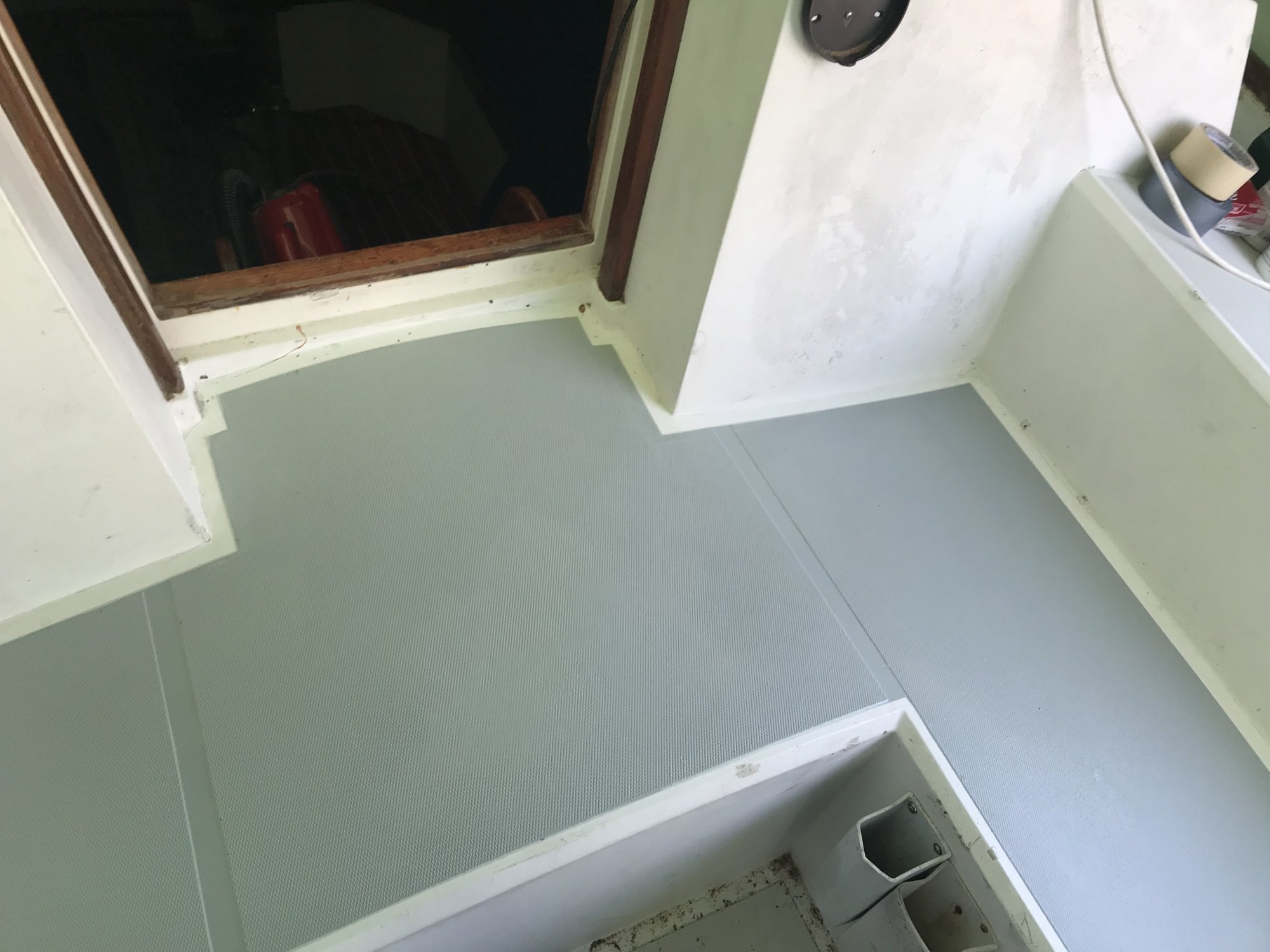

I put this product on top of the non skid diamond pattern on my 30+ year old deck. Cleaning was a light sanding and acetone. I will report back how well it wears. Application was easy as roll & tip, one coat. Feels solid, rubbery type feel, silicone beads? Not the sand texture, but it has gripablility, and I was pleased it still kept the deck pattern. I mixed the light grey with the white color 50/50, came out a bit darker than the original color, close enough...my time estimate for complete project, about 6hrs for prepping and 6hrs for painting. Below are photos, light areas are before...darker are after. Enjoy.

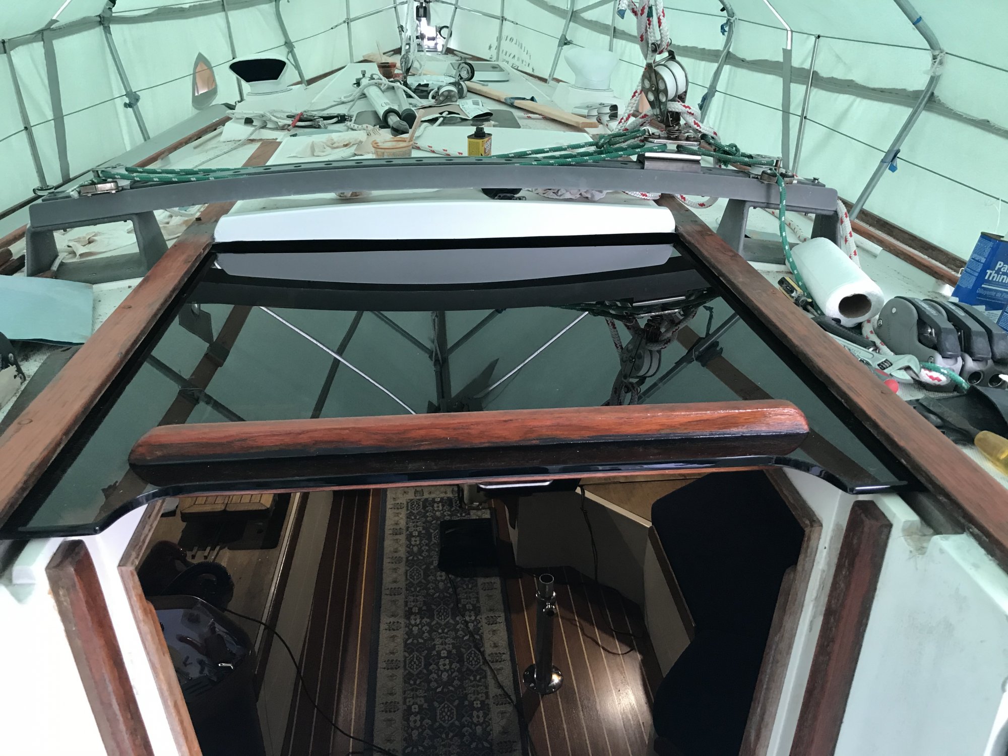

Yes, I sent Tony from Hatchmasters the old one...to use as a template, and 3 weeks later picked up new piece. Carefully removed the teak bungs, took out screws, about half-way on port/starboard teak coamings, used wedges to slowly pry up enough to slip out old hatch and slide in new one. Not a difficult job, just time consuming about 5 hours...more or less.

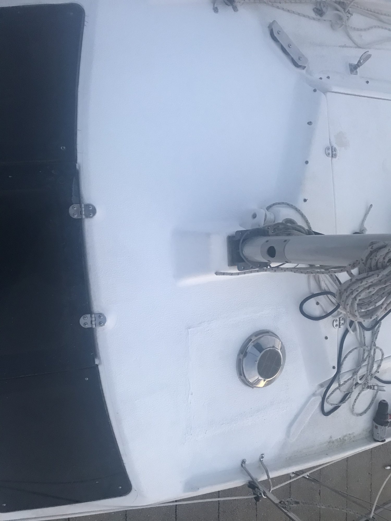

Few Crazing spots that were bad and a couple of dents, I dug out and used the total boat 2-part epoxy and sanded, you can see the spots in the photos. Not quiet bristol, but acceptable for government work. The problem was losing the diamond pattern in the repairs. Fortunately weren't many spots that needed repair. Paint covers light crazing.
