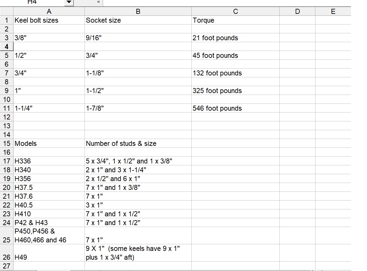

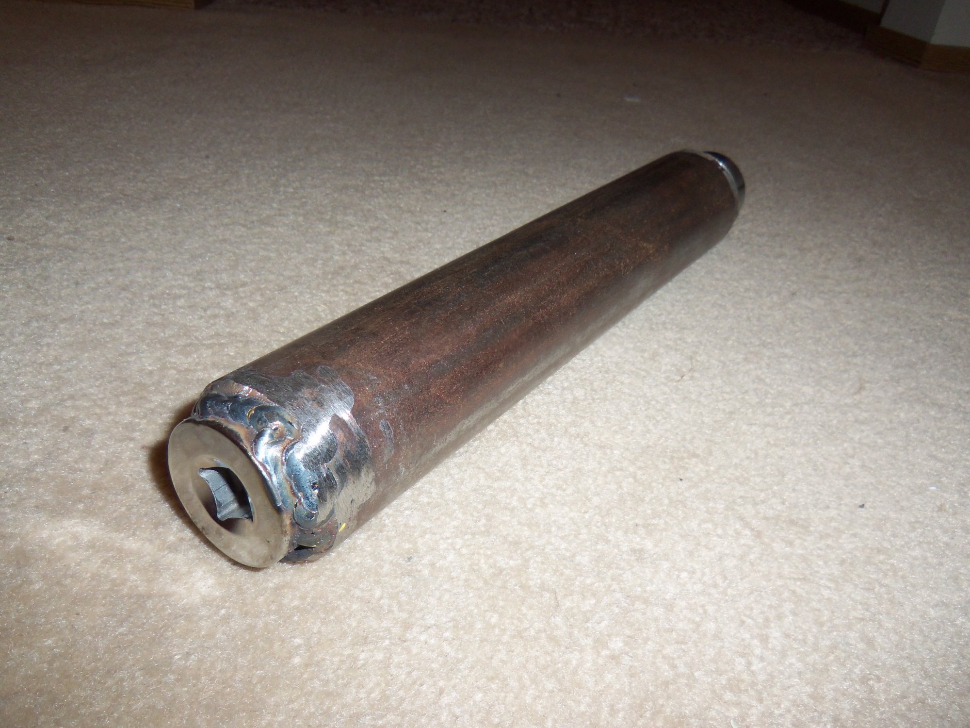

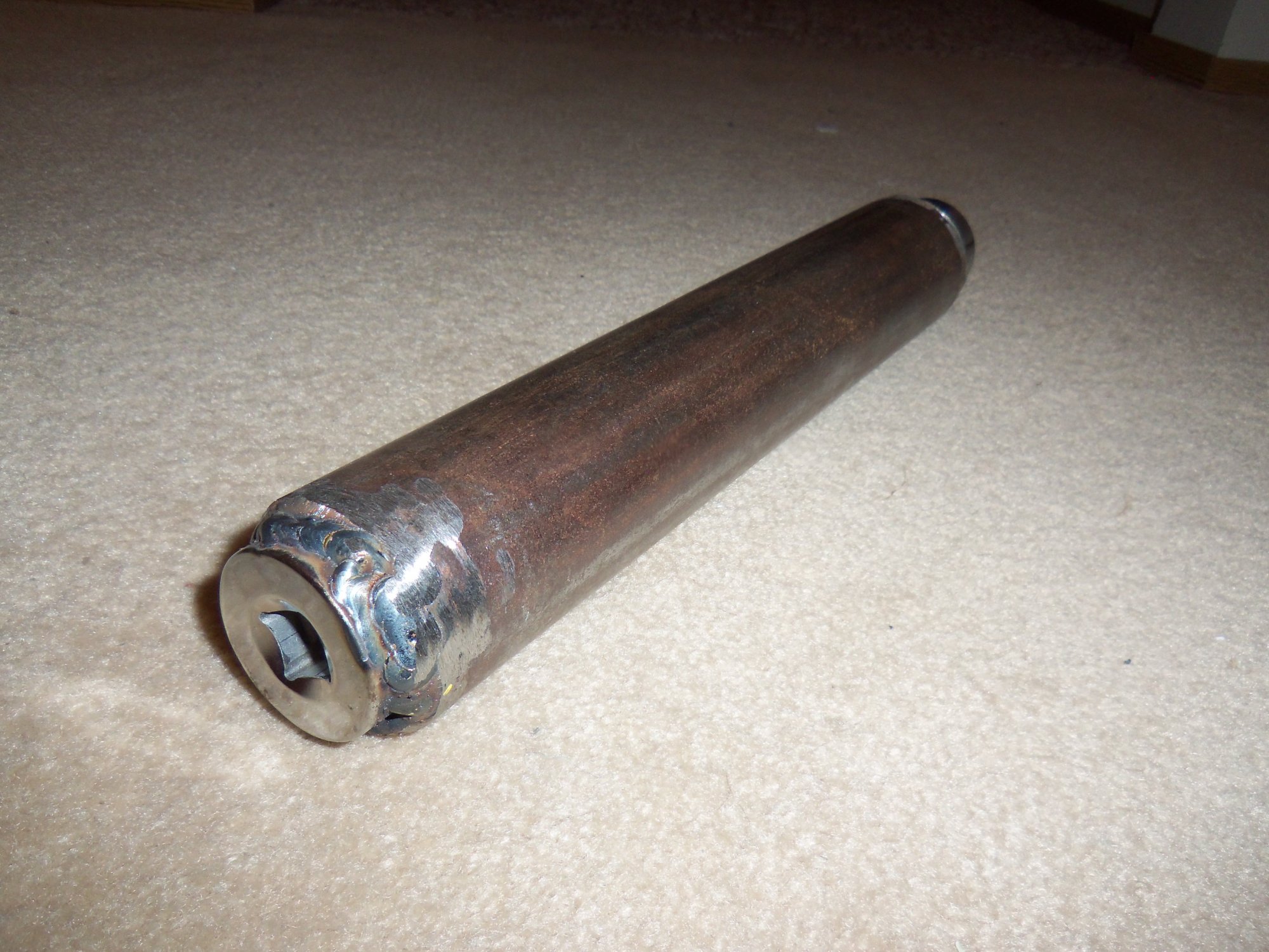

The attached table provides guidance on torque based in bolt diameter derived from information in Table A7 from ISO/DIS 12215‐9.2. I would not hesitate contacting a sailboat mechanical contractor for consultation.

This is a copy of an .XLS file from Hunter a few years ago. I could not post here as an .XLS so copied it as a .JPG:
Their numbers correspond to the maximum recommended torque for SS threads.
The ISO/DIS 12215‐9.2 numbers look like they are incorporating some additional factor of safety, perhaps in consideration of the FG contruction of the vessel.
I was forced to have my boat surveyed last summer (insurance) and the surveyor wanted me to demonstrate to him that my bolts were torqued (as a minimum) to the max. as shown by Hunter.
