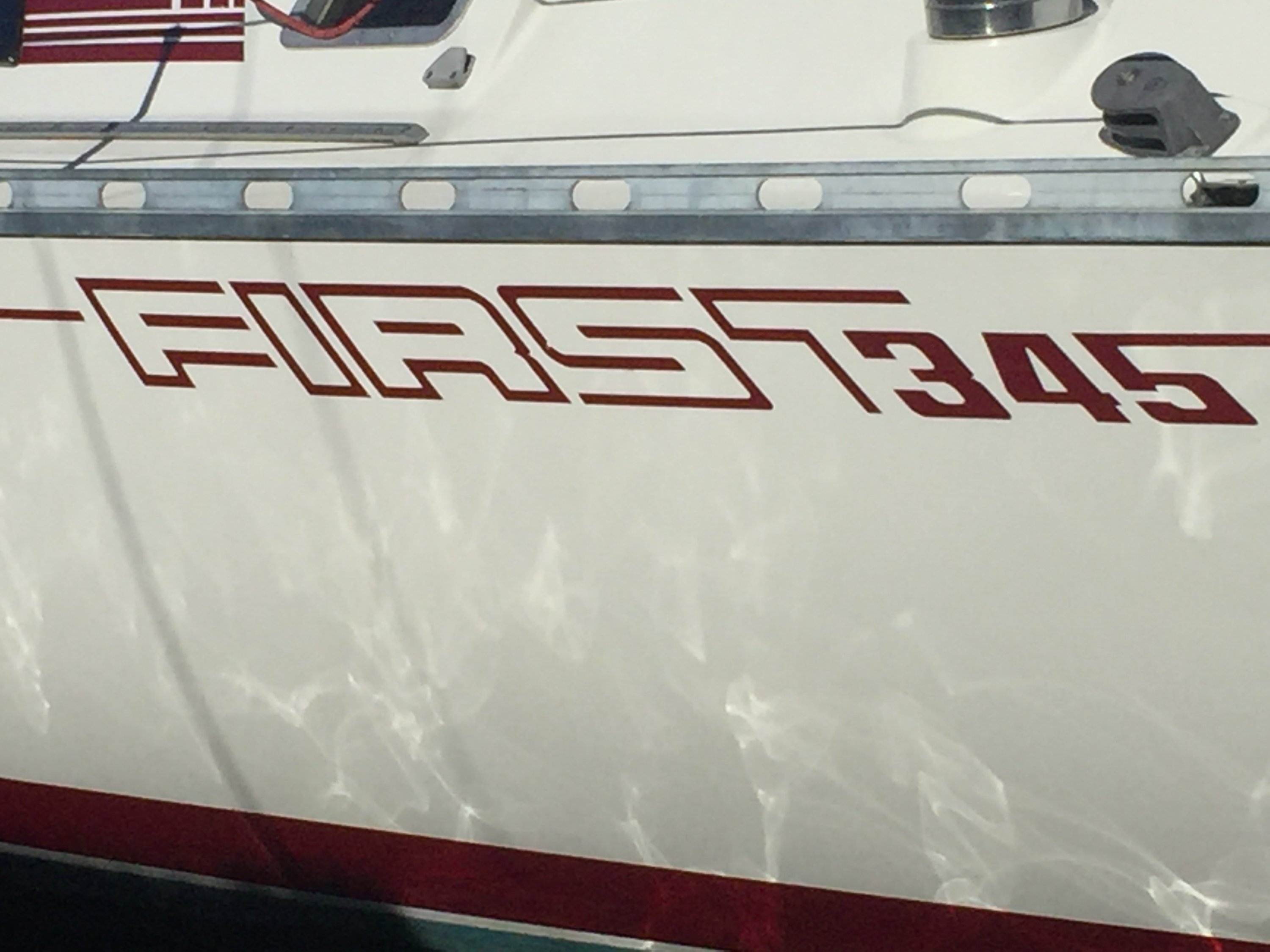

Shot in the dark here- anyone have a template file for the original topsides vinyl graphics ('First 345' in 80's futuristic font per picture). Looking to restore on mine.

I would think a automotive decal shop would be able to reproduce the graphics you need.
The next step is to remove the old graphicsMy son a device called a decal eraser to remove the grphics from his boat this spring.The eraer looks similar to a sandng disc attached to an electric drill.It is a dusty job but doea not damage gel coat or paint. (I am in Canada and purchased eraser from Princess Auto}

You might try these people. They are in the UK. I just Googled for your question.
http://www.naughtygull.co.uk/beneteau.html

This website looks promising! thanks, I've inquired with them.

Received my new peel and stick graphics from the U.K. Today from Naughty Gull, thanks for the tip they should look great!

I am in your neck of the woods and have the aforementioned wheel to remove the vinyl tape with leftover. I removed some of my tapes and the wheel is a fantastic tool to do it with. The wheel has a lot of material left so just IM me if you want to use it.

The vinyl tape comes off very easily with a heat gun. Just heat the area up and they will peal right off. I did it last spring when we change the hailingport letters.
