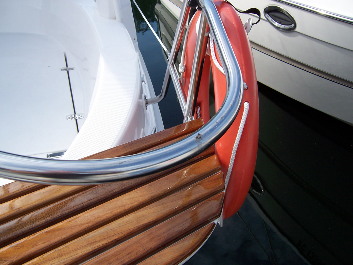

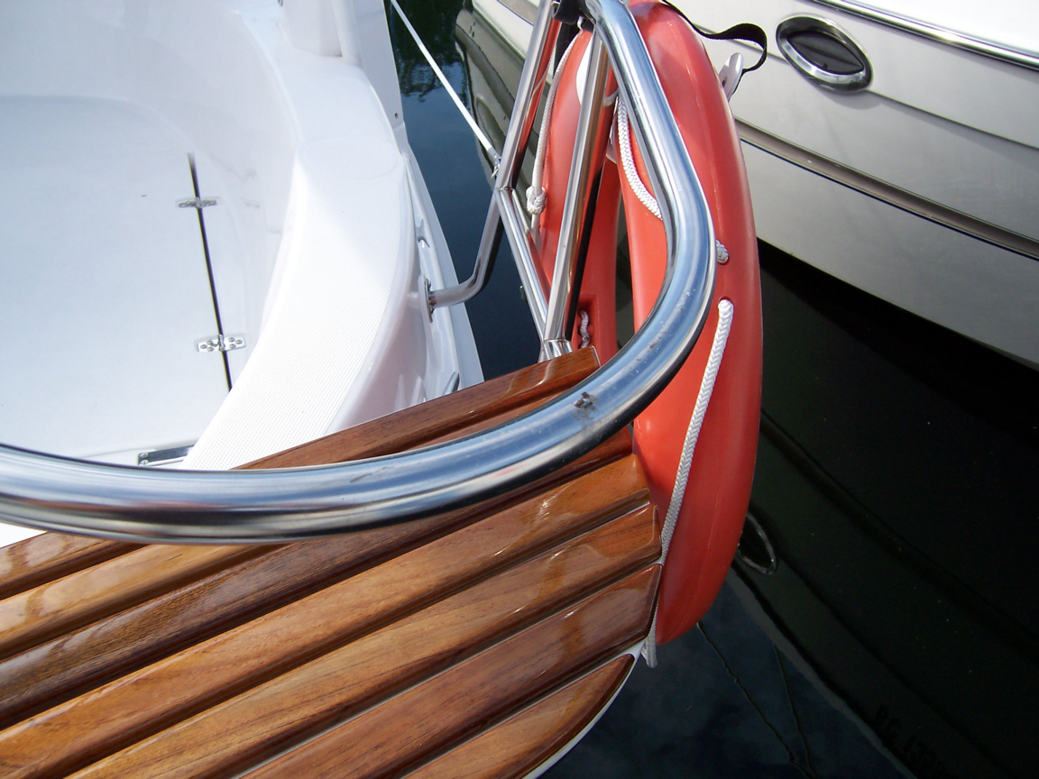

Here are my stern seats with five coats of Silvertip epoxy and three coats of exterior gloss varnish and ten years old. Covered when not in use but they still see plenty of sunlight and no deterioration :

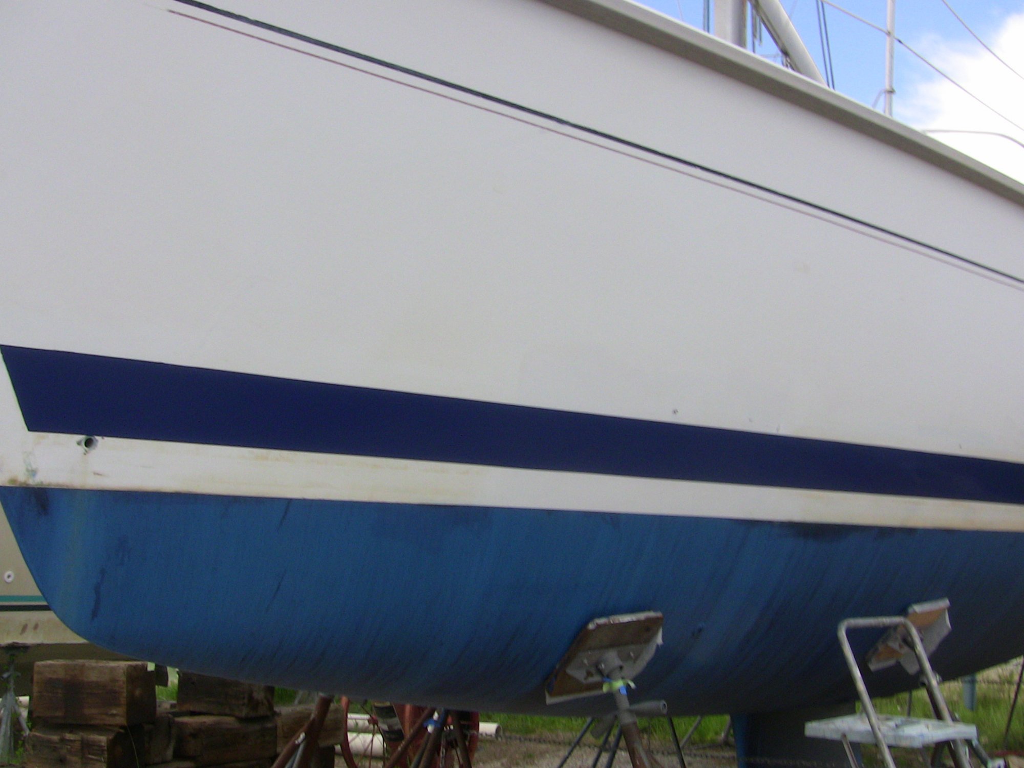

My boat's exact matched Gel Coat Hunter Blue 1998.
Before.
After.
Jim...
PS: Their White Gelcoat matched too.:clap:

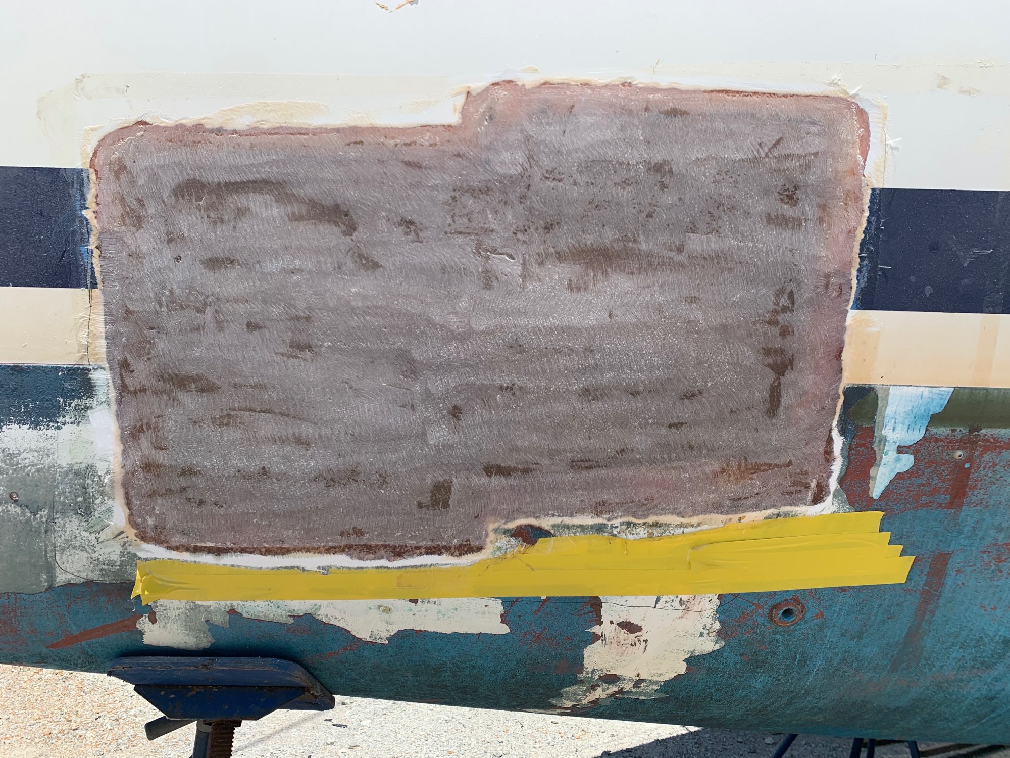

This the real Before picture after damage repairs.
Well done by my boat yard. :clap:

Regarding your stern rail seats, those are gorgeous! I sanded mine down and applied 3 coats of teak oil, and 4 coats of varnish. I think your epoxy repair gives them a much smoother finish than mine. Did you take each teak board off, dip it, and re-attach them?
Exactly, almost. Removed each teak strip and gave it five coats of System Three Silvertip clear epoxy and three varnish on the topside and one varnish on the bottom. The real trick is to seal the back where the screws go into the teak's pilot holes. I used GE Marine silicone (all right you purists, settle down, settle down !) as the silicone was going to be sealed off from the elements and UV.
