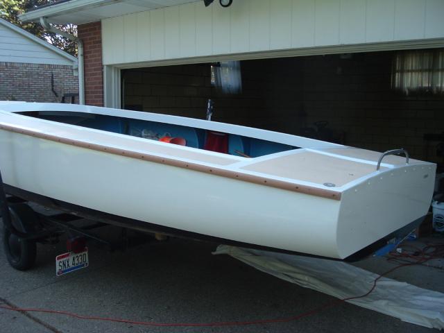

I used a weenie roller and the sooner it's tipped after roller application the better. It's really a two person job. I was tipping immediately behind, like one roller width at a time, right away. Direct sunlight is a negative factor too.
Here's the finish I was able to achieve. It's not spray gun quality but better than it was.
