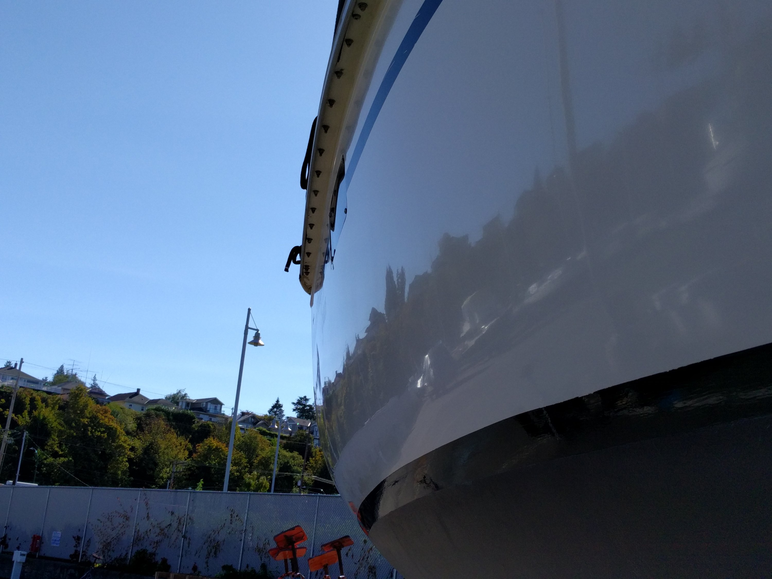

When on the hard for a bottom job our chalky 30 foot 1989 Hunter took 2 days to wet sand and then polish. I used 800 grit then 1,000 grit before I compoundedView attachment 143130 it. See the photo. This was before I put wax on her.
Follow Main Sail's technique. Here is a link:
https://forums.sailboatowners.com/index.php?threads/tips-for-a-great-buff-wax.117266/
You may as well make it look new.
Ken
Ken, thats very kind, were you totally happy with your efforts? You used a rotary sander or hand sanded?
Hand sanded usung a kitchen sponge for a sanding block. Machine compound then hand wax. I'm not totally happy because I need to do the topside and haven't done it yet.
