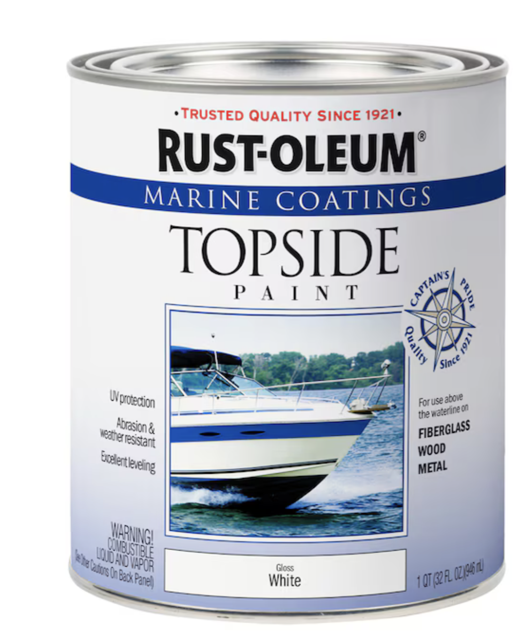

Can anyone recommend paint for a deck that had a non-skid surface placed on it (like your home shower or bathtub) by the manufacturer? Can I use regular topside paint? I don’t need an additional non-skid surface, just paint (color), thank you!

If the pattern is deep enough you may get away with just painting over it. A one part polyurethane paint like Total Boat Wet Edge would probably work best as it is thin and does not build up like an enamel paint. It will take 3 coats to get good coverage. Petit and Interlux make similar paints. If the pattern is really worn, then removing the pattern is really the best option.

Topside usually refers to the hull above the waterline FYI.
I have painted many boats and polyurethane paints are best for color retention and abrasion resistance, but are very expensive - especially if they are two part paints, which are preferred. Awlgrip is one company who offers great paints with a ton of color choices and you can roll or spray when using the right Awlcat additive. I'd paint the smooth surfaces first and then carefully mask off the nonskid surface and apply the nonskid color of your choice. I'd use a flattening agent and grit mixed together and constantly mixed. Glossy paint, even if there is grit, is still slippery underfoot - especially if wet. So, flattening agent is a must.
There are other products out there that provide nonskid paints ready to roll on out of the can. They have the grit are not shiny and have a lesser choice in colors, but work well.
