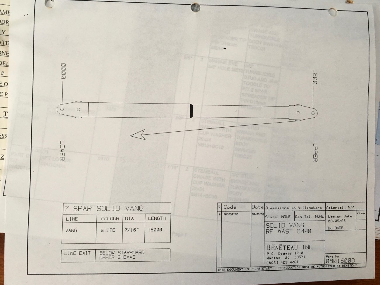

I am also uncertain whether the Z Spar rigid boom-vang can support the boom without the topping lift. It is currently being supported by a 2x4. Has anyone replaced the Z Spar or found a suitable part/spring/shock as an upgrade so the topping lift can be removed under sail?

My zspar boom-vang was not supporting ,I took it apart and dropped in about 1.5 inch delrin spacer and that fixed it. My buddies 375 boom- vang has holes drill thru every inch ( 5/16 ") and a pin so you can adjust the spring, that was my next step ,however the spacer seems to work

Thank you Mechone. It is a solid vang but I believe there is no spacer. The pic is from the original boat paperwork so I'm sure the spacing mechanism is what is needed. Not sure I want to start drilling holes in it yet but thank you for the tip.
Mine is identical ,so I'm sure it will work 1.5 at the vang will raise the boom quite a bit and you will actually start using the spring ,compressing it and using the clutch.You may need more or less of a spacer ,you will have to find your sweet spot,thats why I considered drilling for pin ,but for now the last 2 years it's worked great. I still have a topping lift ,but it is slack,I use it more when I put the mast up every year to support boom ,while I install vang

Take the rigid boom off and pull it apart, it is very simple and a SS spring will slide out. Measure the length and compare it to the US Spar specification. Likely it has compressed through the years. They will sell you a new spring for less than $100. That will get your boom back into the proper configuration. The job is an easy DIY project.
