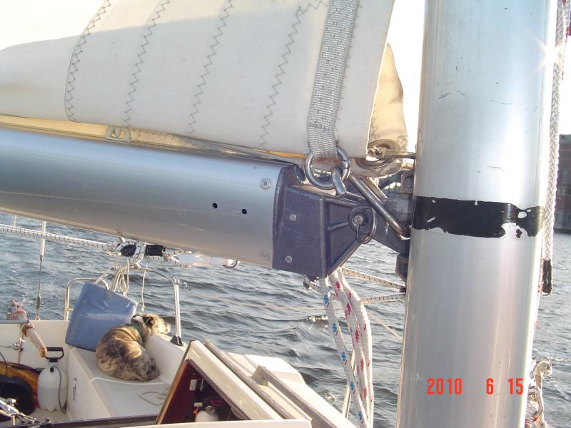

I have a add on piece that is kind of an eye. (PO mod...Sigh) It does work though. it has a dog leash clip to attach to the boom from the rope. I'll try and find a pic...
Ok there it is. I forgot there is a removable steel link. I would suggest not using steel as it rusts. (Sigh)
