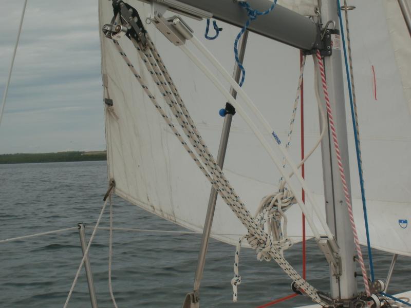

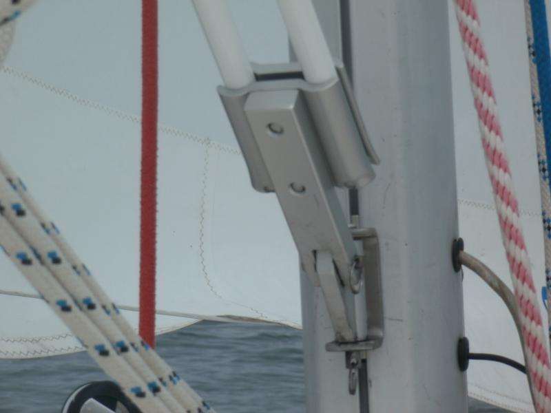

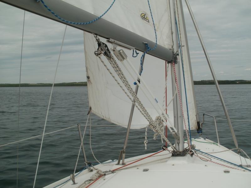

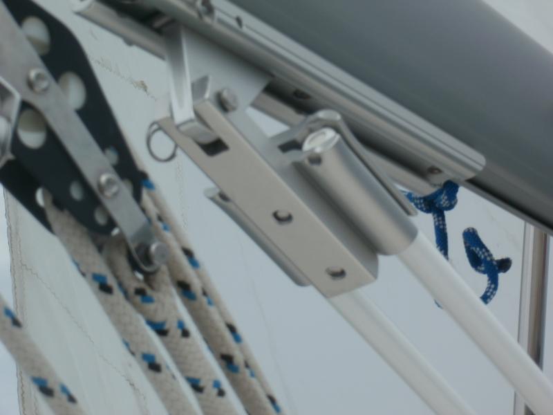

Just installed a Boomkicker. Extreemely easy to install, works as advertised and no more topping lift issues.
Check them out. Here are some pics of my install
You should post those pics on the other thread, also. I'm clear on the whole thing now.
