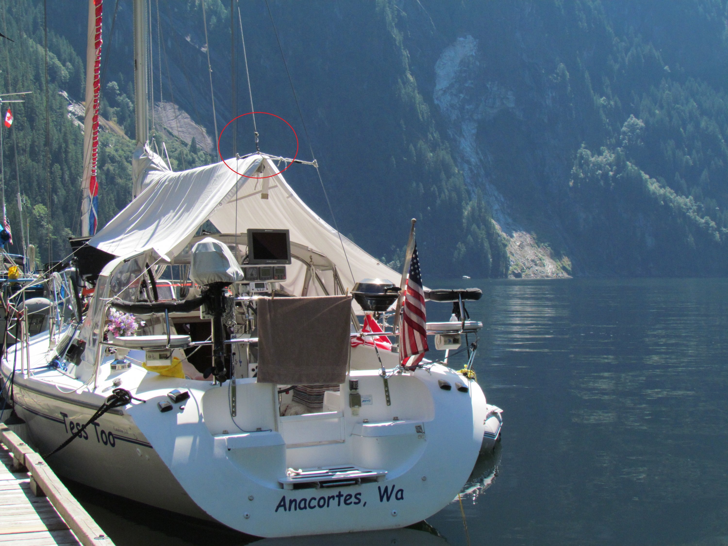

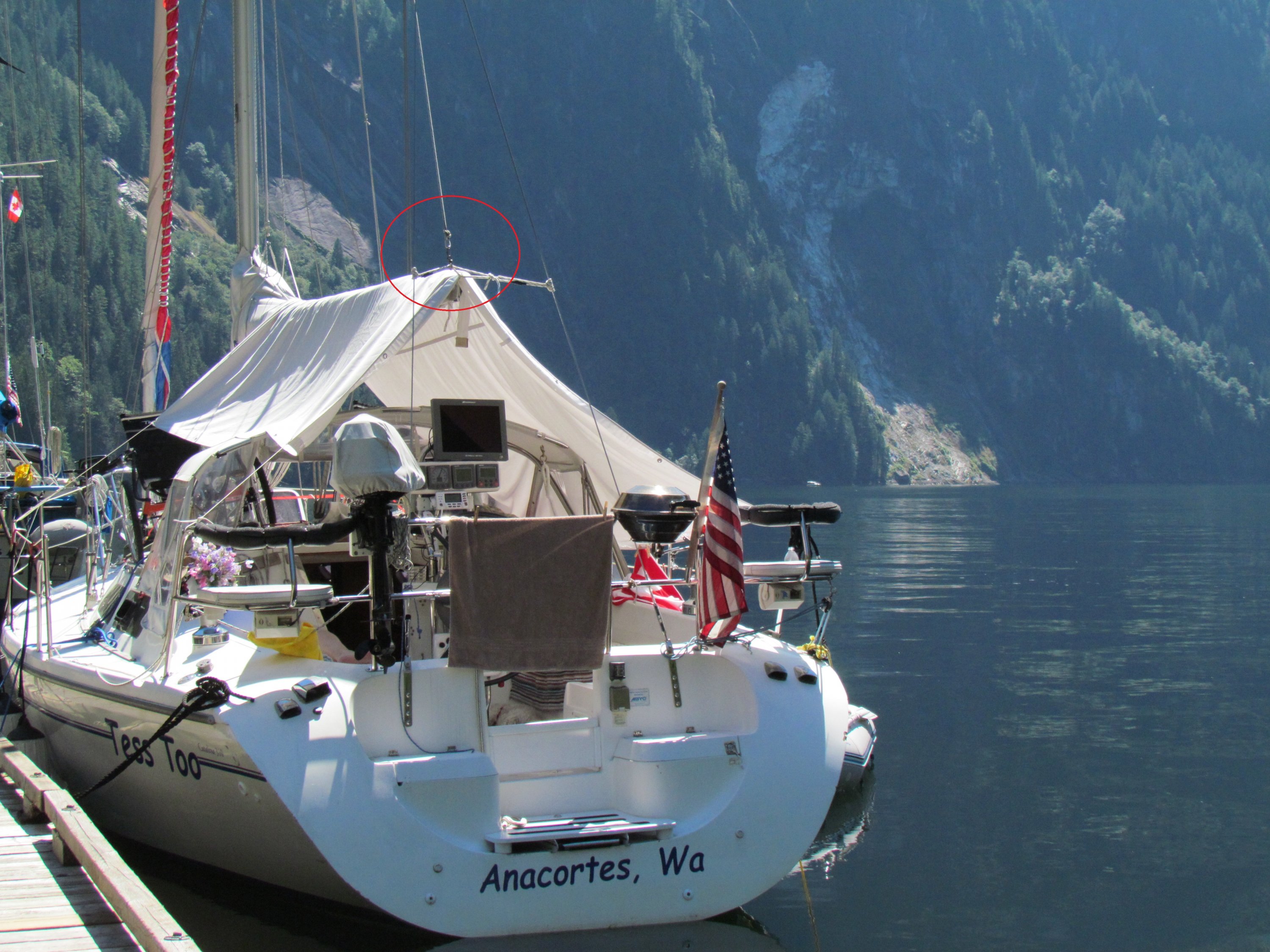

You can get along without it. No doubt. But unless you have a racing boat and are really concerned about weight aloft, it can be useful. It could be a spare halyard assuming that it is led around a sheave at the masthead to a cleat at the bottom of the mast. Or a way to lift something heavy aboard - like a dink. Maybe hold a shade up in the cockpit. Be a halyard for a riding sail. As was mentioned, support the boom for MOB recovery, or haul that giant tuna aboard. Maybe it could be use to kedge the boat off a grounding. Maybe support someone climbing out on the boom to heal the boat over to get off a grounding. Maybe a safety line for ascending the mast or a messager for tools. It seems to me that a line from the masthead is a useful thing.
