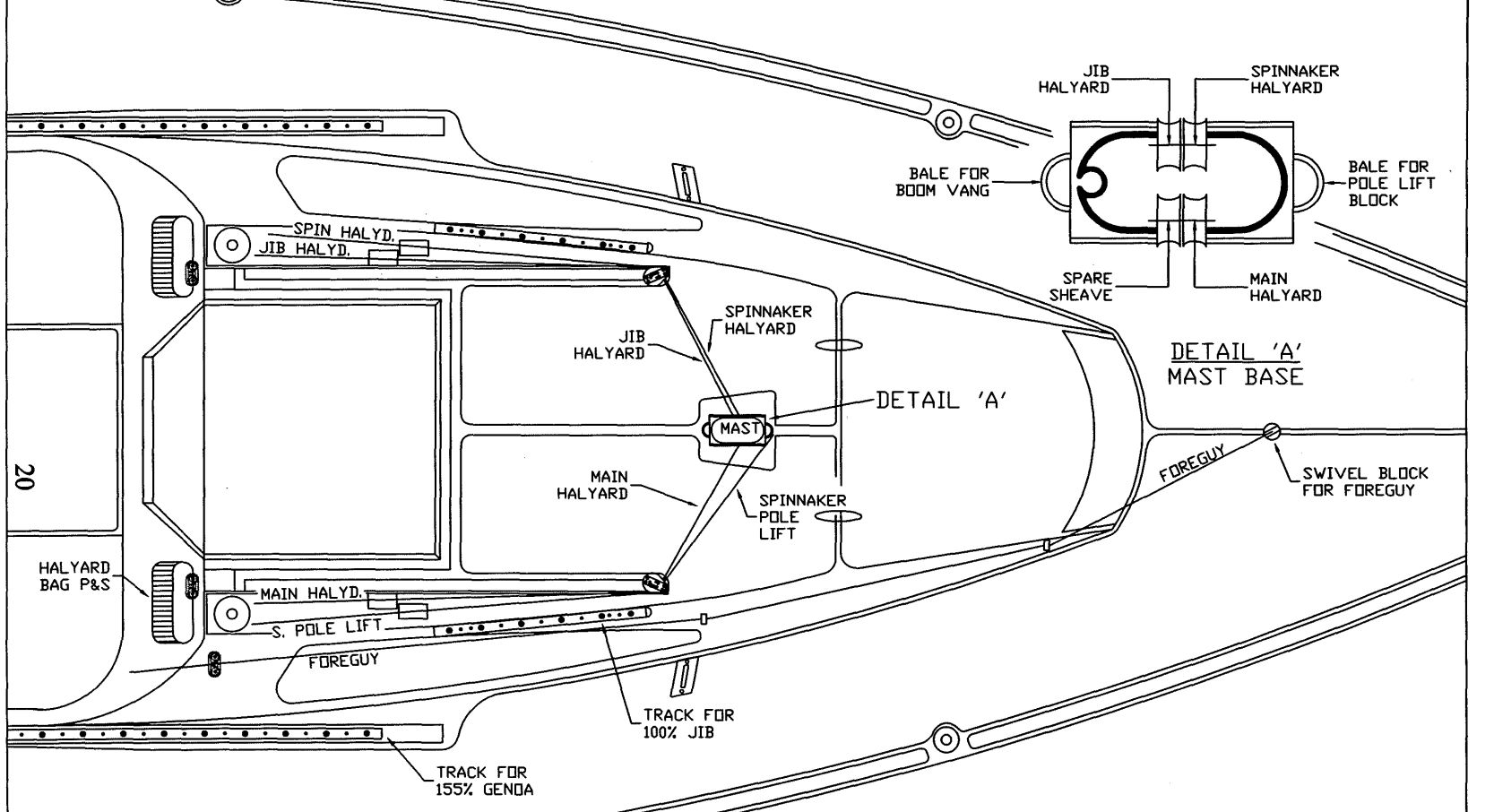

Just looked at the owners manual, they show the pole lift running aft. I think I can just attach a block at the base of the mast to run it back.

Yes that can work. Some folks get fancy and run the line through a rope clutch. Some folks use a fairlead and a cam cleat. And a few of us old guys install a cleat.
Your boat your choice. All are good options.

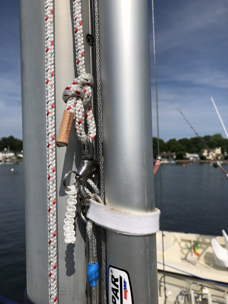

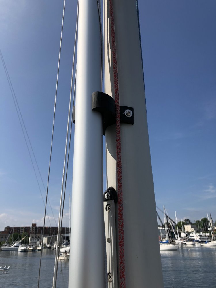

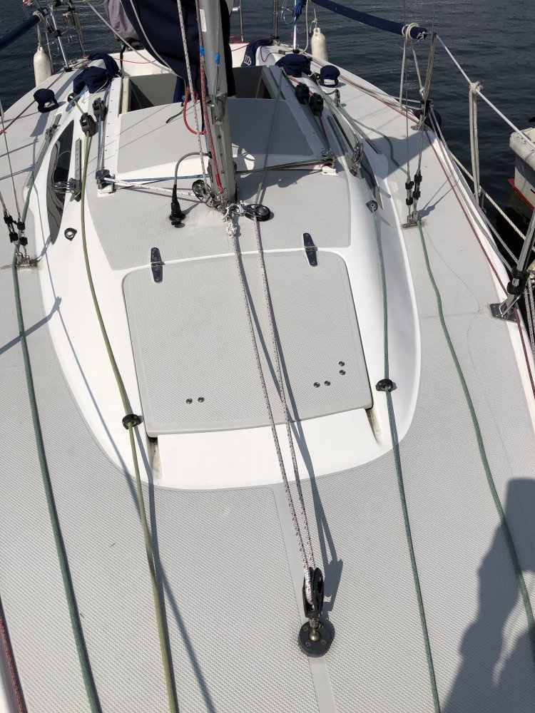

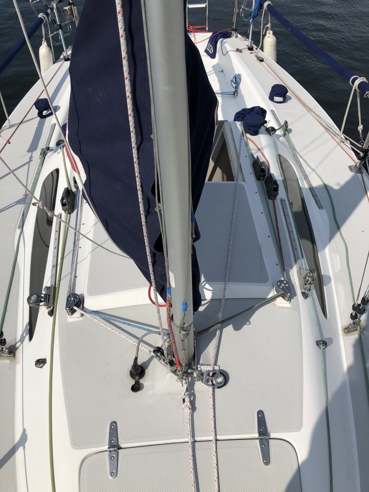

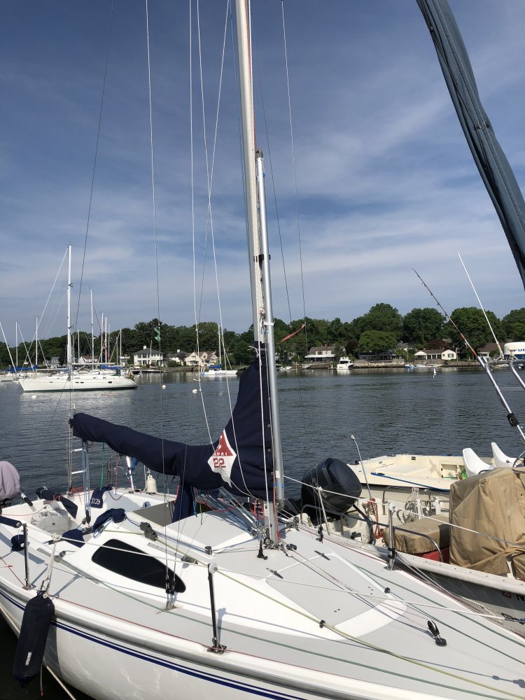

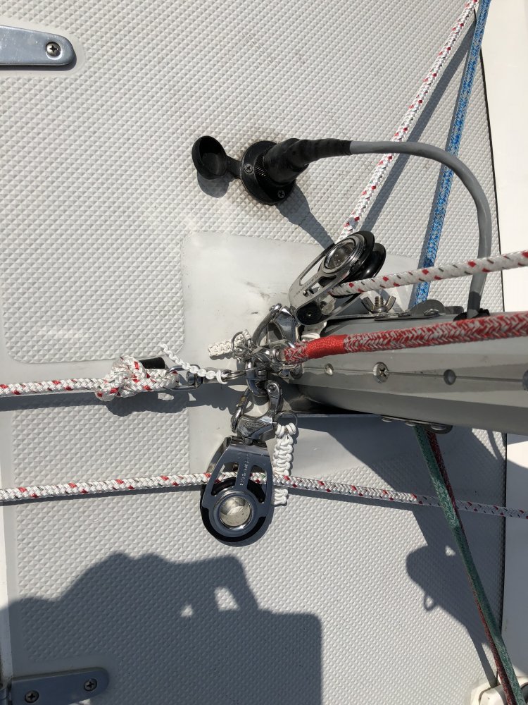

@Slartibartfass those are great images of your Capri 22. Good looking boat. Hope they can help @pointbreak805 as to how a boat can be rigged. You have fairleads that guide your lines back to the cockpit. Nice.

Hey @pointbreak805,
Wow, forgot there was a manual, thanks for the reminder. My setup is by the book, almost the same as @Slartibartfass though not as pretty. He's commandeered the stock downhaul/foreguy routing to serve some other purpose - probably a bow mounted harpoon gun or some other cool add-on.

Hey @pointbreak805,
Funny... the foreguy/downhaul is for the whisker/spinnaker pole and the yellow line is for the adjustable bowsprit that I can install at the front and adjusts the height/tension on the additional furler for the asym/drifter sail that I can install on there (both on furling units)....
