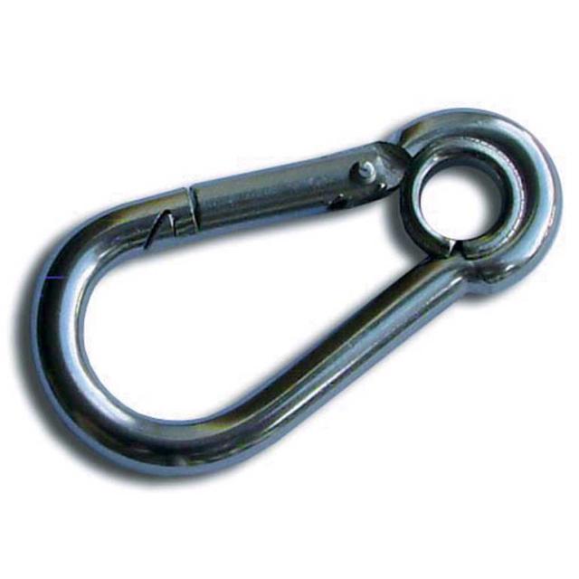

I put a light line from each end of the traveller and attached to the bail on the underside of the boom with snap hooks.
Only use it when I leave the boat. Between times just leave enough slack in the mainsheet to stop the vibration.
Remember to take unhook them before going sailing!!!
