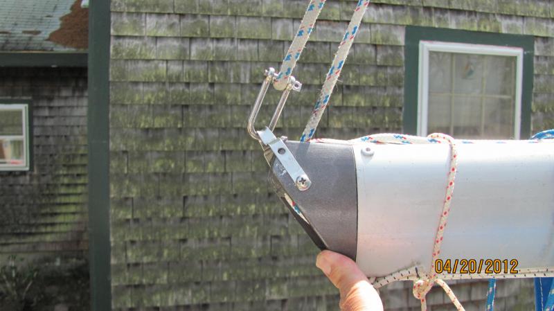

On my 23.5 I cut toppig 1 ft above boom,tied a 1/2 D shackle to each end,this way line can be attached to mast when lowering boom,and shackel wont pull thru boom.That way boom is out of the way when raising and lower mast.Store boom and mast raising pole in pipe bolted to trailer,saves intereor damage.Not pictured I put a leather sleeve around shackles to prevent wear on main.
