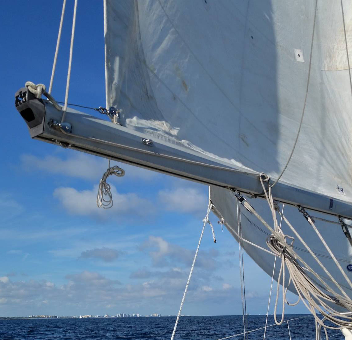

My horn cleat is on the boom, but that sounds like a great idea. I will work on the preset lengths this weekend and will add the loops so that I don't have to keep adjusting the topping lift length every time I hoist or drop the sails. Thanks

SM,
I didn't like my hokey topping lift setup either.

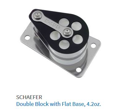

I purchased a base mount block near the end of my boom (see pic for an example).
I used a double block but a single block will work just fine.
I then installed a power clutch forward near enough to the boom to allow for adjustment
while lifting and/or dousing my main. (see pic for an example).
This has worked great for me. I don't have a boom kicker, I use a mechanical boom vang.
I have had no topping lift problems since.
