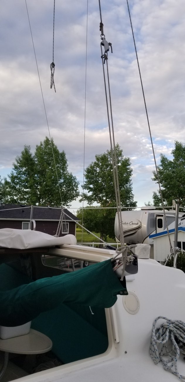

I don't run my topping lift through the boom to the mast. The line is tied at the top and hangs down and terminates a couple feet above the end of the Boom. There is a sheave with a clamcleat there. A line tied to the end of the boom goes up over the sheave and into the jam cleat. That way I can adjust it standing in the cockpit at the end of the Boom. It wasn't my idea, it came that way when I bought the boat used, but it's worked well for me for 17 years now.

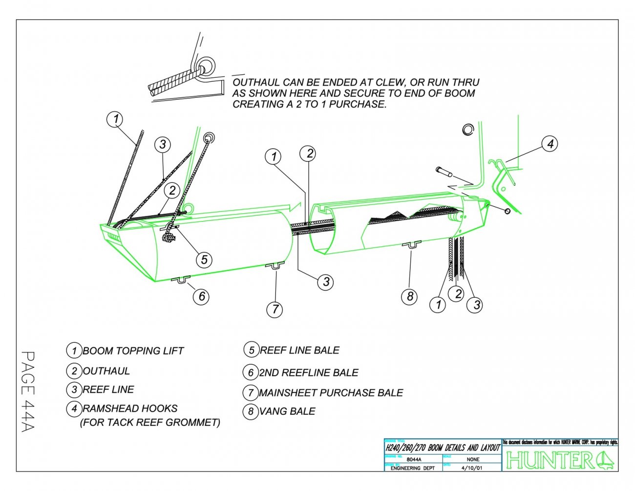

The 23.5 manual doesn't have a very good diagram for the boom rigging, but the 240 does. It is the same.
The topping lift is in two parts, the line you found already tied to the masthead, and a 1/4" line running thru the boom. The carabiner allows you to disconnect the mast and stow it down without having to pull the line out. The lift is adjusted at the base of the boom and the jammer used to secure. This is a little cludgy but it is the original design.
It doesn't sound like your boat came with the optional deck mounted topping lift, but if it did, there would be a mast entry on the left side of the mast near the base, a mast exit near the top, and a sheave just below the masthead.
This sounds like a great setup, Rick. Do you have any pics?

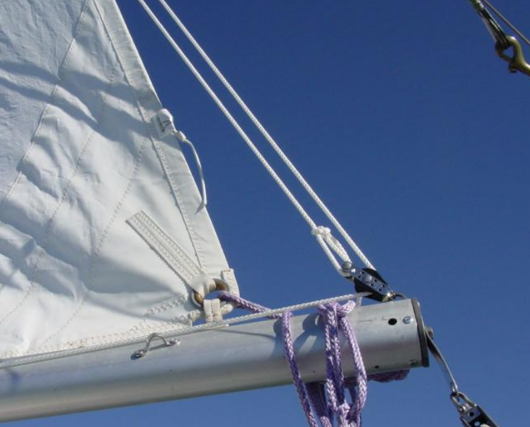

Similar to Mr. Macdonald's setup, but starts at the becket, goes up to the sheave hanging a couple feet above the boom then back down to the block with becket, then forward along the boom to either a clam cleat on the boom or routed to the mast, down, out and back to cabin top.

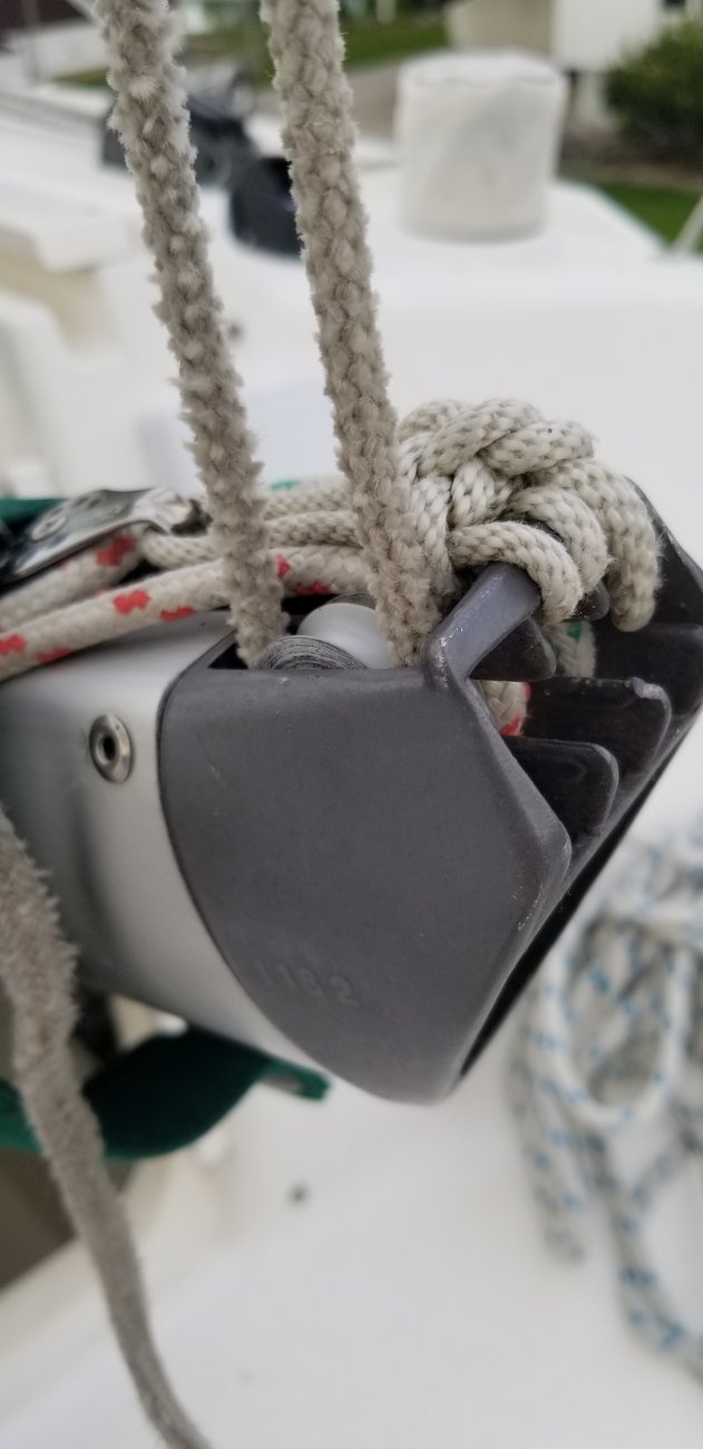

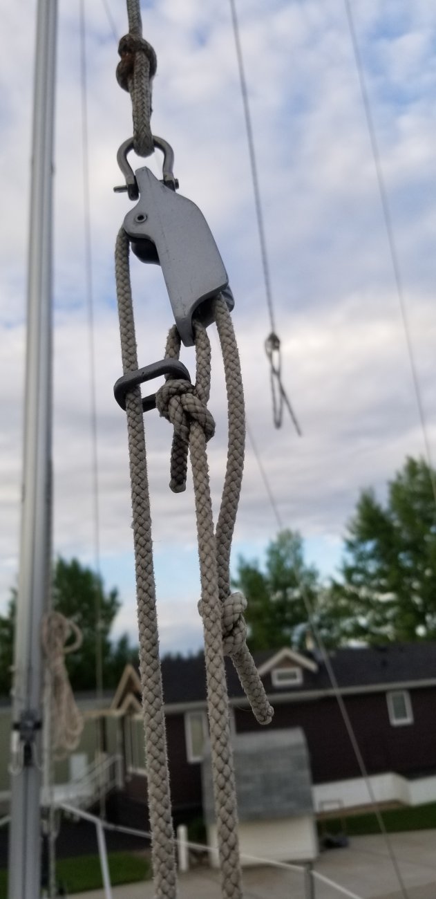

I've attached some photos. Note another nice thing about this setup is that if you connect the topping lift to the end of the boom you can walk the boom out from down below, if that's where you happen to store it for the winter LOL.20190612_204926.jpg 20190612_205004.jpg 20190612_205037.jpg

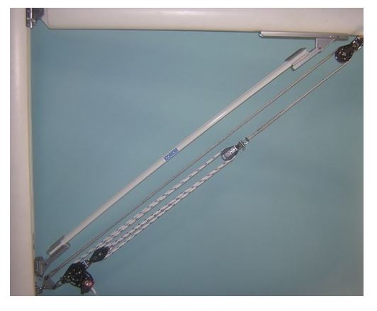

I've never seen one up close. With the main down at anchor or in a marina, what keeps the boom from swinging back and forth?
From what I have seen you center the mainsheet traveler and then tighten the sheet, same as if you had a topping lift. I don't have a boomkicker myself, but I wonder what you do if you want to raise the boom while in the cockpit for more headroom, in the absence of a topping lift.
