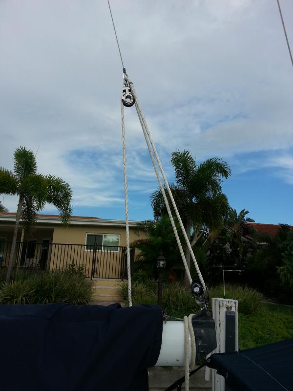

Is the topping lift line (wire or fiber?) still attached securely to the mast crane, and is the shackle attached to the lower end of the line? If so, and you have a spare sheave at the aft end of the boom and matching spare jam cleat at the front of the boom, you could run a line through those (or maybe there is already one in the boom) and up to the shackle on the topping lift. On my 23, I shackled a small swivel block to the end of the topping lift, after having shortened it so it is maybe 3 ft above the boom. The topping lift adjustment line runs up from the sheave in the boom end to the swivel block, and back down to be tied to the end of the boom. It is then easy (if you are up near the mast) to adjust the boom position, say after you drop the main.

A block with a becket and cleat will work. attach the becket to the topping lift. Attach a line to the boom end, run it through the block and down/back to the cleat. Run the boom end line from top to bottom through the block to give a fair lead to the cleat.
