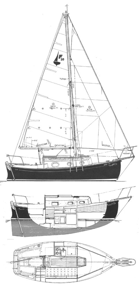

Hello!
I was wondering what the top speed of the Flicka 20 via motor in the ocean (1-3 foot waves).
Thanks,
Elliot
