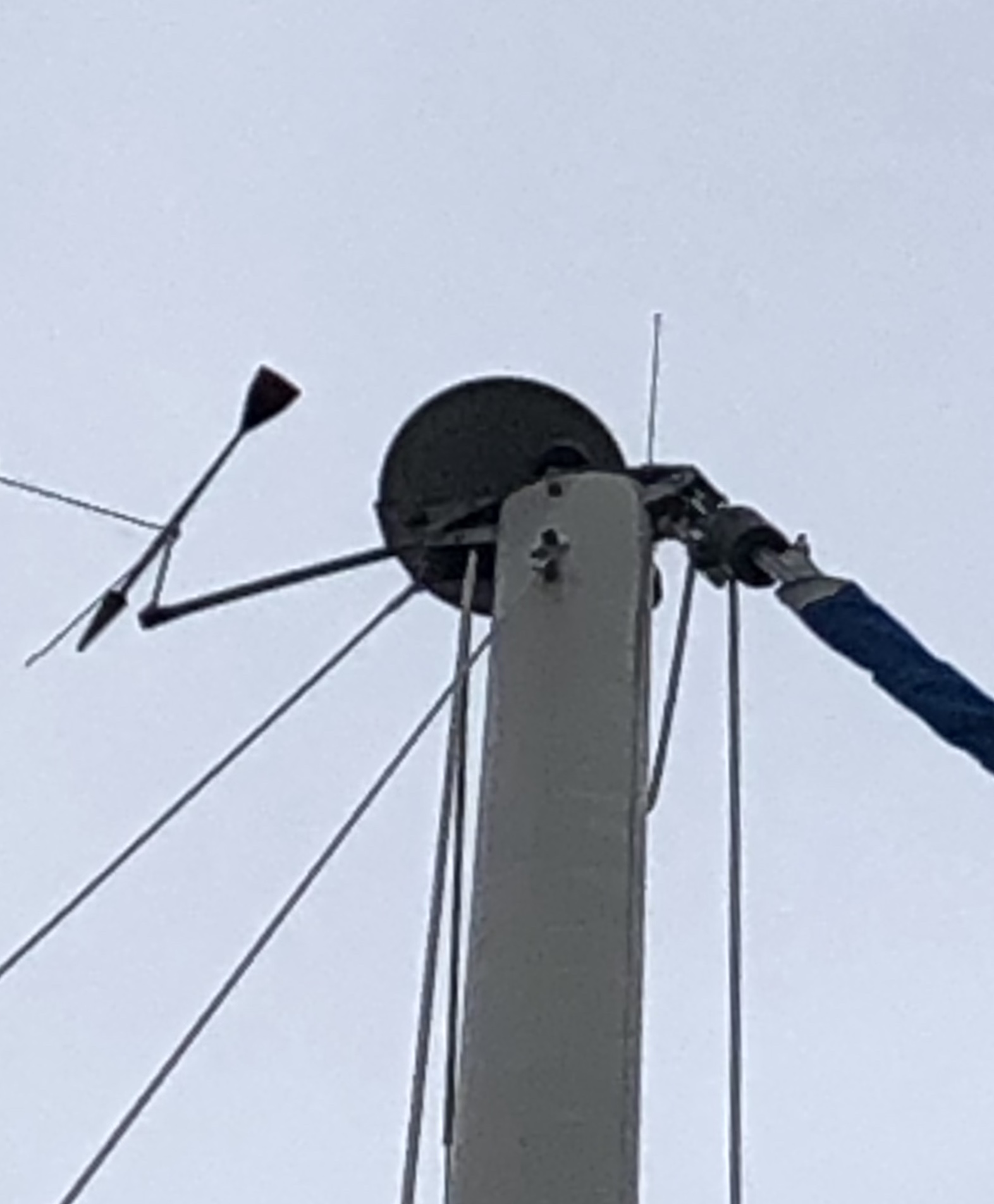

I’m putting a wind vane transducer on top of my mast. The transducer comes with cable to be run down the inside of the mast and the package includes a drill bit and a couple of sheet metal screws to secure the thing to the mast top. To cut to the chase, does anyone have a photo/description of the top of the mast on an O’Day 28? Don’t want to get up there and discover I need xyz drill, tap and screws. I’ve attached the best photo I have but which doesn’t tell me much. The dish on top is a tv antenna which is coming down.

It looks like you might have a Kenyon spar, and looking through the Kenyon spars on the Rigrite website, perhaps a 3756. This link should show the possible masthead(s) which may give you an idea of what you will find.

i lost pictures of the top, but it is a simple casting with bump on one side for the anchor light. Originally intended for two external halyards, I now have 5 lines at the top, two main, two jib. Do you have a masthead crane (spinnaker block)? Good opportunity for that control to be added also. I did find a CAD sketch:

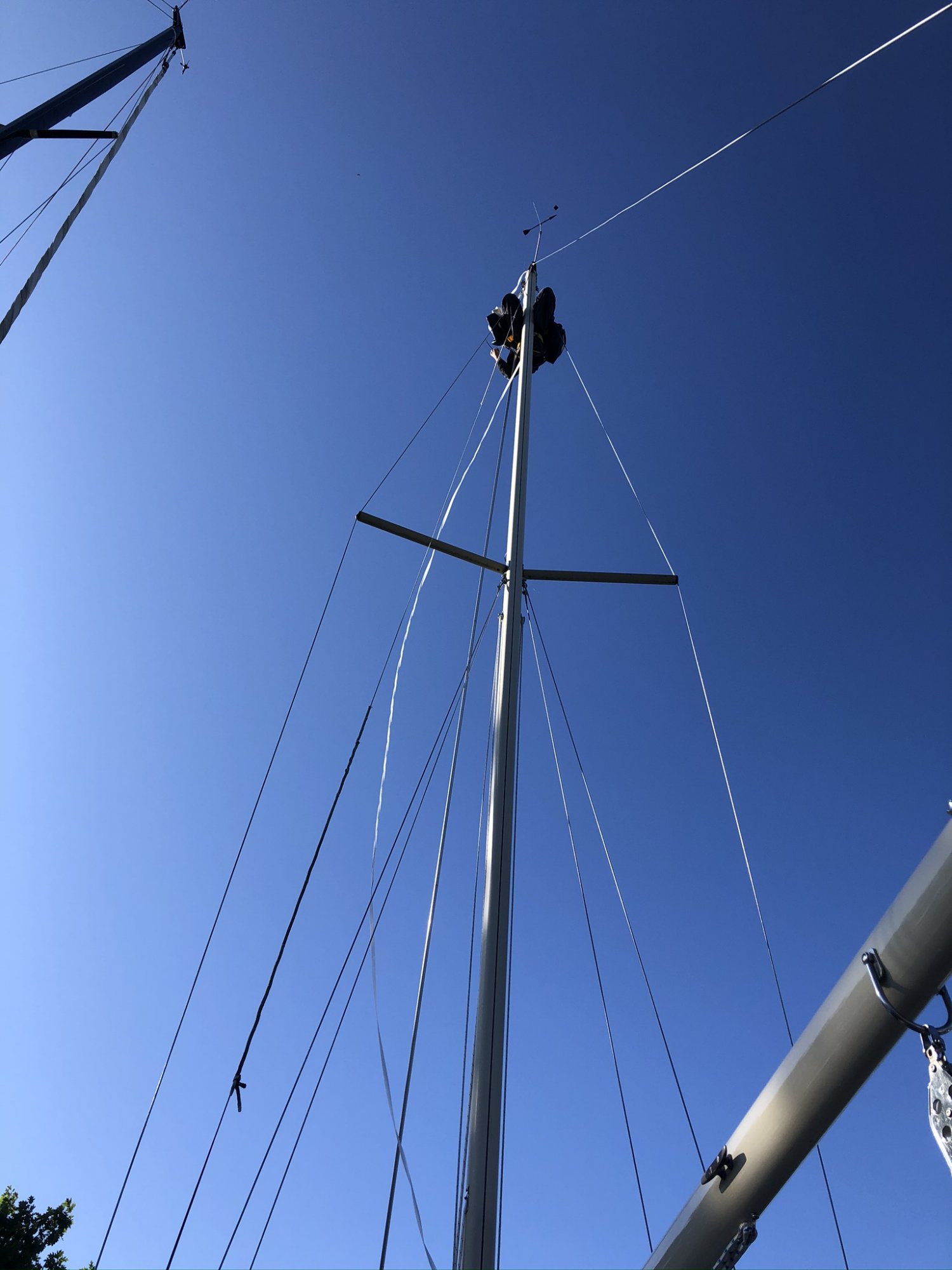

Well, after standing on deck staring at the top of the mast while getting dizzy (and my mast isn’t nearly as tall as some others in the marina) I had a local marina send it’s mechanics to climb the mast. My marina doesn’t provide mechanics. $95 per hour for two hours was well worth it for me. They removed the inoperative tv antenna and used that cable to pull the wind transducer cable through the mast. They also drilled and tapped the holes for screws. Oh, the guy at the top of the mast has done this many times. He said the fixture on top of the mast is cast aluminum, not sheet metal. Thank you all for your replies.
