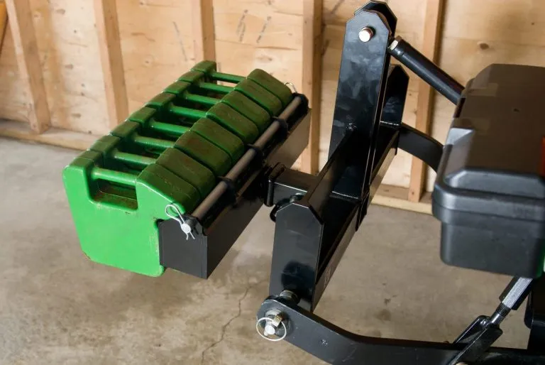

That seems like over kill and a lot of work. There are a lot of easier ways to add weight to the front of your trailer. Moving stuff around in your boat would be my first approach and if that is not enough, just add actual weight plates to the front of the trailer. They sell weight plates for tractors. Try going to the local John Deer store and get one to bolt to your trailer. You probably only need to add about 50#. Of if you want to go low budget, shop craigs list for someone selling their exercise weights. The figure a way to secure it to the front of your trailer.
