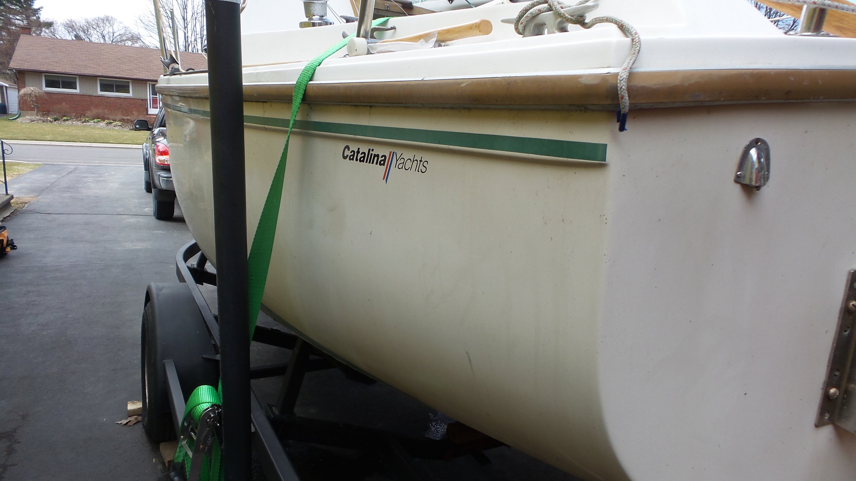

Here's a shot from when I bought the boat. You can just see the old cut cable sticking out.

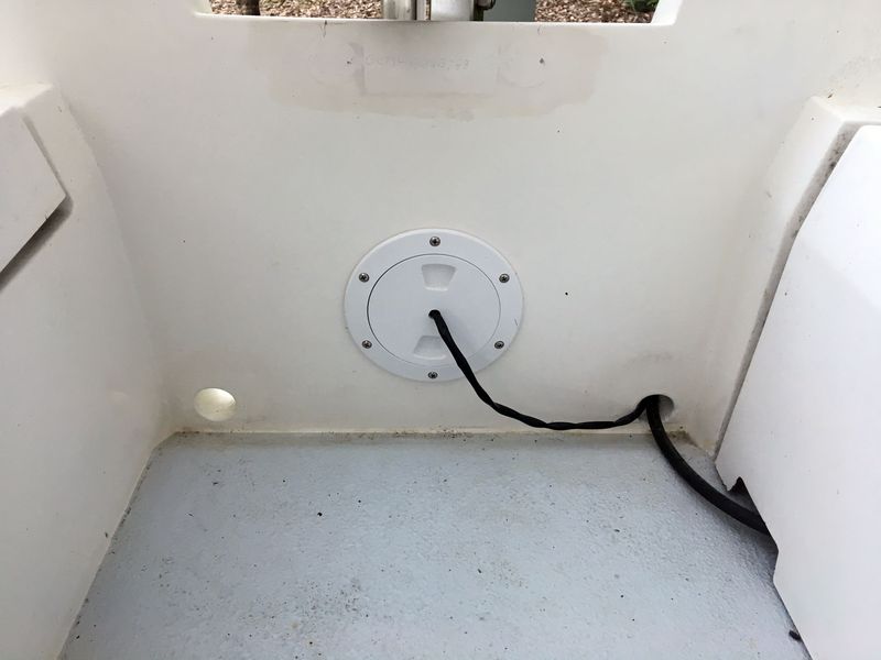

I'd like to drill a hole in the transom, to run the battery cable though like shown above, but I'm a little leery of drilling holes in the transom. Is that how most C22's are set up? I might decide to take the plunge, it would make it a lot cleaner.

Fuel line on the new designs is run like Gene's Photo above. The fuel primer bulb on the external tank that came with my tohatsu is a tight fit, but it works.
Why are you worried about drilling a hole in the transom ?
@Gene Neill solution would work great if you don't want to do that.
I assume he has some type of connections behind the access cover so that the cover can be fully removed easily, if not it's only a slightly longer run to the factory battery location where the wires would end anyhow.

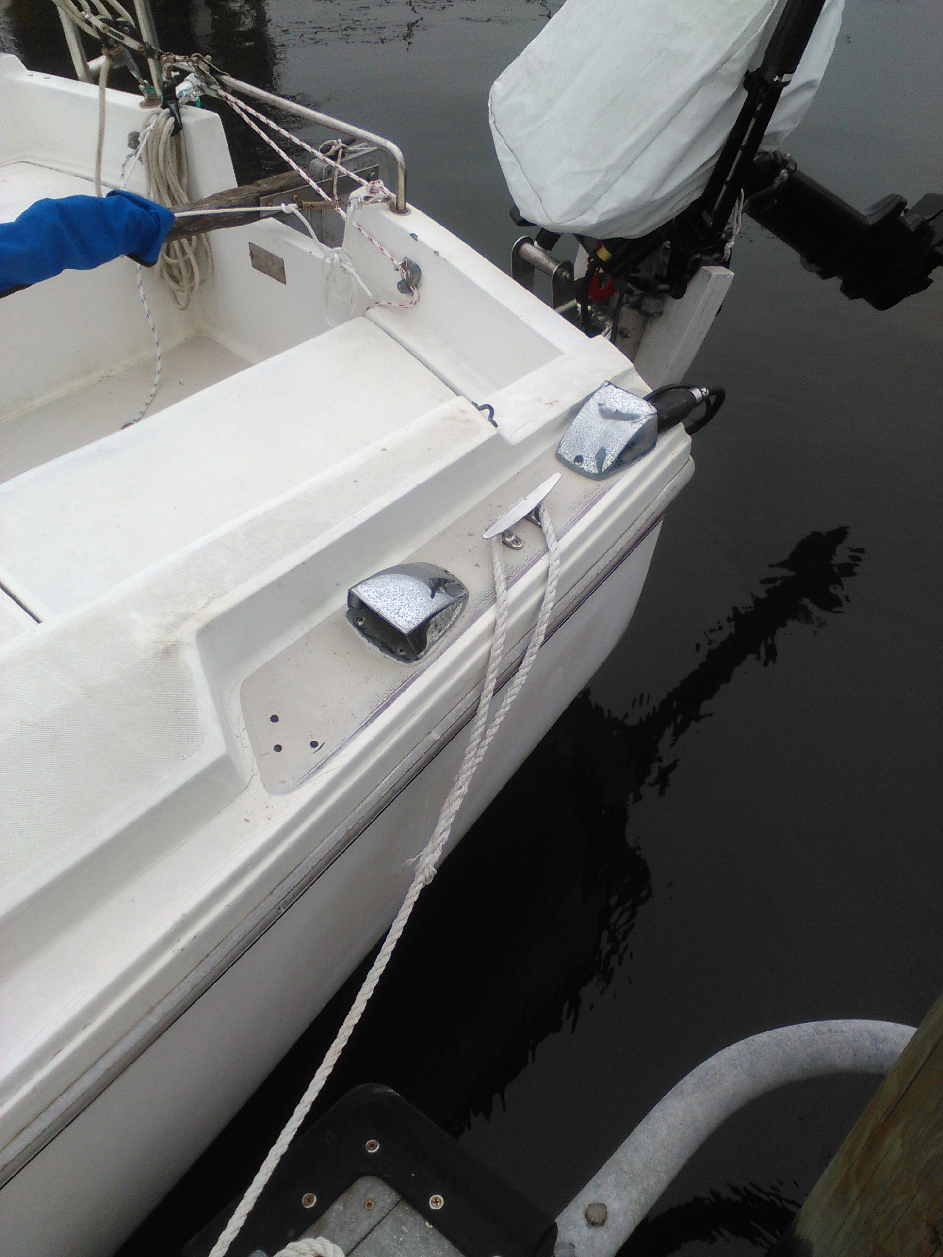

On my C 22 the fuel line and alternator run out of the lazarette thru the aft vent for the compartment as in pix, also I put a piece of window screen in each vent to keep out wasps not run off by my old sock with 3 moth balls in it tossed into both stern compartments and the v berth area.

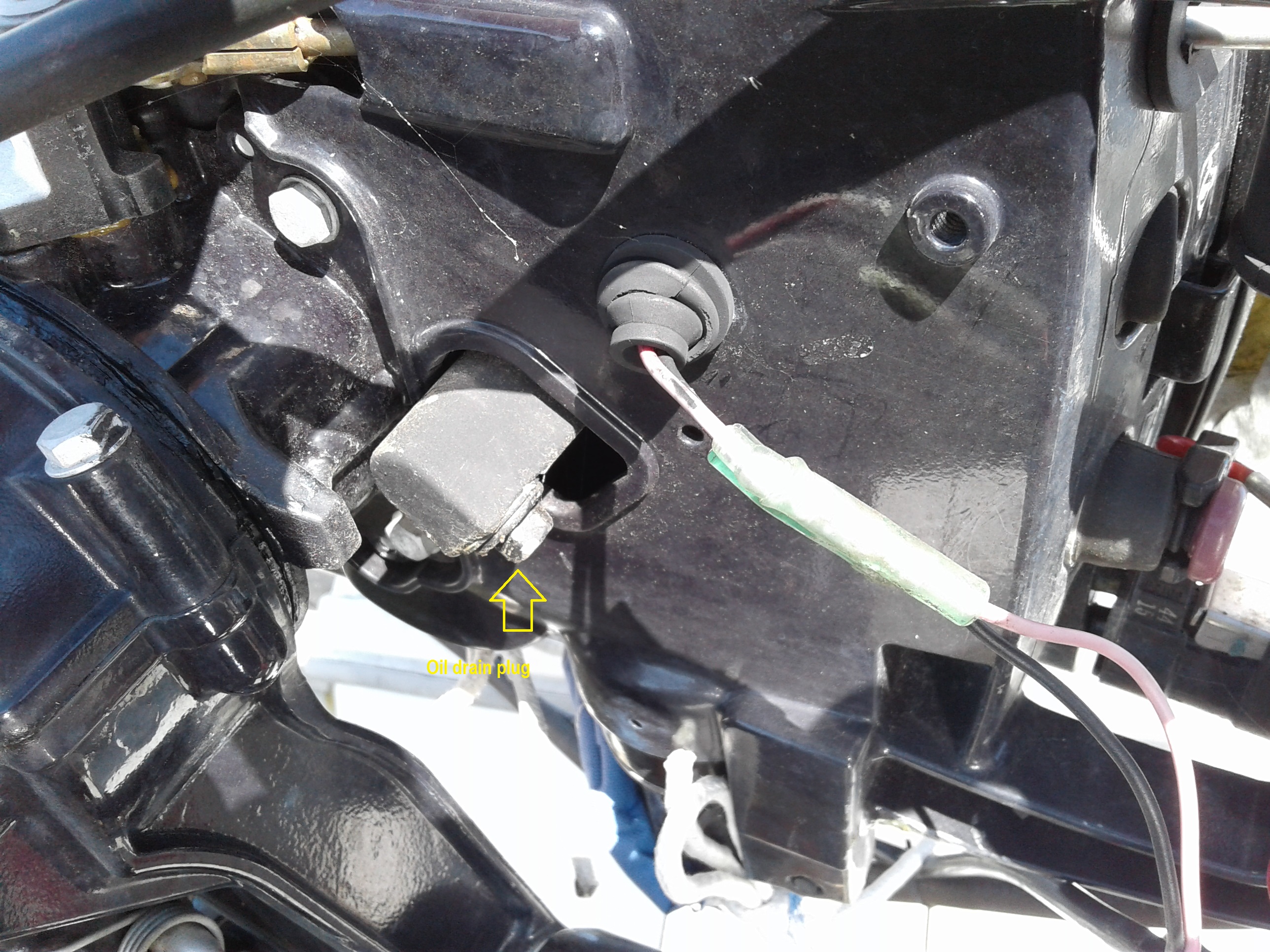

By the way the more interesting thing is the search for the oil drain plug for the crankcase on the tohatsu sama!
