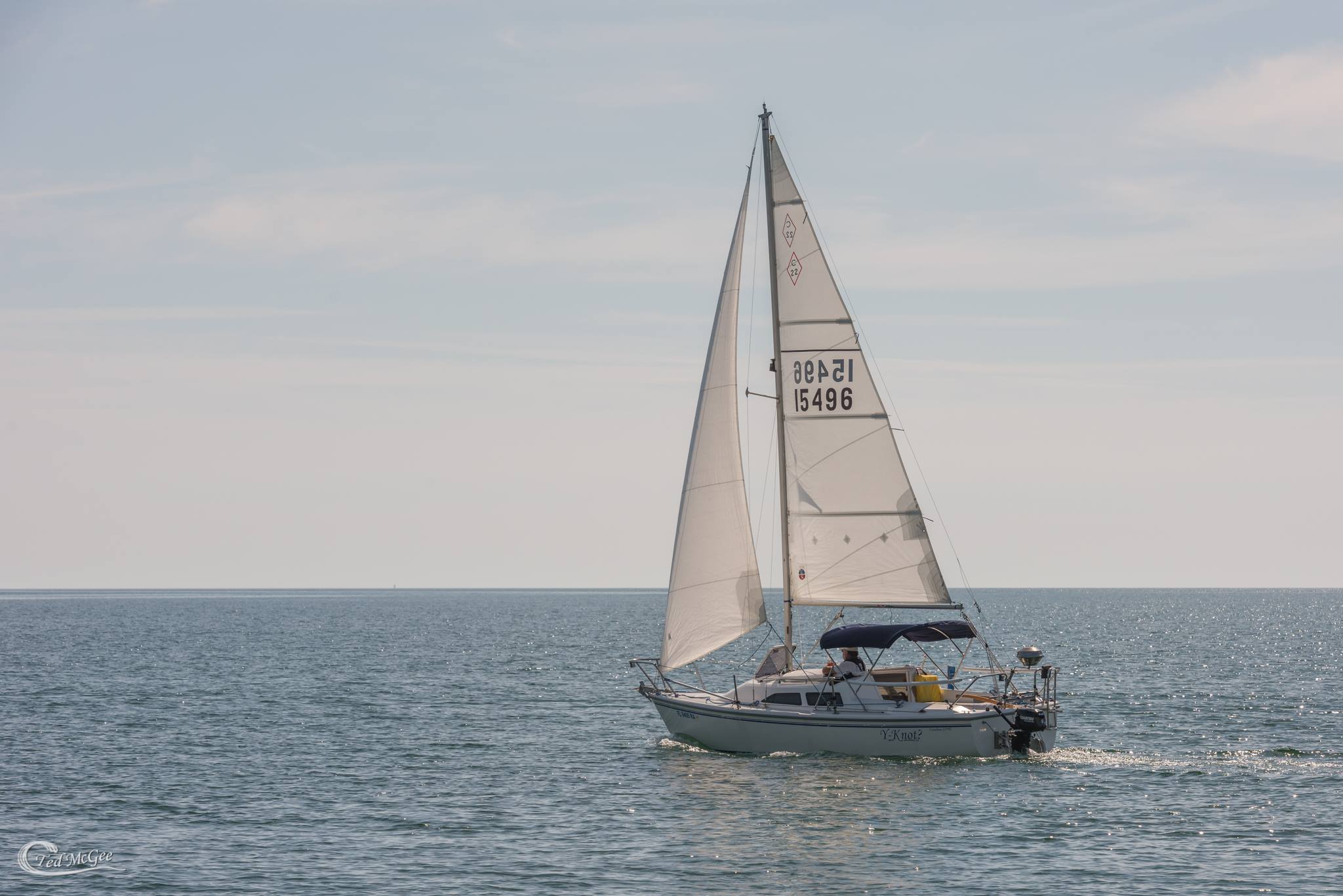

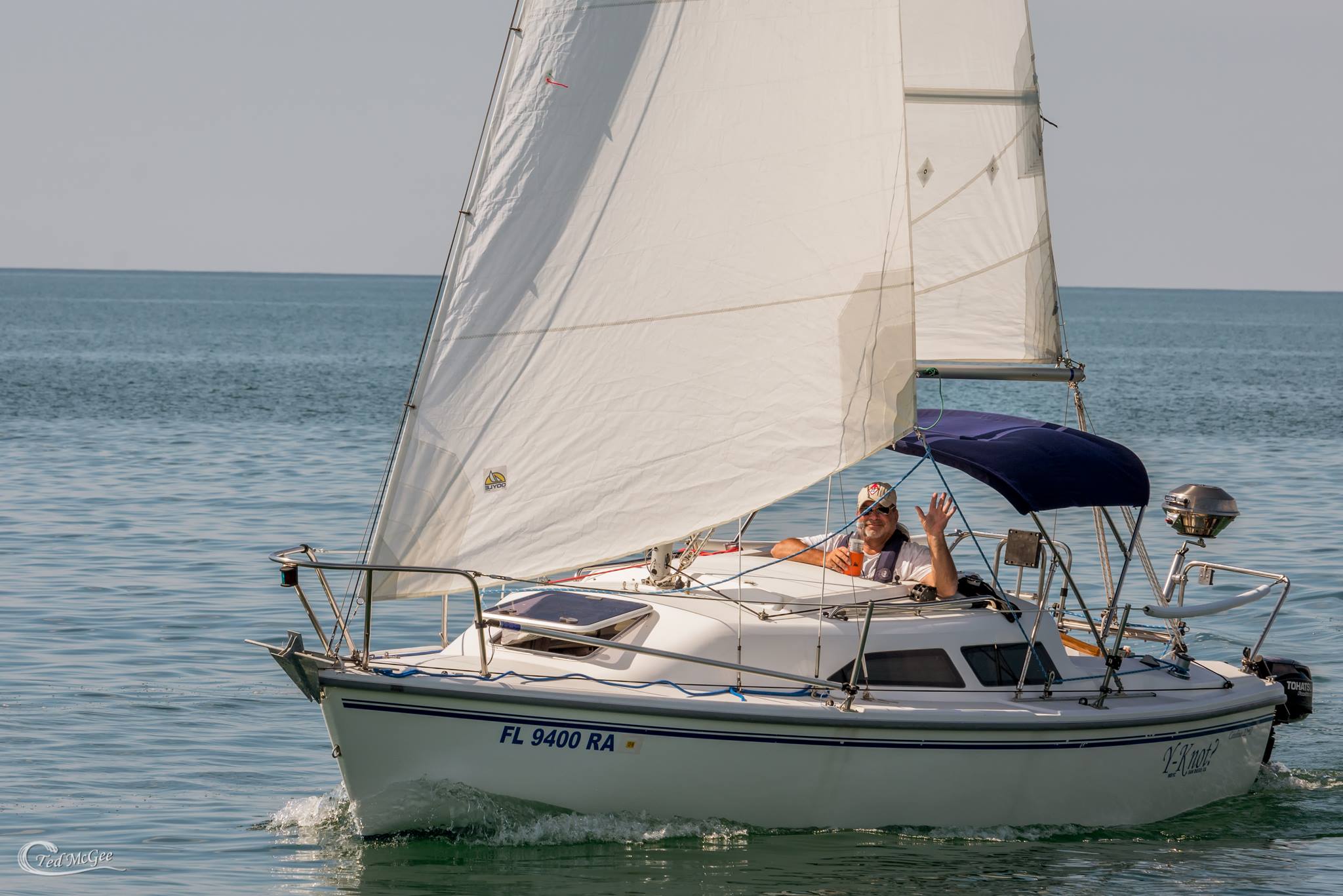

Here are a couple photos taken recently during the C-22 Fall Cruise. Due to the lack of wind, we're motor-sailing along nicely making 5.5 - 6 knots out on the Gulf. I'm at my usual station with the boat on autopilot, (but with my handy-dandy wireless remote for the autopilot around my neck). With the outboard secured, we're just enjoying a beautiful calm day out on the Gulf.

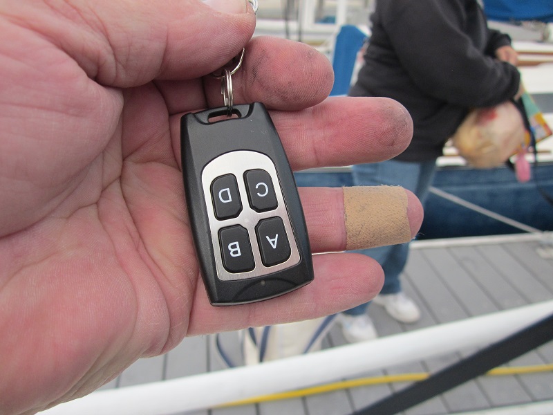

Which autopilot has a remote? I am curious now. That sounds pretty sweet! Do I see your anchor road ran back to the cockpit? Or is that a downhaul for the headsail?

I've had experience with both the Raymarine ST1000 and the ST2000. Both are more than capable of normally steering the boat, however, I found the ST1000 was too slow to maintain the boat on course in a following sea condition, and the autopilot would be slamming lock to lock and the boat was quickly out of control. The ST2000 is roughly twice as fast, and maintains the boat on course regardless of sea state that we've experienced. The wireless remote was from a guy down in Argentina that sells them on eBay. At around $400 for the Raymarine wireless remote, I could live without one, (maybe), but I bought the one off eBay for $125. over 4 years ago and it's worked very well. It's really spoiled me, and I can't imagine sailing without one anymore. This allows me to turn the boat into the wind while I'm on the cabin top and pull the main down. We enjoy long distance runs, and not having to man the tiller just makes the journey much more enjoyable. I've gotten so spoiled that with the exception of the first couple hundred yards after getting underway, of making our final approach into the slip, or anchorage, 95% of the time we're on autopilot. Any of the Raymarine autopilots can be used with a remote, it's all about interfacing I guess with their "sea-talk" network.
