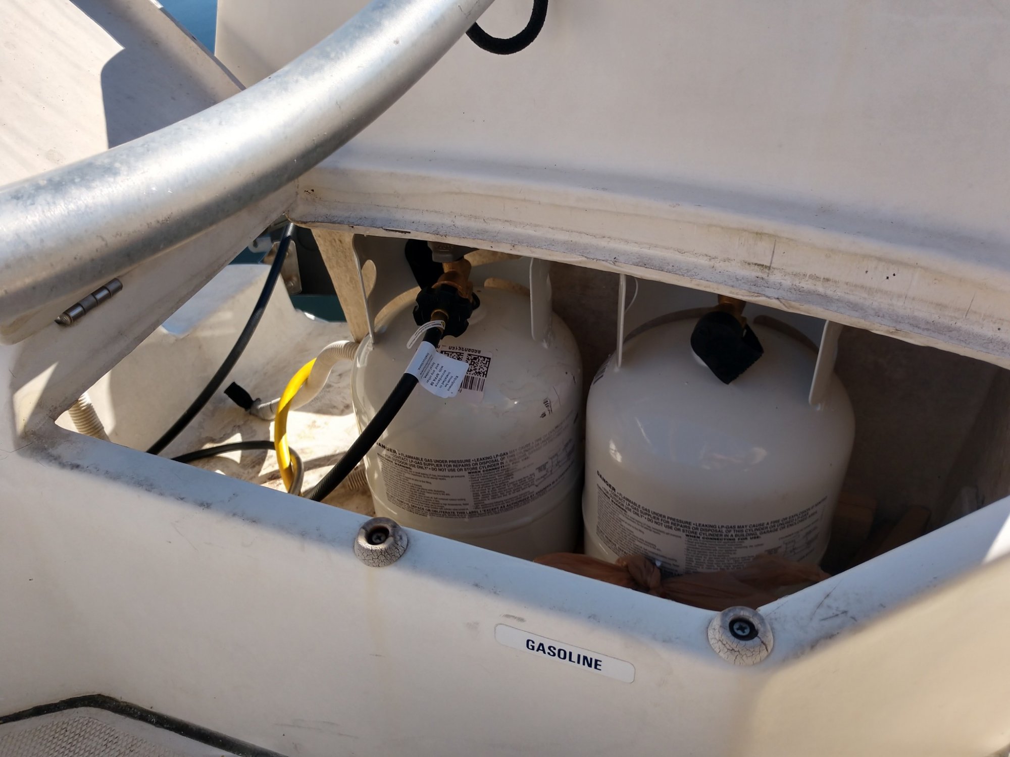

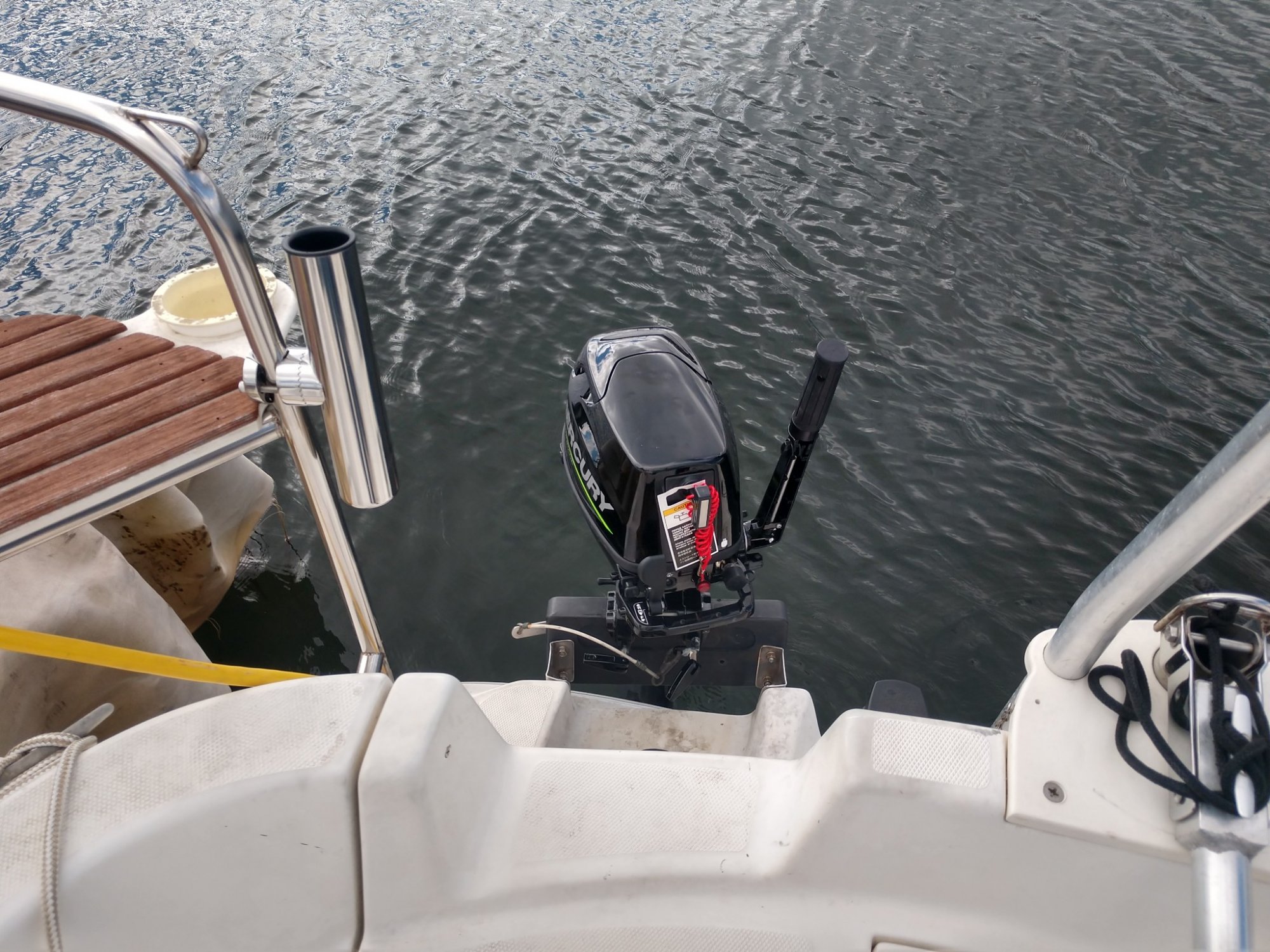

I have had my Mercury Propane Sailpro for about a year and a half. I have noticed that if I sail once or more a week (required to motor out of the harbor) it starts fine (five pulls). If I go longer, it takes as many as 10 to 15 pulls. I wiggle the shifter to make sure the neutral switch is made but it acts like it just wants a little attention before it fires up. It is quite easy to pull compared to my old Honda 8 hp. It has never failed to start. I will start referring to her as she.
I have a '98 Hunter 240.
