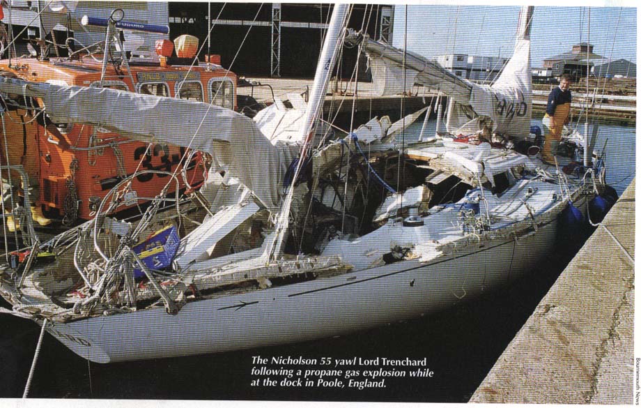

Very unfair and skewed way to look at it... A single article from years ago! It's not like you hear about boats blowing up every week due to gas explosions!

Ay, Ay looking for disaster to happen. It only takes one time for something to go wrong and KABUM!! Read up on the properties and dangers of propane. At the very least store up on deck until you can install a proper enclosure.

ABYC as propane venting rules for a reason. some marinas will not rent you a slip if they know your home install gas or propane does not meet ABYC. I might be extra worried about explosive fumes and the like because my home port is the marina where a bad gasoline fuel system cross connection leaked fumes in a boat with inoperable bilge blowers, and the boat blew up at the gas dock right across from my slip.
