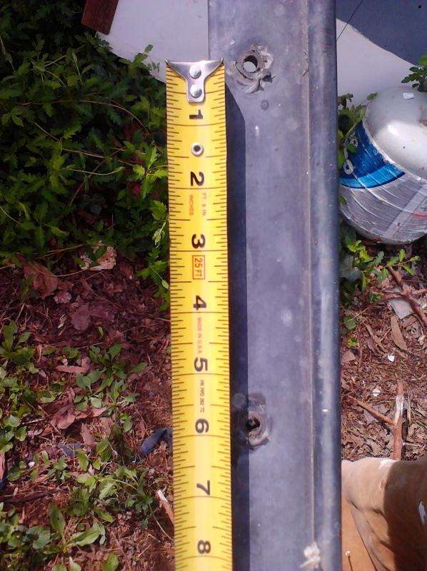

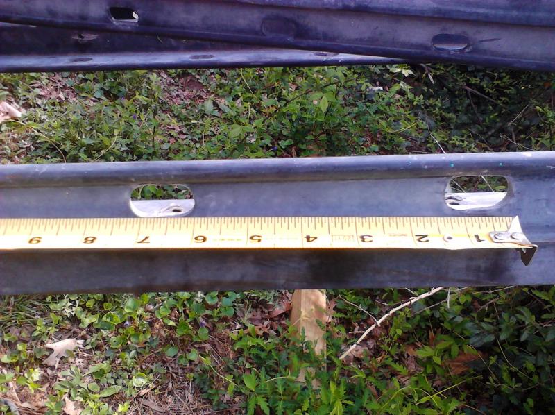

Sure, being as you have you hands full with engine problems and you are a fellow Cherubini enthusiast I'd only want you to cover the shipping expense. Hell these boats are getting old and replacement parts are expensive (just spent 85 bucks on gasket material for my deck hatches). And Jorge offered me some of his spares so I'm more than happy to help ya out. I think the cheapest way to ship would be folded up in a giant home made "envelope" of cardboard maybe a few layers thick and sent either snail mail or ups ground. both toenails are sitting against the back fence of the yard still, I am planning on cutting them in half to transport home does anybody else want dibs on a full length before I do? also is this a project in your very near future? if so ill move it up on my to-do list
Oct 25, 2011
115
Hunter 1980 H33-C Annapolis
it appears to be the same, maybe the spacing of the holes is slightly different but i won't know till i get them back home. I will compare to the specs listed and report back

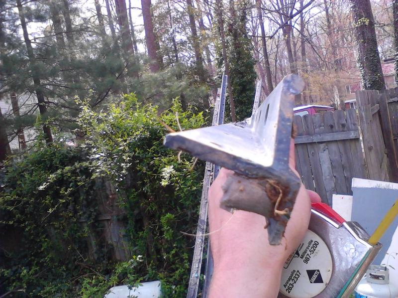

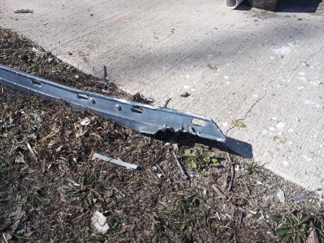

Ok guys me and my buddy have been working on fixing up a 78 H-25 that is in bad need of a port toe rail. It was chewed up bad when another boat came loose from its mooring in a storm and started banging away on the port side of are boat. We have looked into Crest but it would cost more than are whole boat so we decided to live with it.
Redbeard33 if you are looking to get rid of that stuff and have any left after rblevens gets what he needs my buddy and I would be interested. Pictures look identical to what we have with wholes 6'' on center.
We are in Chicago so anywhere in IL and we could pick it up and chip in on expenses with RB as is looks like you are in IL as well. Let me know if theres a chance.
