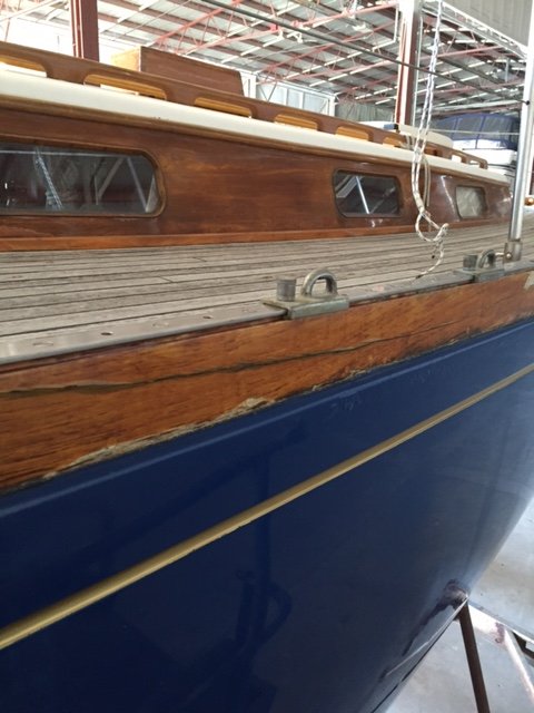

today the yard called to say there is a 2 foot smile crack in the toe rail under the stainless track for the genoa block cars.
so. my question for you all is, the screws/ bolts ? that hold the track to the toe rail for the track and the screws/ bolts that hold the toe rail to the vessel. how are all these parts put together? screws? bolts? is the strenghth in the wood of the toe rail or is it all bolt through to underneath? i know there are bung caps to horizontal screw along the bottom of the toe rail. i have access to palmer johnson carpenters. i understand west system epoxy usage very well. but i am still in toledo for 7 more days.
can anyone explain how the toe rail is attached? and how the stainless track is secured ?
the crack is from weathering and or age. not from hitting or stressing if you will

the inspection of the toe rail / genoa track shows that everything is through bolted verticly. there is access to the nuts and they are not corroded. love fresh water. lift track, make repair, reinstall track, go sailing. love old boats.
