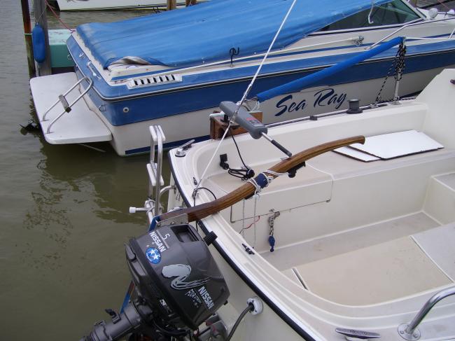

I grew up with 2 stroke Johnsons, Evinrudes and Mercury outboards. But my experience with these new 4-stroks 5 HP has not been exactly pleasant.
My new to me 222 O'Day came with an almost new Nissan 4-stroke outboard that was made by Tohatsu. They also make the Mercury 4-5 & 6 Hp motors too. Previous owner only used the motor about four times the prior season when he bought it new. During my first season I could never get it to idle smoothly. Adding SEAFOAM FUEL CLEANER helped but it still was threatening to stall out when docking the boat. Last winter I decided to bite the bullet, Ordered the carb kit new fuel pump, fuel filter. thermostate and changed out the fresh water impeller. This year it has been working perfectly untill three weeks ago. It stopped dead coming into the channel (with rip rap and hugh boulders) lined on both sides. Not a good place to quit !! Good thing the wind was blowing straight dow the channel from aft as we were able to drift over to the gas dock. There I tried to start the motor. It took many tries and after taking out the fuel filter and blowing backwards through it I could get the motor to run. Now it would die when I put it in gear. After running in neutral it finally would run if I didn't give it to much throttle.
Well I figure the carb is again dirty. So again I cleaned the carb, the gas tank and put in a second fuel filter at the gas tank. Put the motor on the bgoat and ran it fine at the dock, then decided to put it in gear and at an idel it ran good ,but when I gave it more throttle ( very fast idel ) after 10 minuets it stopped dead just like it did in the channel.
Took the motor to a local outboard repair service shop who said dirt in the fuel and carb told them I cleaned both carb and tank. $80.00 later I get it back on the boat and sure enough it ran 10 minuets and quit. The shop said it ran an hour no problem and that there was dirt in the carb and needed an adjustment. Took it to a second shop thinking it would be an ignition part that breaks down under heat or a load. But this shop also says a fuel problem after a week I get a call saying he does not understand this issue and that he has given up. Everything checks out fine, fuel system ignition, and it should run. I did not fix the problem therefore no Charge.
I have now found a Nissan dealer about 40 miles away and will be taking it there. hind sight easier than forsight huh.
I just wonder if anyone with a 4-5 or 6 HP Tohatsu, Nissan or Mercury has had issues like me? Wish we could still buy the 2 stroke engines.
