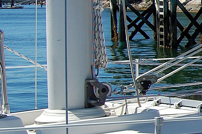

I know Brion Toss does not like them.. Toss generally uses stainless rivets in high load areas or fine threaded machine screws if the wall thickness is there. He generally prefers aluminum rivets in low loaded areas and Riv-Nut's he'll use too.
This mast base turning block is now 32 years old with well over 70k nm under the keel, heck the PO's did nearly 50k during a five years cruise, they are installed with rivets, but not aluminum. Toss also recommends using Tef-Gel to isolate the stainless rivet & aluminum spar. Monel rivets work too and tend to be easier to drill out.
