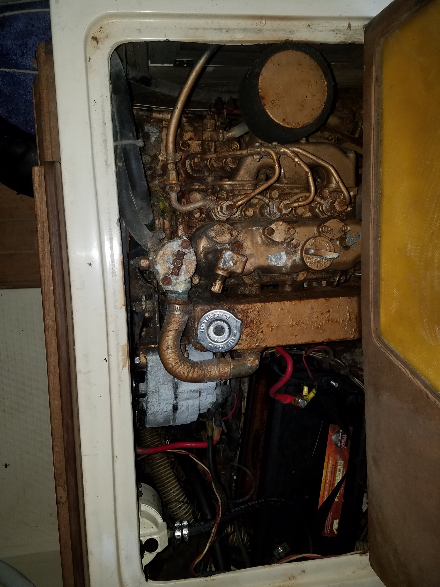

I have the engine removed from my boat. One of the things I am doing while it is out is sanding it down and painting it. I have already made good progress on sanding off the paint with a dremel and an 80 grit abrasive wheel. Believe it or not, but all of the rust in the picture comes right off with the paint and the condition of the metal is in remarkably good shape. Even the top of the exhaust manifold/coolant fill on the port side of the engine cleaned up beautifully.
I have purchased a couple cans of the original bronze universal/westerbeke spray paint shown here Engine Paint for Universal Diesels, Bronze my question is; After I finish sanding and wiping down the engine, can I just spray a couple coats of this on and call it a day or is there a specific type of primer made for engine paint that I need to use first?
