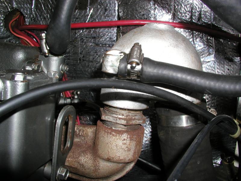

10,253
Richard, the only part that gets hot enough to damage the wires is the (usually) rusty part that goes aft of the cylinder head and the exhaust elbow. It is about 6" long and 2" wide. In this picture, it is the kinda silvery/rusty part, just below center of the picture. The rest of the exhaust (elbow, cylinder head, rubber hose) is water cooled and will not be above 120F if the water is flowing. If the wires aren't touching the silvery rusty part,and are more than a couple or three inches away, they are fine.
Aug 16, 2009
1,000
Hunter 1986 H31 California Yacht Marina, Chula Vista, CA
Thanks. I guess I was just being paranoid as I certainly have a few inches of clearance.
