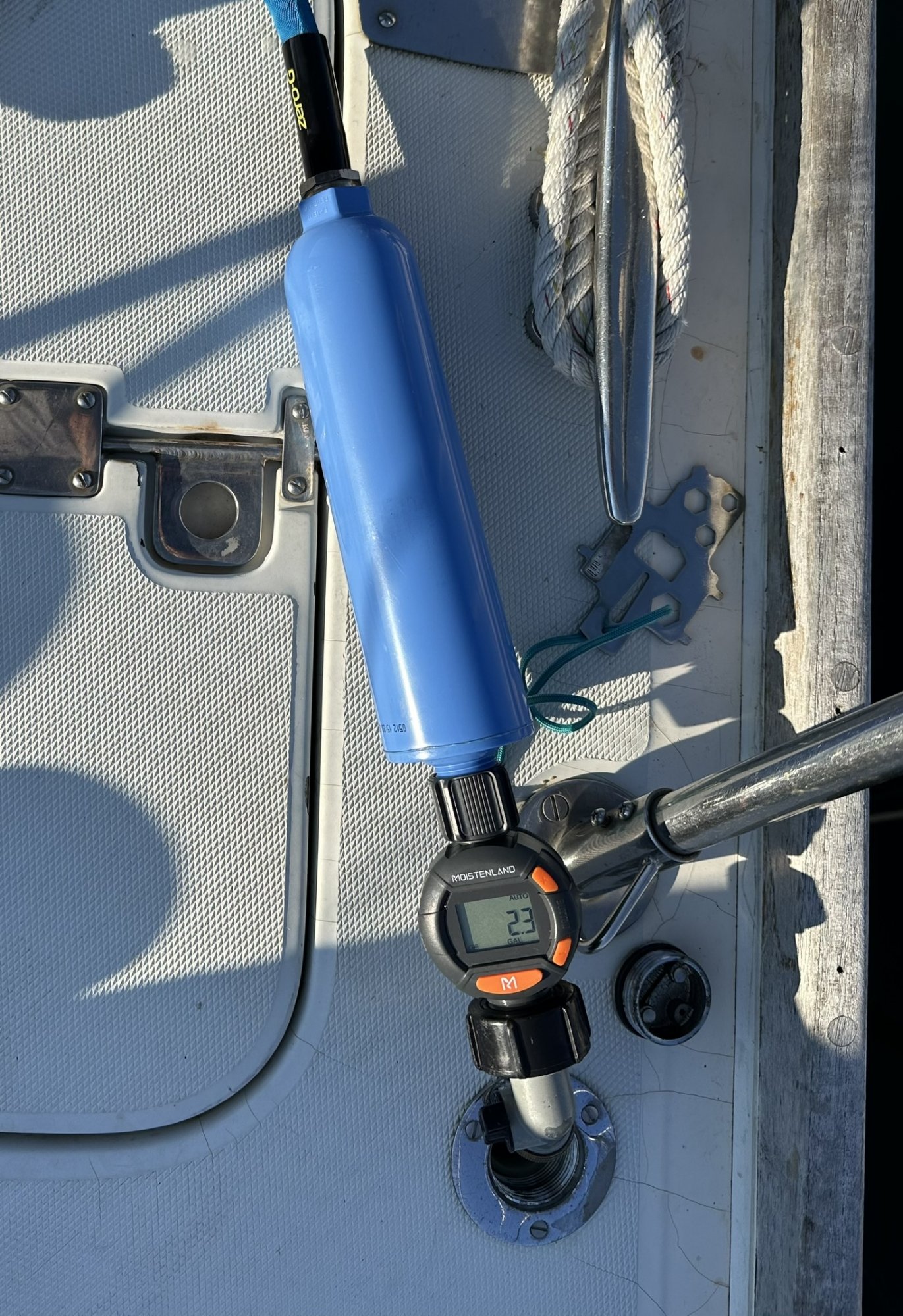

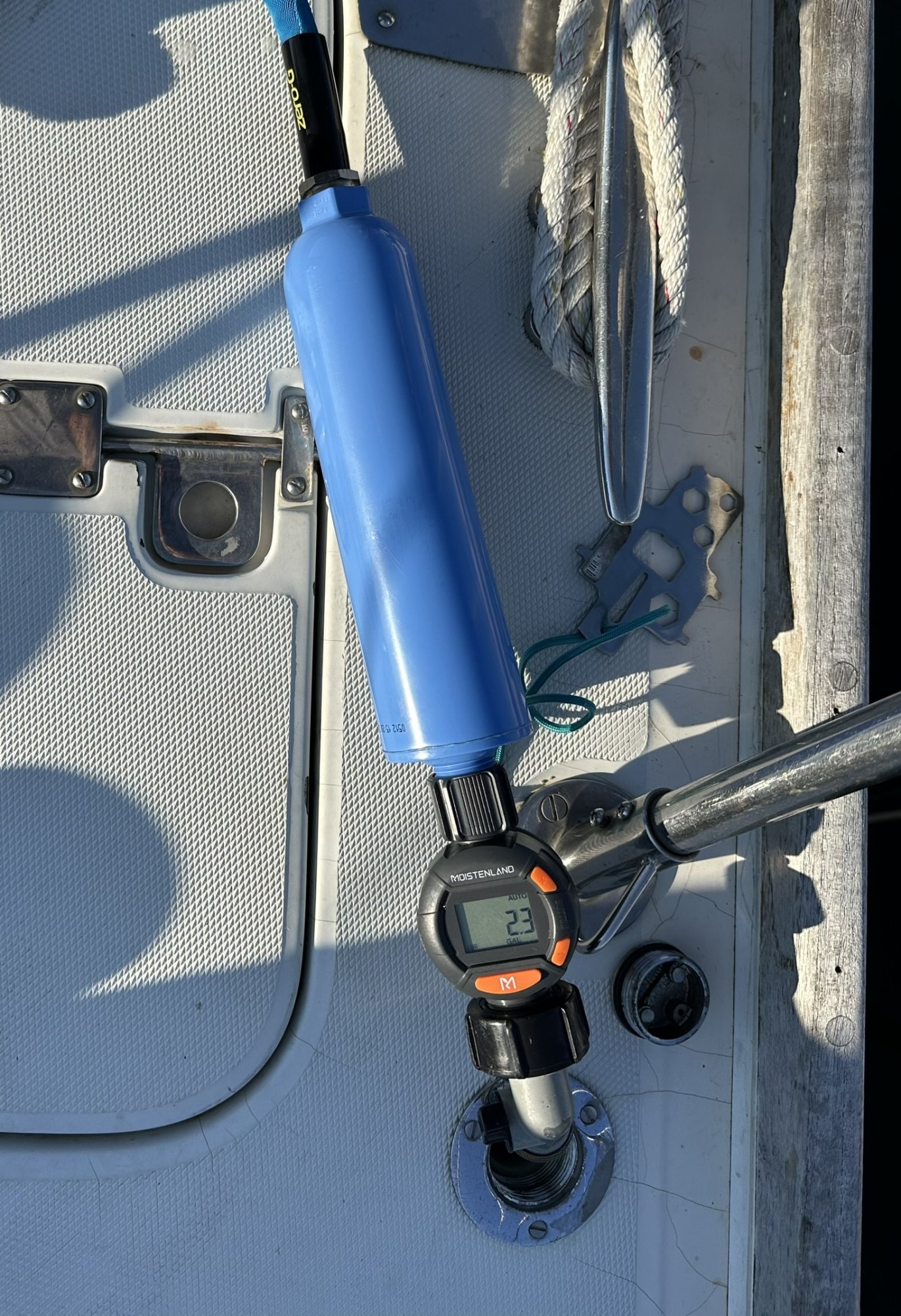

That's why we invested $20 in a flow meter. No over flowing tanks and no water flying out of the inlet.
Well worth it for $20!
