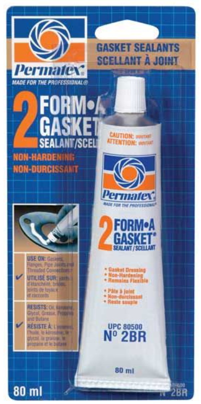

If it's the same inspection port as my potable water tank and holding tanks are (were) the only thing in the universe that will stick to poly, bend and flex without losing the adhesion is Permatex #2 :
The Hunter factory used 4200 or 5200 on the outer ring and it wasn't even in contact with the poly when the screws were removed.
Of course you'd be a complete fool to believe what I say on some far flung boating site so buy some (a few bucks) and smear a blob on the exterior of your poly tank and see what luck you have in trying to remove it after a day or so. Impossible. It never hardens. The only thing that removes Permatex #2 is any form of alcohol. Use Permatex to seal the outer ring to the tank, not the "O" ring under the cap.
As far as the large "O" ring in the port goes, let's see what shape it's in when you remove it.

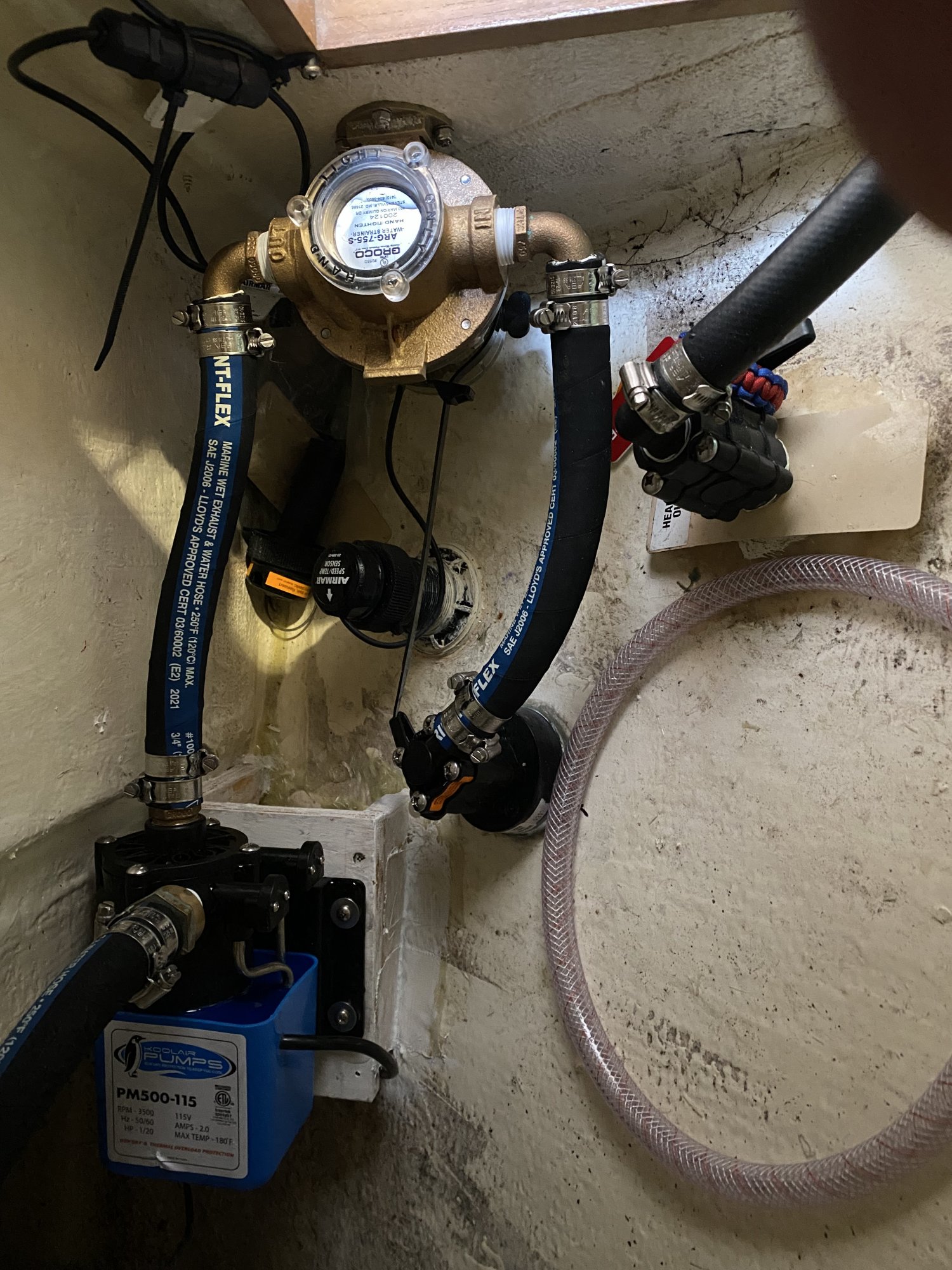

Interesting that my 93 MkII C30 does have a drain hole in front of the v-berth water tank. It's right in front of the shut off valve. It drains into the bilge by going beneath the tank pan and to the port side where the head water intake is. There is a limber hole in the inside corner of the head forward bulkhead where it goes towards the boat center.
It's to the left of and under the water strainer in this photo. The hatch over the water strainer is the one in the forward bulkhead of the head.

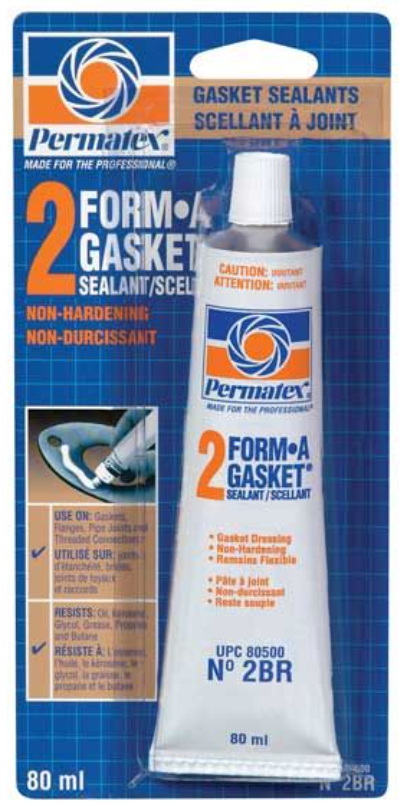

The factory used some sort of sealant that looks like it's done an excellent job of holding the fittings in over the years. THe inspection port is likely just threaded into the plastic

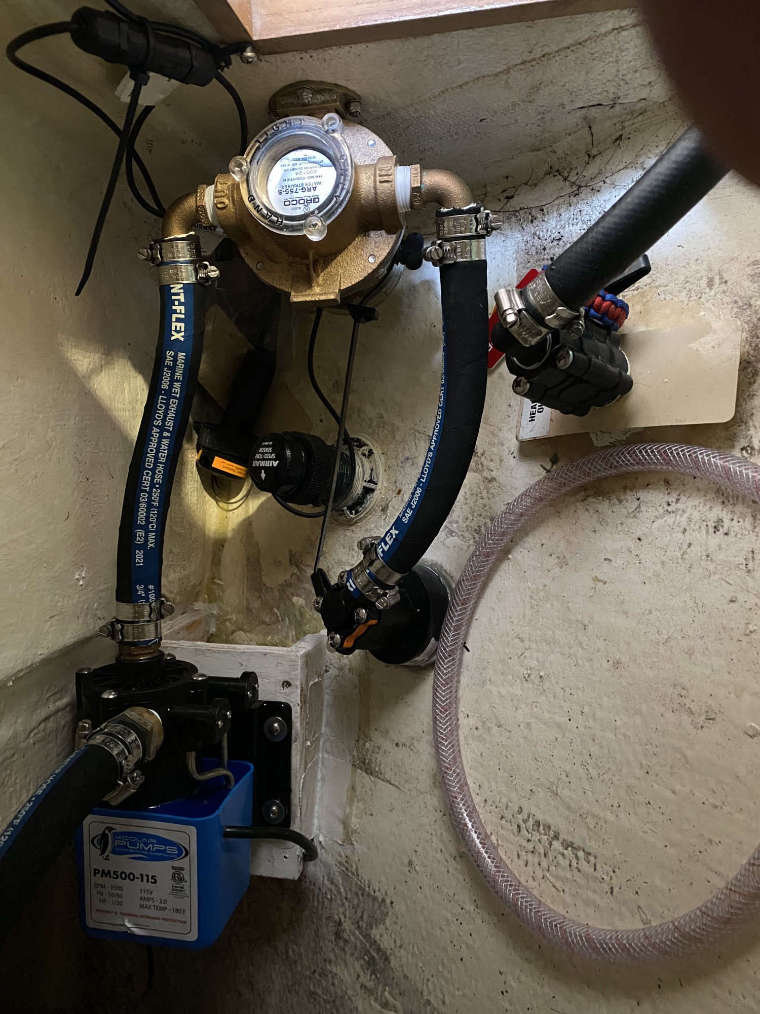

I havent inspected the forward part of the compartment. My output and valve are on the aft end of the tank. I'll take a peek at it tomorrow

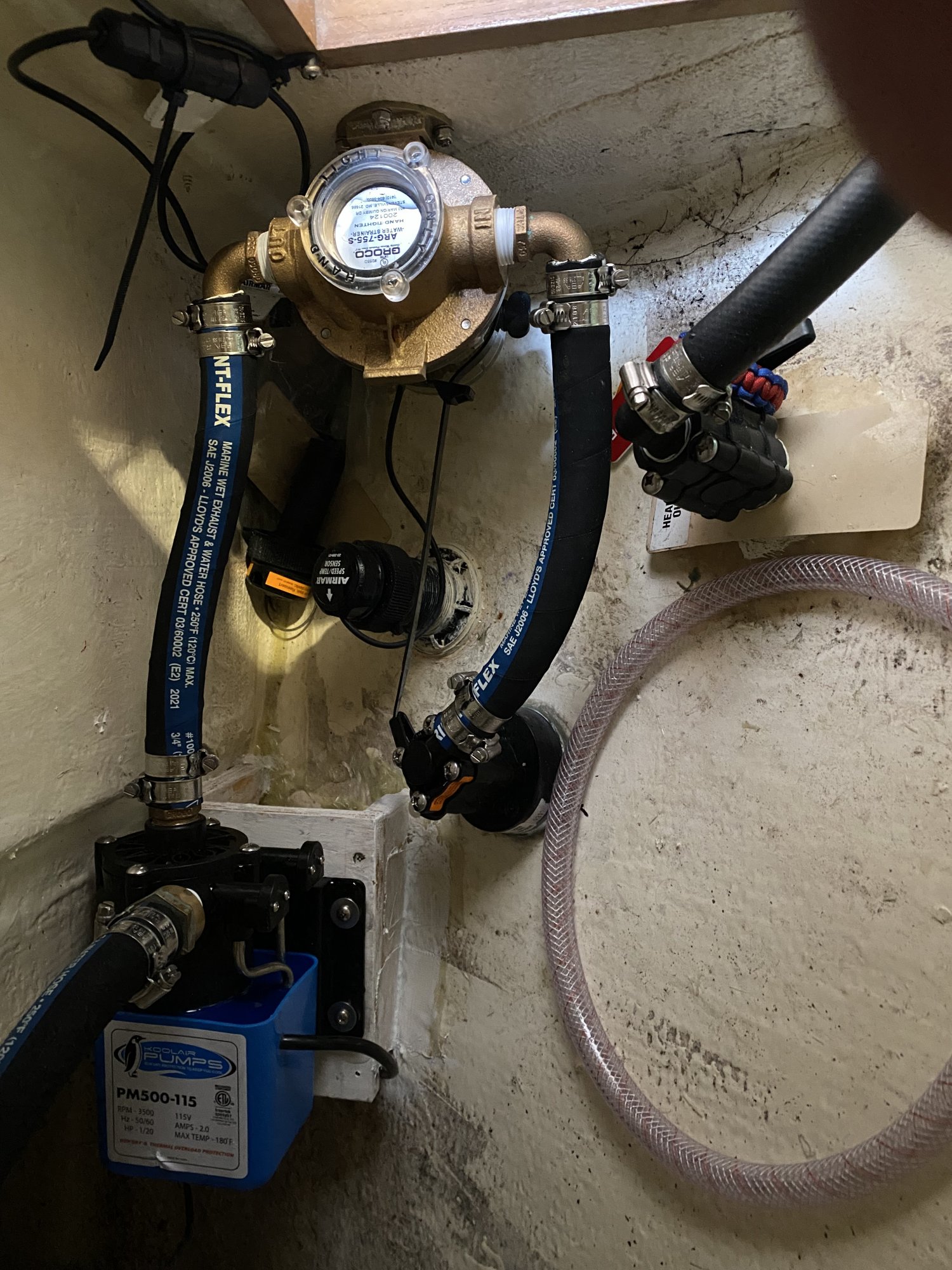

The drain is at the aft end of the tank under the output valve and 90deg elbow.
Maybe they forgot to drill it on your boat? Or maybe a PO drilled it for the same reason you're thinking of.
